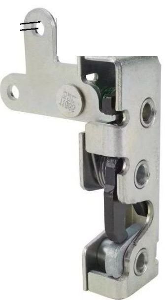

ok...here we are. I've got the latch installed in the door and the latch release hardware (door ****) fitted up where it works properly.
but now I found that the teeth on the shaft are buggered up badly and the handle won't fit on the shaft.
I've ordered a replacement shaft from Carpenter and "he" says to just press the old one out and install the new one with
a pin holding it in place.
I've tried driving the shaft out of the mount with a drift and hammer but nothing is moving...and I'm wondering what is going
to fly apart inside the assembly when I remove the shaft (if I get it out) Could use some expert advise here on removing\replacing the shaft
pictures for your viewing pleasure

and I mounted my latches with the pull lever on top. Is that right ??

not going to say it is right or wrong but that is not how I did mine but I also had to modify mine to make it work.
The instructions show the side of the latch with 2 mounting holes on the bottom?
Obviously yours has been working, I have no idea.
I remember when I Installed mine I could not figure out why there was not a place to attach the solenoid cable to and I ended up welding on a place
https://cdn.shopify.com/s/files/1/00...f?v=1724766585

You used the Altman kit like I did on my last two builds. John did the same as I did on my first build and just bought bear claw latches and why there is a difference..
https://jniolon.classicpickup.com/be...awlatches.html

I still really wonder how Altman expects you to attach a solenoid cable or rod to the latches the way they are configured in the kit. I actually bought the kit that was made just for shaved door handles, it was slightly cheaper because it did not include a outside handle lever.
I see how when you guys just had latches and no kit you installed them the way that you did because that is the only way a solenoid cable would work with mods.
