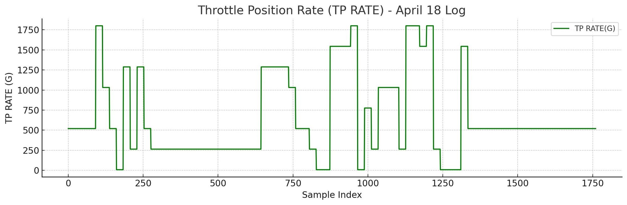

Cold or hot it happens
it seems like the fuel is being cut off.
how about TP rate i dont know how to interpret that reading. seems weird to me. its like i have a dead pedal under this event
I have a screen record i will attach. bottom righ is rpm see what you think. tp rate seems weird to me

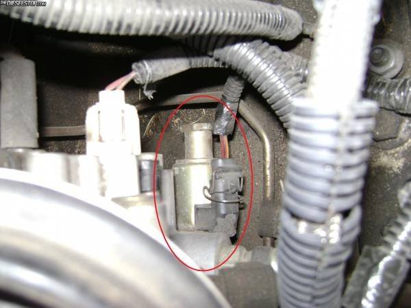

PCM is tweaking fuel pulse width desperately to correct for the ICP/HPO fluctuations.
Pull the wire to the ICP. If there is oil in there the ICP sensor needs replacing.
Also could be failing IPR solenoid. Easy enough to pull off the solenoid and test/inspect. When looking there be sure the tin nut holding it is secure. Ohms should be 10.5 or so. Clean it up and post pics of both sides. I've seen a few failures where the sides sucked in/melted.
