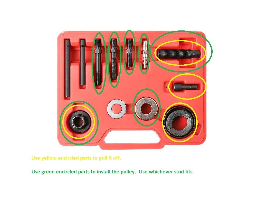

See if this helps.

Originally Posted by kr98664
Yep, just like that. This video shows the removal and installation process with the Lisle kit:
https://www.youtube.com/watch?v=-ag2L8PIekM
Ok, I call that pressing it on. Thanks for the clarification.
I will clarify this which I didn't do in my first post, DO NOT use a shop press to push the pulley on. Use the tool.
