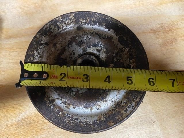

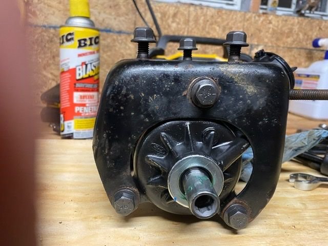

I couldn’t wait until the morning, this is keeping me up nights. Pic of the ps pump and pulley that came off the old pump

The pump in your pic is a Ford CII pump, used for many many years in cars and trucks. The part # varies by length of filler neck, etc. Rock Auto lists it as one of the pumps used on your truck. The other is the Saginaw pump which has a steel reservoir and a long thin filler neck, with a dipstick like a short engine oil dipstick. If you had a serpentine belt setup (yeah, not there in 1979), you would have no trouble finding a pulley. My guess is that there were relatively few vehicles using the CII pump with a V-belt drive, as compared to millions of CII pumps with serpentine belt drive pulley on them.
The proper puller to remove the pulley slips over the front "disc" on the pulley that projects outward, then a forcing screw goes down into the center of the pump shaft and pushes relative to that pulley disc, and the pulley comes off without damage. Auto parts stores, at least they used to, had the pulley remover so they could sell pumps to people. You would bring your pump attached to bracket with pulley on, into the store, they'd pull it off for you. The new or rebuilt pump usually came with a cheap tool to press the pulley back on. Needed to wrap a piece of old belt around the pulley and clamp belt in vise so pulley wouldn't turn when re-installing pulley onto pump shaft.
