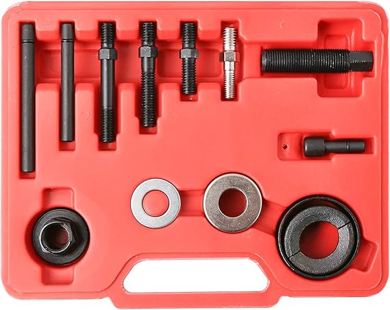

You can't press the pulley on and off, it will damage the pump. You cannot sell a new pump with a pulley, the pulley must come off to install the pump. If you get one from the junkyard, you will have to take the brackets with you, they will be stuck on the pump.
All this will go much more smoothly if you get the correct pulley removal tool. Like this.
Amazon Amazon
Why do none of the OEM's make a bracket with a slot in it to remove the pump AND the pulley? That is the million dollar question.

Dave F, I see that puller has this info, it's for GM's and some Chryslers. There are other kits...
Do you know if that one works on these old Fords ? Looking at that puller set above, maybe the tow half collets have a cap under them, that also holds that flange nut under it and use that thick stud in the upper right to back the pulley off.
Or would something like this style work better ? Seems it has two collet halves that fit in the grove on the retainer

I bet you tried to use a 3 jaw puller on the outside of the pully?
The puller you need works off the center hub and pulls on it.
It also has been posted there the HF puller is not machined right, needs a sharp edge to grab the hub, and it is rounded and slips off the hub.
Yes, that was my experience. I learned the hard way that the HF puller did not work very well. Normally their stuff is fine, but not this model.
The problem is with the two pieces that grip the pulley. They were raw castings, not machined pieces. They fit sloppily inside the collar that is supposed to clamp them together onto the pulley. There was just too much play and they did not lock on very well at all. The actual pulling surface (the edge of the groove) needed to be flat, but it was still slightly tapered, which forced the two pieces apart as pressure was applied.
I ended up returning the HF puller and went with a Lisle 39000 instead. It was only $47 on Amazon, and the difference was night and day. Instead of a loose collar to hold the two pieces together, this had a different arrangement with bolts:
https://www.lislecorp.com/specialty-...-pulley-puller
https://www.amazon.com/WINTOOLS-Remo...35177898&psc=1
If you can't press the pulley on and off then how do you move the pulley to your new pump? Obviously use the correct puller to remove the pulley. Then to put it on your new PS pump how is that done without pressing it on? I get that you can't press against the pump itself as damage may occur but what's the trick to get it on the arbor?
I believe there are threads in the center of the pump shaft. Basically you screw one of those double ended bolts into those threads and use the piece that fits over the end of the pulley and then use that piece with long threads to screw over the other end of that double ended bolt. Then use the big nut in the kit to force the pulley on. Something like that. Just follow the directions that come with the kit.
Old May 6, 2025 | 02:50 PM
kr98664's Avatar
kr98664
Joined: Nov 2013
Posts: 7,178
Likes: 1,174
Yep, just like that. This video shows the removal and installation process with the Lisle kit:
