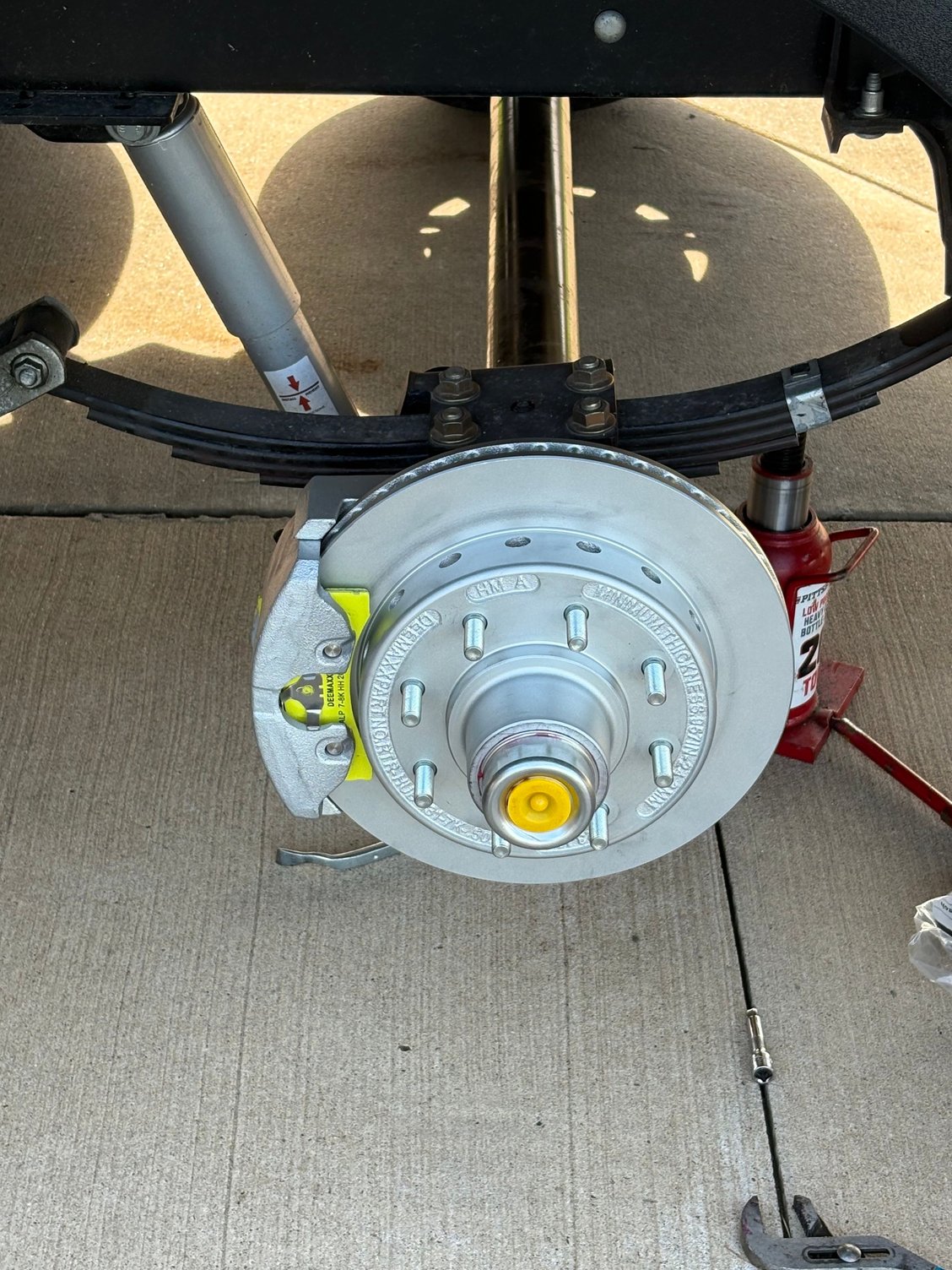

Ordered the DeeMaxx kit from etrailer. Should be here Tuesday and hopefully I can immediately start working on the install.

Weather finally cooperated and I got one side installed today. Straightforward install so far. Everything bolts right up like it should.

Finished it all up today. They work great now. Night and day difference between the two.
