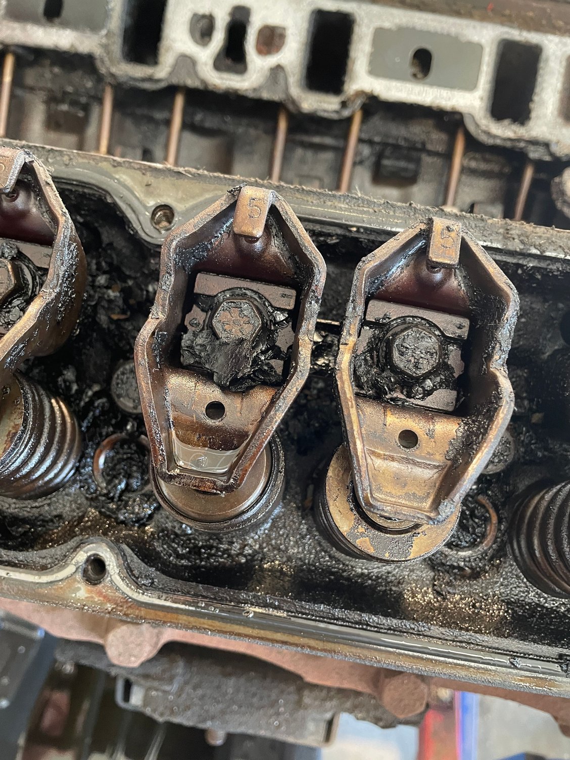

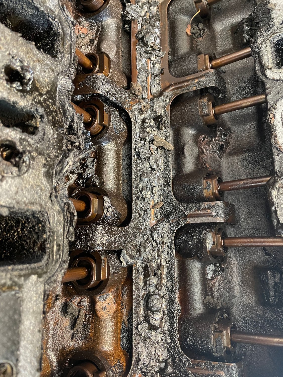

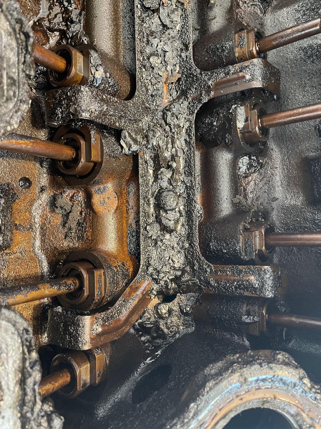

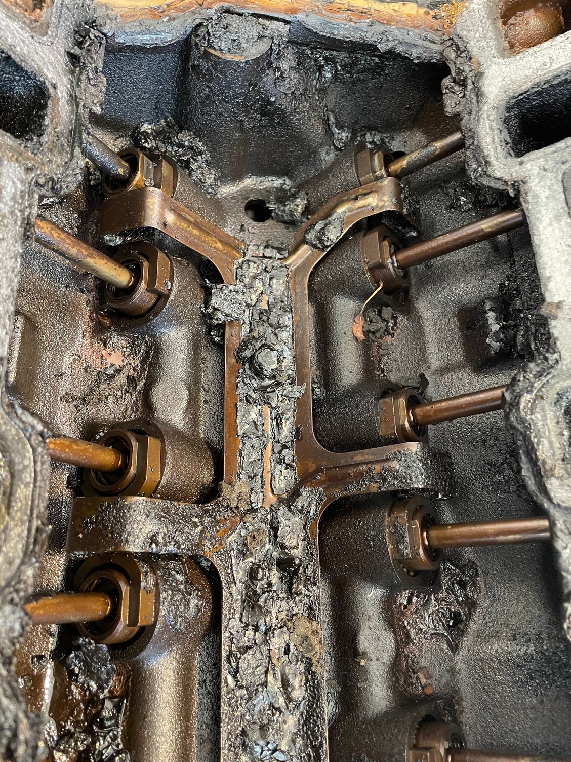

We recently swapped out the 302 in my friends 1993 F150. He is giving the old 302 to another friend to build for his mustang. He pulled the top end today and we were all shocked at what we saw inside. This is a 2 owner truck with 170k miles. We are guessing the first owner didn’t take the best care of it. My friend only had it for the last 30k miles. This engine was running and driving just fine when removed aside from leaking 8 quarts of oil per week.

Not good, but not the worst I ever seen of this era 5.0. Did valve cover gaskets on an 89ish Bronco. All you could see were the rockers, and the "channels" that the oil had cut to the drain holes in the heads. Shopvac and a screwdriver got the majority of it. I showed the owner and told him that if the heads are this bad, the valley and pan were probably similar or worse. He needed to have it stripped down and cleaned. If not the pump screen could get clogged and wreck the engine. No idea what happened after I gave it back though.

Looks like the typical "I never changed my oil. I just top it off when it gets low" engine.

That kinda looks like it had a bad decade, and then the next person was a lot
better about changes... it's odd how it's not evenly coating everything, but looks
like it's... precipitated... Or maybe someone did a couple of solvent flushes
a good while back, and that got a lot of the softer stuff out?
I've seen a lot of sludge, but that's more like coking that's broken loose.

Yeah, it kind of looks and smells like firewood ash.

seen many a lot worse in my dealer shop days. most of the time it was due to the cheap oil from carwash oil changes, and by cheap i mean the re-re done oil they buy for a buck a gallon for thier $29,99 changes

Wow... looks like someone had a camp fire in that thing
