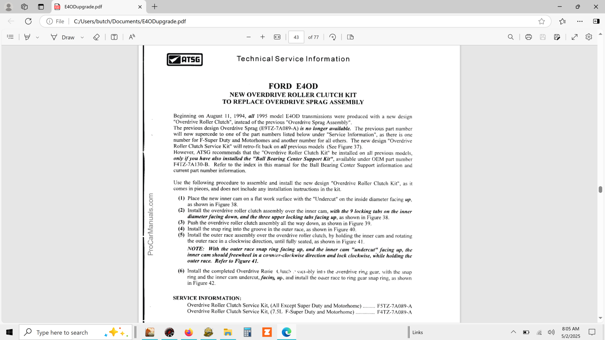

Looks like ATSG is claiming all '95+ E4OD's got an updated OD roller clutch kit. Am I missing where it's claiming RV's got the upgrade? It's even claiming all in bold. You guys may be correct. It's just the first I've heard of it, is all. Still, it's not yet known if the '91 spag assembly has failed after 500k miles anyway. What if the OD clutches are simply wore out? Could you even make the claim that a '95 E4OD will last more than the 500k miles the pre' '95 version did anyway?

Old May 2, 2025 | 07:27 PM
