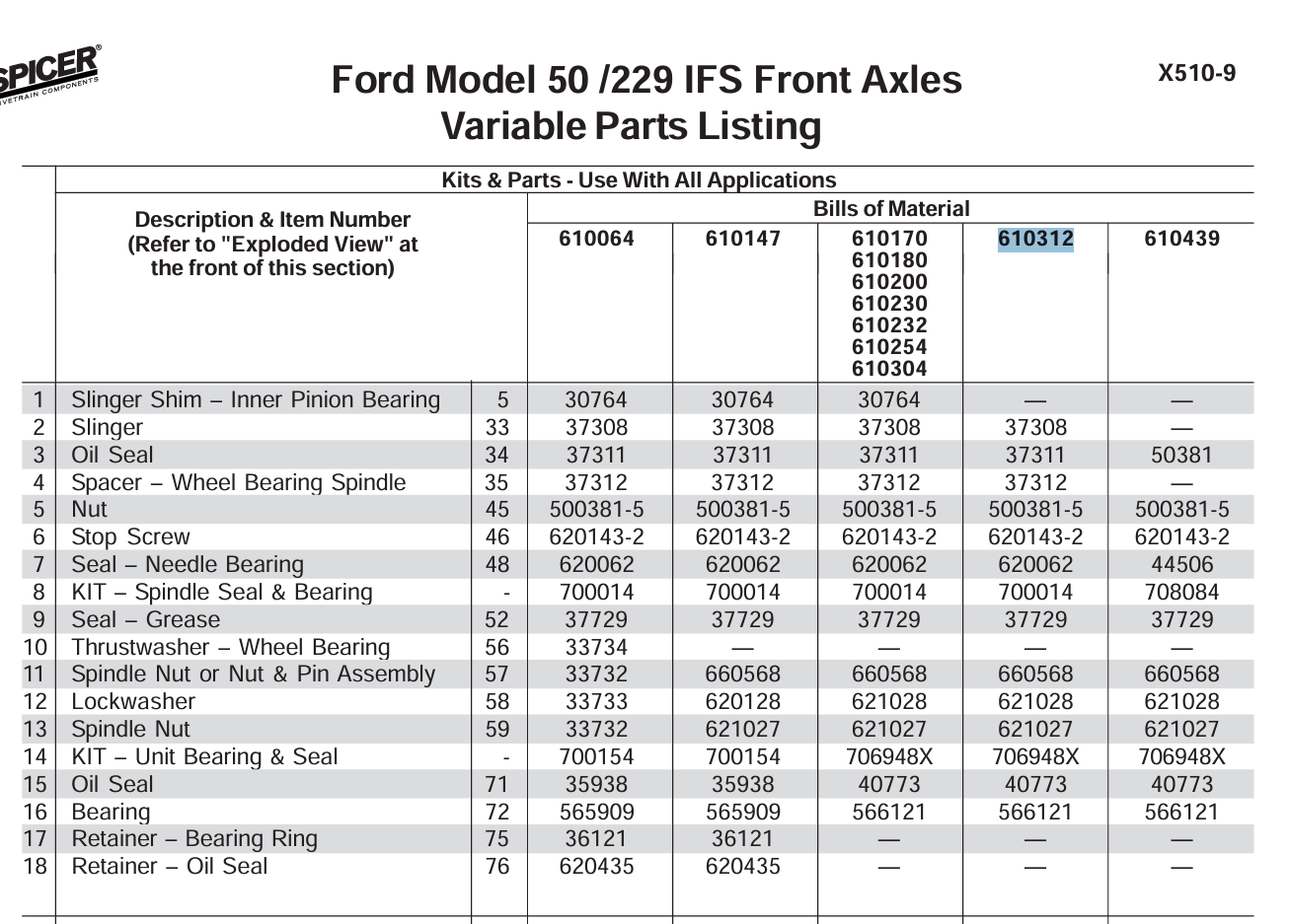

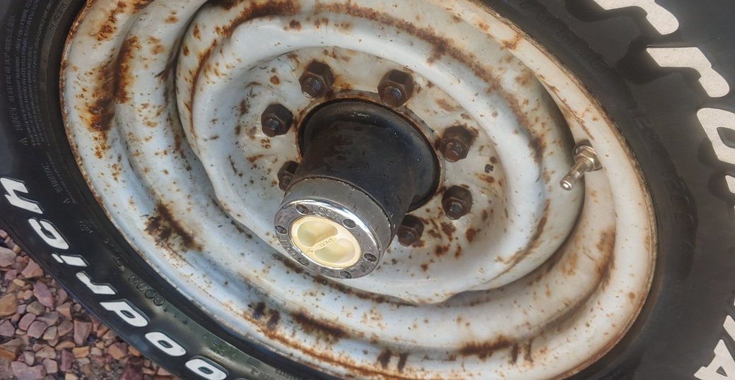

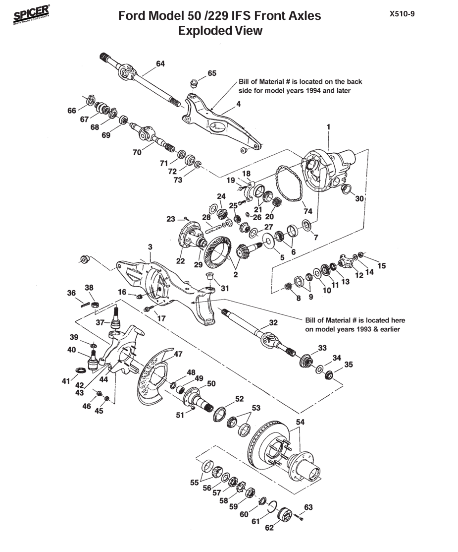

ive never heard them called that, but my only 4wd that old is a 3/4 ton and uses spicer (dana 44) front hub locker
are you talking about this stuff?
the heavier duty version yes. i have the weird dana 50 that ive heard called a 55 here and other places because of the larger rim center and diameter spindle among other things like the hubs just being different. its been a real issue finding stuff that actually fits it since its the odd one out just like the suburban i picked up (why its using ww2 jeep stuff i dont know but its all stamped with gm parts numbers so who knows)
im pretty much stuck finding another 4:10 heavy duty plus or whatever ford called it like i did last time for the bulk of the parts

You can run the transfer case in 4H or 4L and not lock the hubs. All that does is turn everything except you aren’t applying that power to the ground. You could also lock the hubs and leave the transfer case in 2H which spins/ freewheels everything in the front end which is what you would do when you will need 4wd often. I still find it very hard to believe that it got hot enough to boil the gear oil unless there wasn’t any or very little oil in the diff.
The hubs only need a very light coating of grease. If you put too much grease on the hubs then, yes, they will not lock and unlock like they are supposed to.

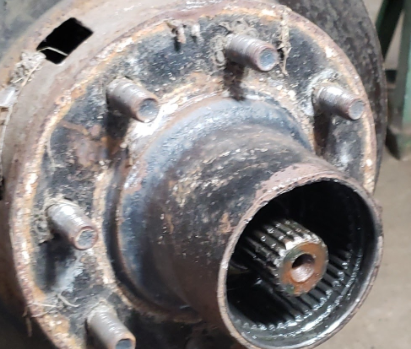

this explains alot. its a dana 60 spindle and components tacked onto the ifs according to the part number on the spindle and it looks exactly like the one on the 99 f250 hd thats sitting next to it.
weird that ive found more than one that are like this since it shouldn't be the same upright assembly but it is. so the spring behind the "slug" is missing ill have to find one that fits correctly since a spare dana 44 and dana 50 spring are both the wrong diameter for the spring pocket after trying to install it so i probably need to grab the one out of a dana 60 or 70 thats laying in the scrap yard.
this certainly explains the oversized brakes and f350 and bigger convertible calipers

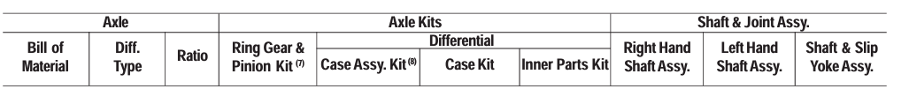

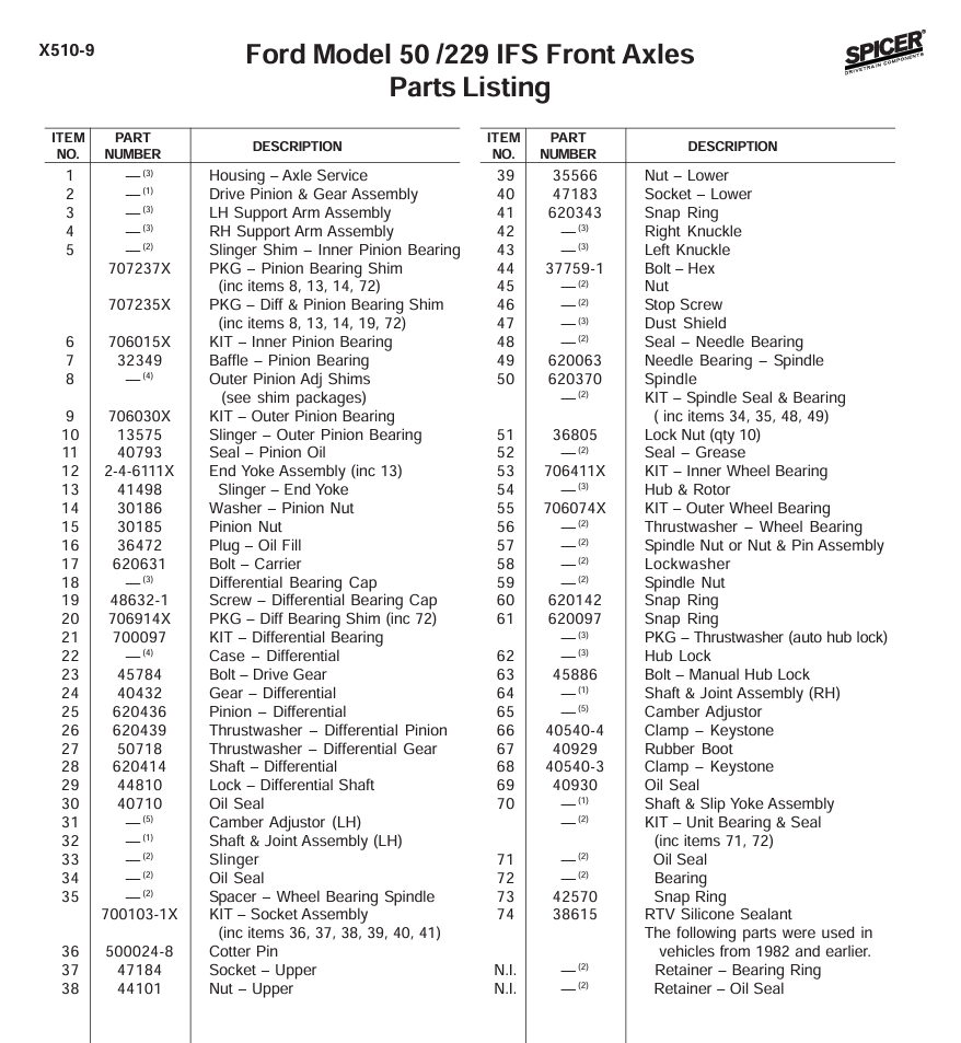

are you saying it does NOT Match the pictures above? Because there IS dana 50 information for 98.5 f series , but i assumed it was a Dana 50 from a 1991 F250. if its a newer axle I can get you the diagram for the newer deal, but if you got the LIST number off the housing you could speed up this considerably
Its litterally on every dana out there.
Theres also a number on the area around the diff cover in the front of the truck where it says the model of axle (44, 50, 60)
