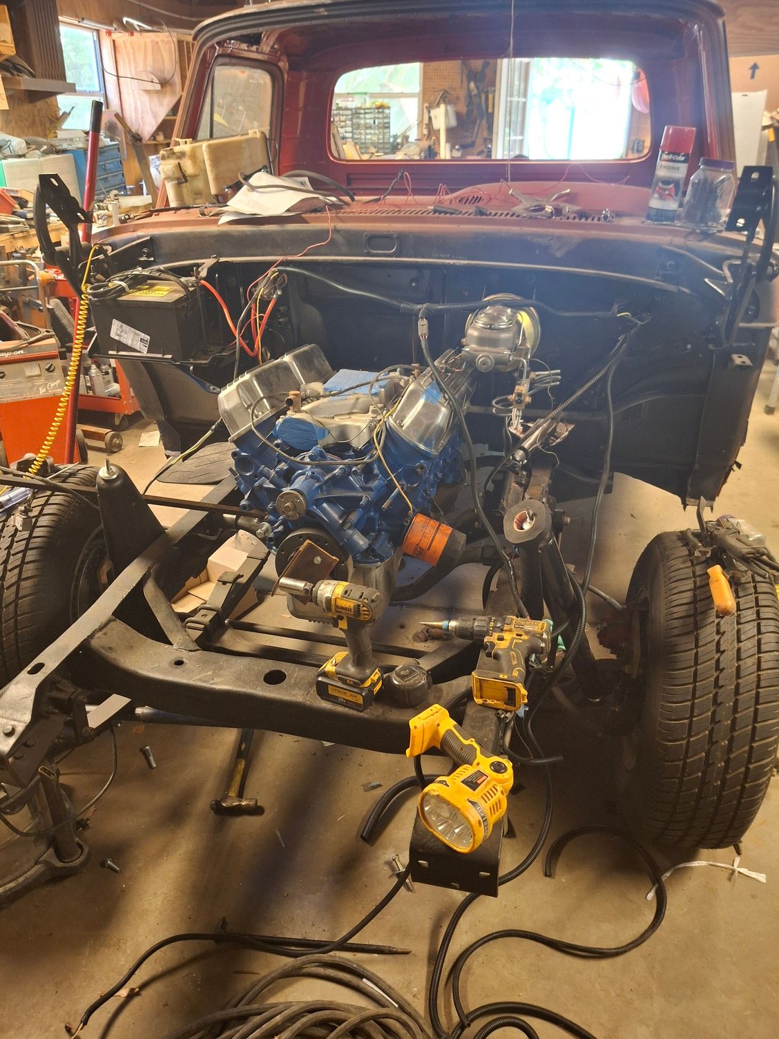

Ok I fessed up to Brian Morrison already he truly tried to help, but it was my own senior moment. Finally put wipers on back burner and have been out JY yarding got all the backets to put updated alternator and get my power steering pump a home. I used a 91 F150 for everything the alternator bracket and new alternator, the power steering I goofed it was a single mount for the PS so I thought hey? Well there were different thicknesses. Yay go figure so went back found another same year and had to get the whole stack a/c compressor and PS. I did find another there on a pulled motor a Ford it looked right BS got home cleaned up painted and not one hole would line up... So went back next day and got another 91 and had to disassemble the whole side to get what I needed. Finally back home and everything is soaking to clean and bead blast to paint. OH Yeah the other one on the motor outside it was a big block out of a one ton. Another senior moment. Now with the alternator bracket painted and alt. installed ( I even got the whole wire harness) all but in and wow something fit. Well thats when I figured my first real senior moment my wipers have worked all along I just didn't have power int the cab yet!!! What a klutz. Get stuff cleaned and mounted and snap some pics.

Finally got back up here to finish post. I am an old man 72 beginning to wonder but this keeps me busy. We finally got the entire wiper system up and running. In my foggy mine we had the entire harness even found a brand-new wiper motor that matched the mount. It was me I had not added a hot wire to the hook up by the motor to feed back to power everything. I was so humbled I quit for the day. Now working on interior harness the young guy, I bought truck from had taken entire harness out of cab he was going to go digital!!!! Anyway, I found a guy parting out a 62 unibody like mine and I talked and purchased the entire cab interior wires. radio steering column (not needed) so last few days has been mounting, separating, just basic clean up. Have everything pretty read to go but have some off on left that aren't connected. Trying to find a good wire diagram I have some out of the books and took to local published and he actually blew the up to poster size. Yah Hoo I can see with out my spectacles

I CAN FINALY POST THAT THE WIPER S ARE A DONE DEAL, THY INTERMIT FAST AND SLOW AND PARK THAT HORSE IS DEAD. Know just trying to put everything back on piece buy piece. These critters aren't cheap my grille was a little toast so i THOUGHT LETS PRICE ONE WOW!! I just wanted stamped steel as I plan on painting it two tone so I had to drag out the old media blaster to knock some paint and rust off. Still trying to figure which car GOD I have pissed off seem like I get smooth sailing then someone threws a mountain in the way. Any Folks thanks for all the advice and options you post for us.
