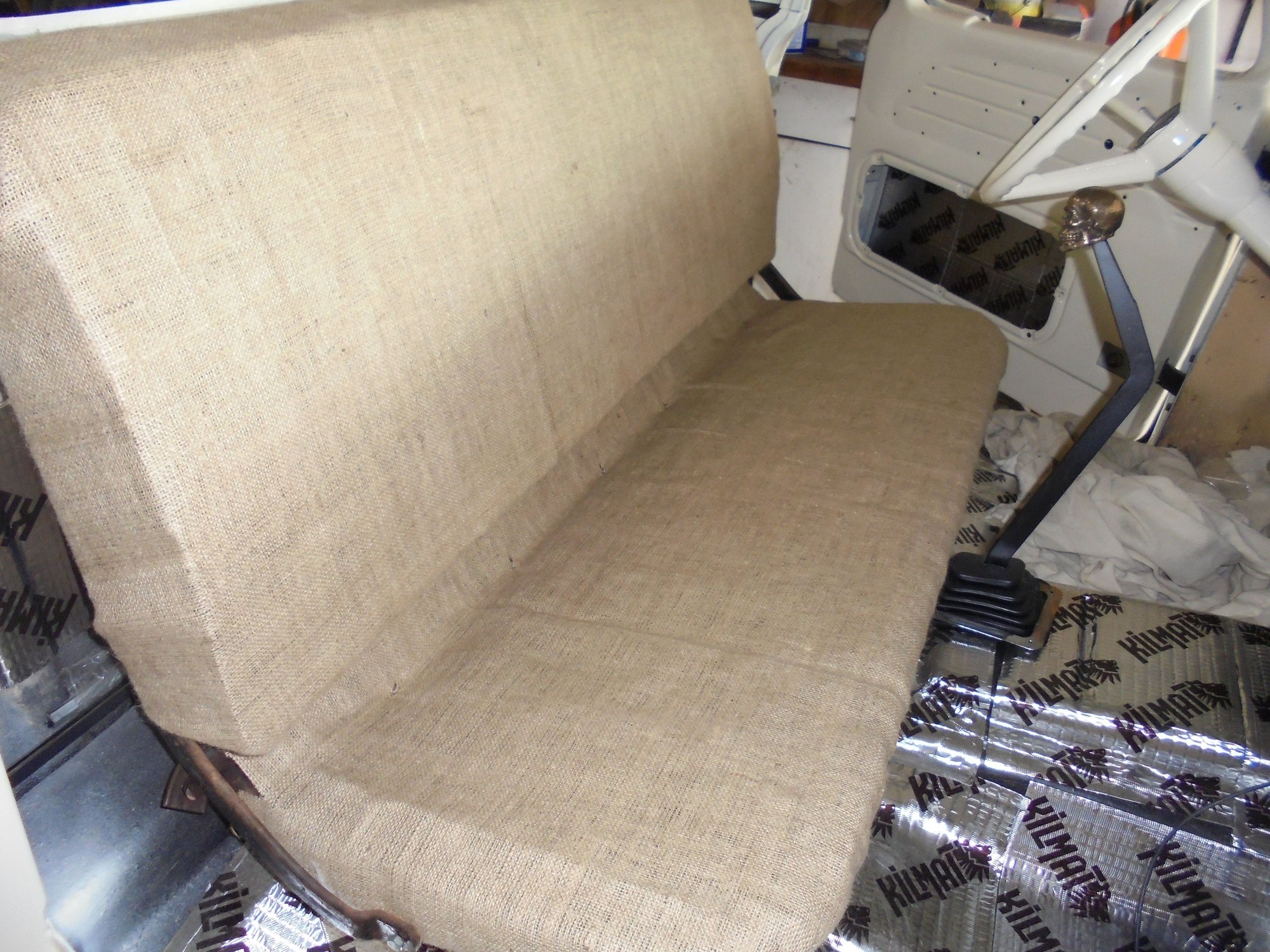

All you need is a custom bent shift lever for the Mustang style T5 with the rearmost shifter position. As shown in the photos, the shifter location is at the rear of the trans cover. I piece of 1/2" x 1" rectangle bent forward near the bottom, and backward near the top clears the bench seat and puts the shifter in a comfortable position within easy reach.
Cost....less than ten bucks and about a half hour's worth of time with a oxy/acetylene torch.
