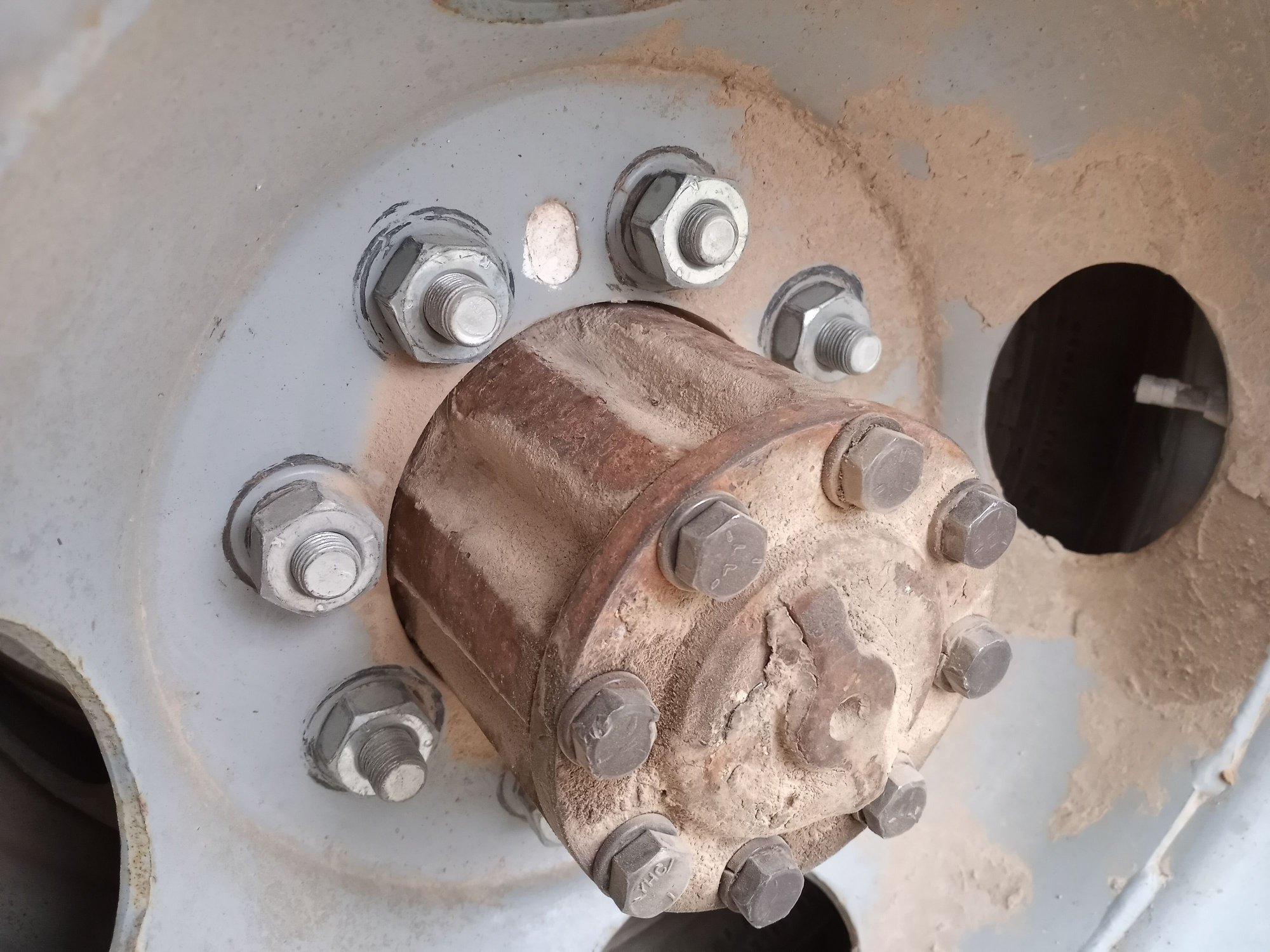

I have a '71-'74 (8-lug) Dana 70 under my '65 F-350 dually. I think (but will check before ordering anything) that I once replaced the left side studs with right-hand thread parts.
The rims I bought new some years ago, and they each have four coined holes and four flat holes! So am I supposed to be running flat (washer)-faced lug nuts on all eight studs, or four of each? I know I'm not supposed to use the tapered nuts on the flat holes (although I have never had one loosen).
Can anyone help me straighten out my nuts?

Because I don't feel like dismounting a pair of heavy truck tires/wheels just to take pics
But here's what it looks like with everything bolted together. Notice that the nuts that enter the tapered holes will thread on further.

Chevrolet one ton wheels that used an additional lug nut flange against the wheel. When those are installed all the holes are coined.

Are you saying I have Chevy instead of Ford rims?
If I added those reinforcing flanges, four of the eight nuts would still sit higher because those four flat holes wouldn't accept the coining but the other four coined holes would... and it would introduce a new stress by flexing/bending that flange in four places.

The flanges sit flat face to the wheel and actually spread the load to the entire face of the wheel. I've worked several short buses with those wheels. Personally I didn't like the design but I just did the tire replacements. And maybe you have something totally different. If they are something odd I'd like to learn more about them... Never seen any truck with four coined lugs and four washered flat faced lugs.
