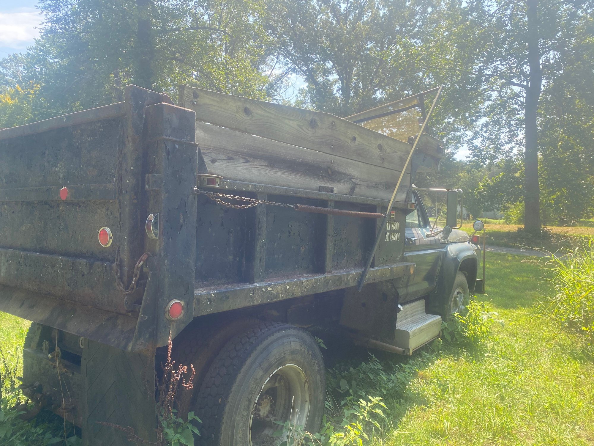

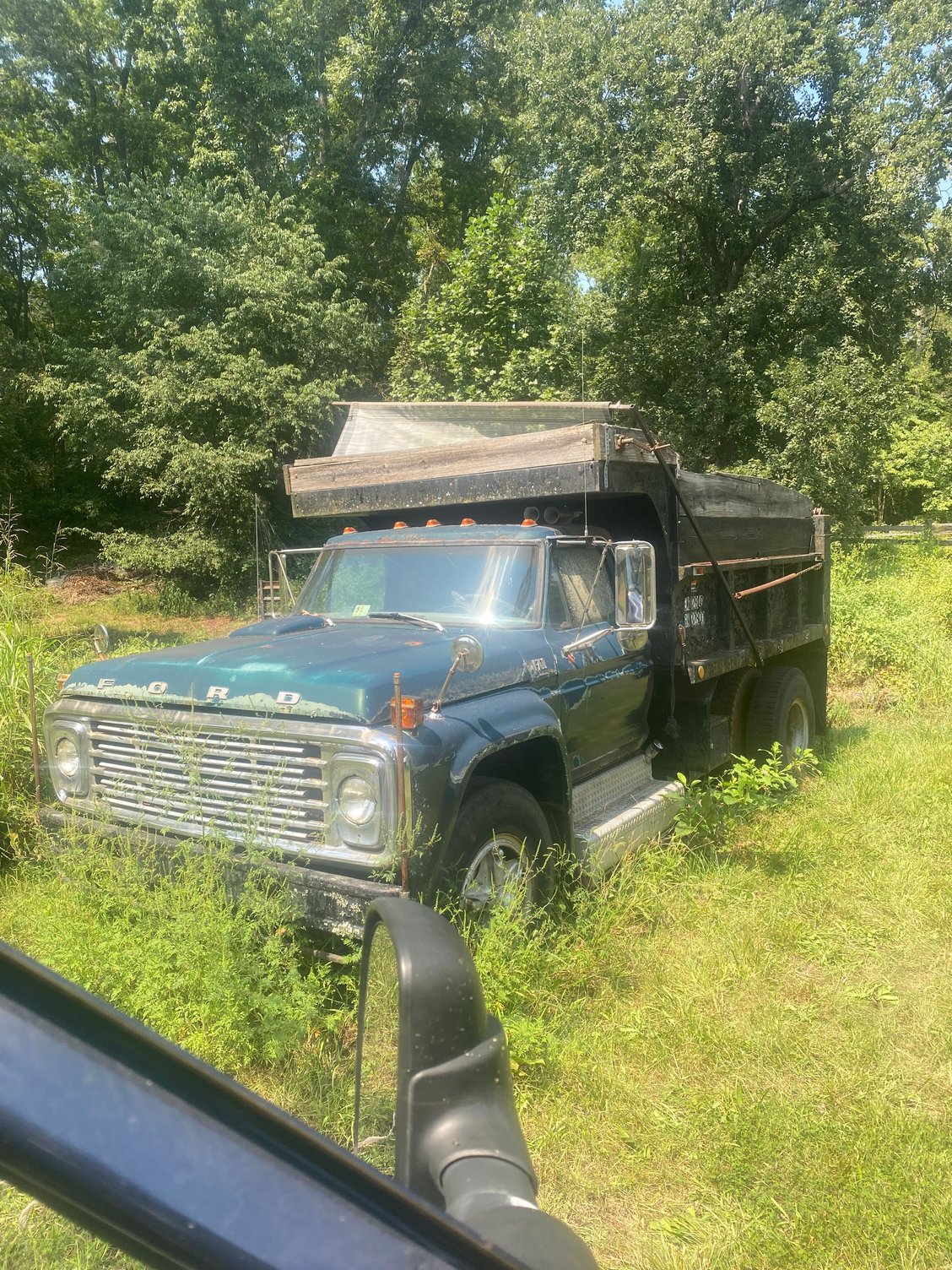

What’s my vin ?
1973 Ford F750 Dump truck
vin number is
F75FV071006
axle
GHN
decipher? What’s the rear axle capacity?
thanks

Welcome to FTE
Not a 1973 VIN. That VIN is 1977. UNLESS it is "Q71006"
F75 = F750
F = 391 4V or 391 4V XD if 1977, FT gas V8
V = Kentucky Truck Plant
071006 = 1977 numerical series, November 1976 production
Q71006 = 1973 numerical series, possibly November 1972 production but that number is not shown in the Shop Manual for F600.
GHN
GH = Eaton model 17221 two speed rear axle, 18,500 lbs capacity, 6.50 / 8.87 ratios
N = Ford front axle, 9,000 lbs capacity, with power steering.
