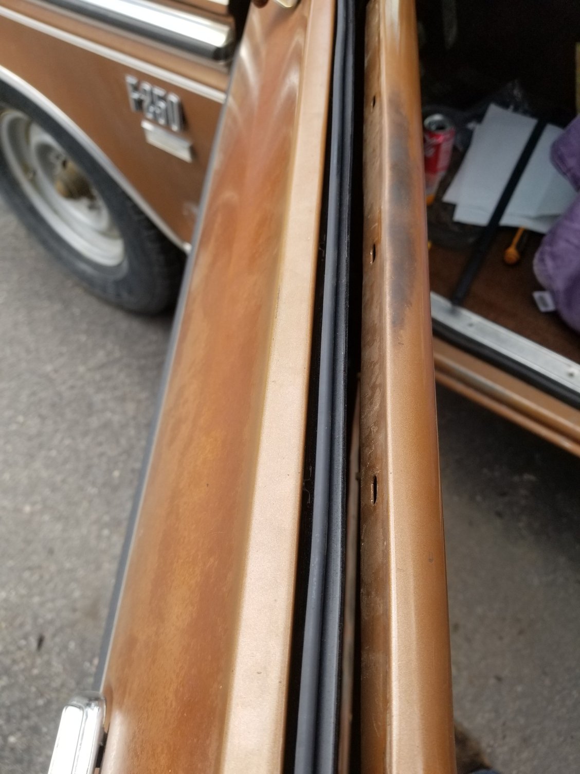

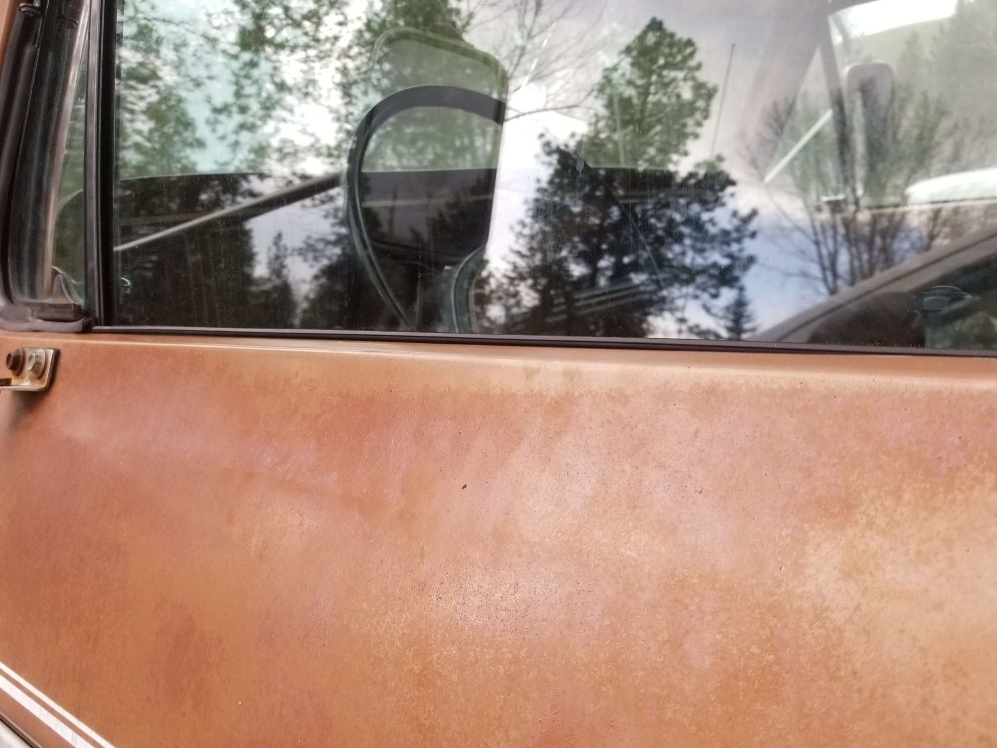

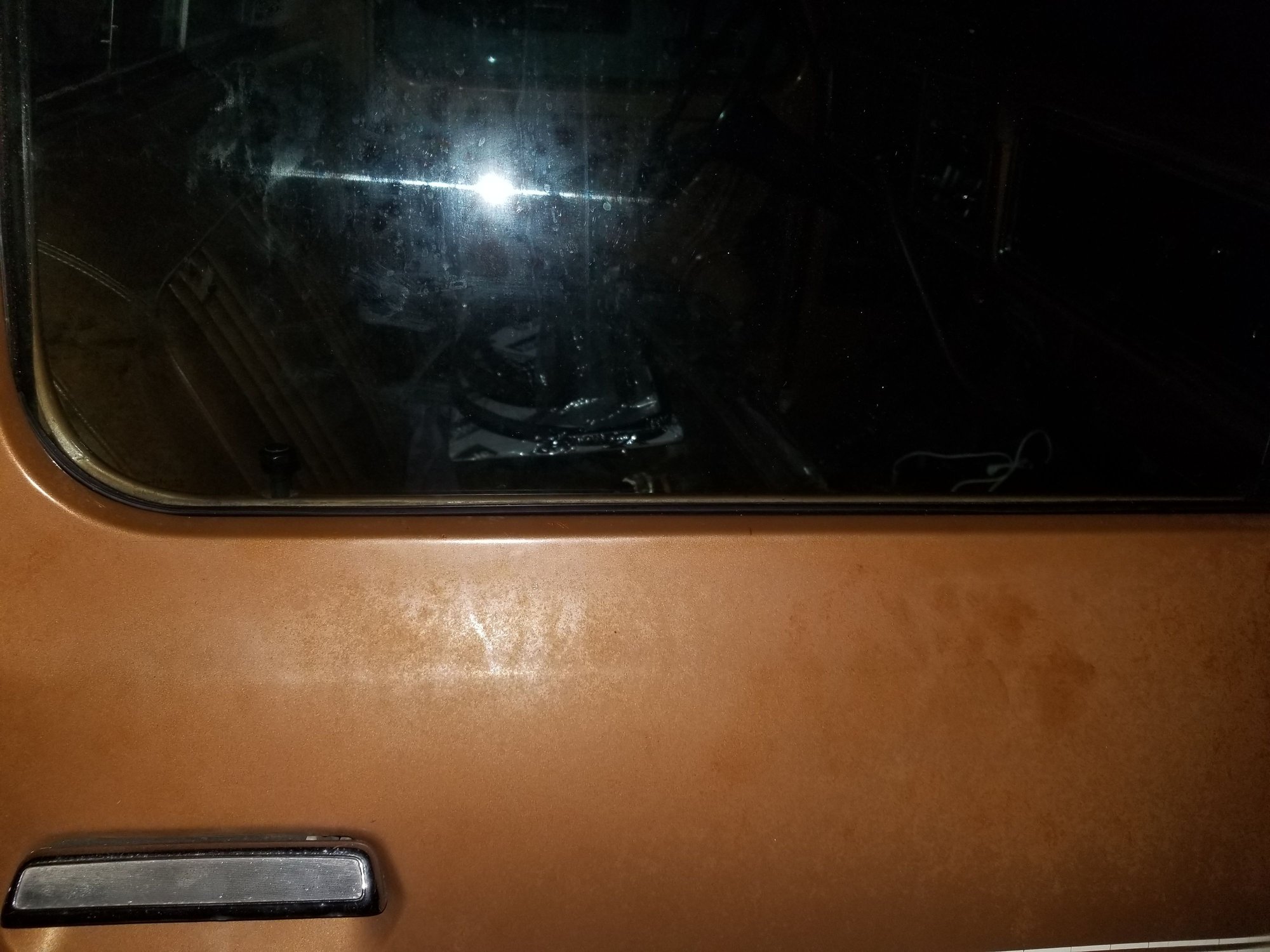

I was referring to the piece that touches the main window not the wing window, it has a huge gap and I can press it down with my finger and it pops back up.
This is the ORIGINAL seal on the driver side, for reference on it being flat with the door line. (will be replaced in the coming days)
Passenger side, new seal. Zoom in if you need to but this side the seal is so high up i can see the felt under it. The other side it sits much lower
Visible gaps
Visible gaps
That sparklyness is the felt which should not be visible.
I hope it does lay down but I doubt it will with the way it pops back up, as if the material isn't the issue but rather the poorly designed clips. I don't know. Hoping the other side doesn't turn out the same.

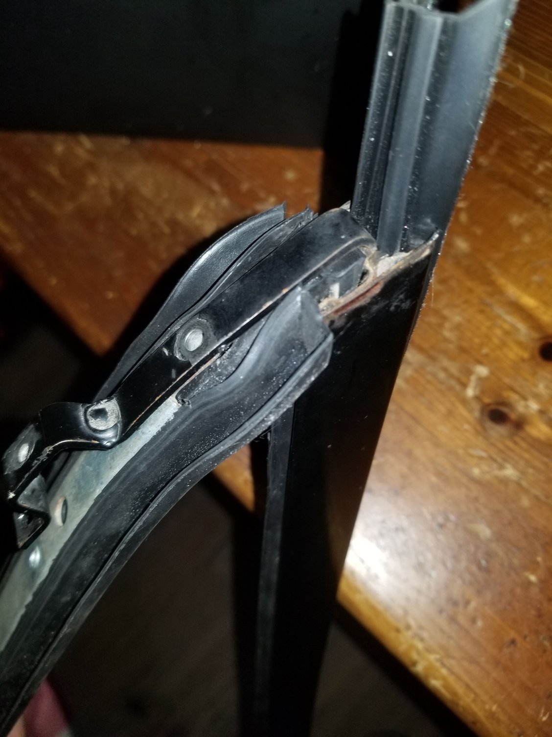

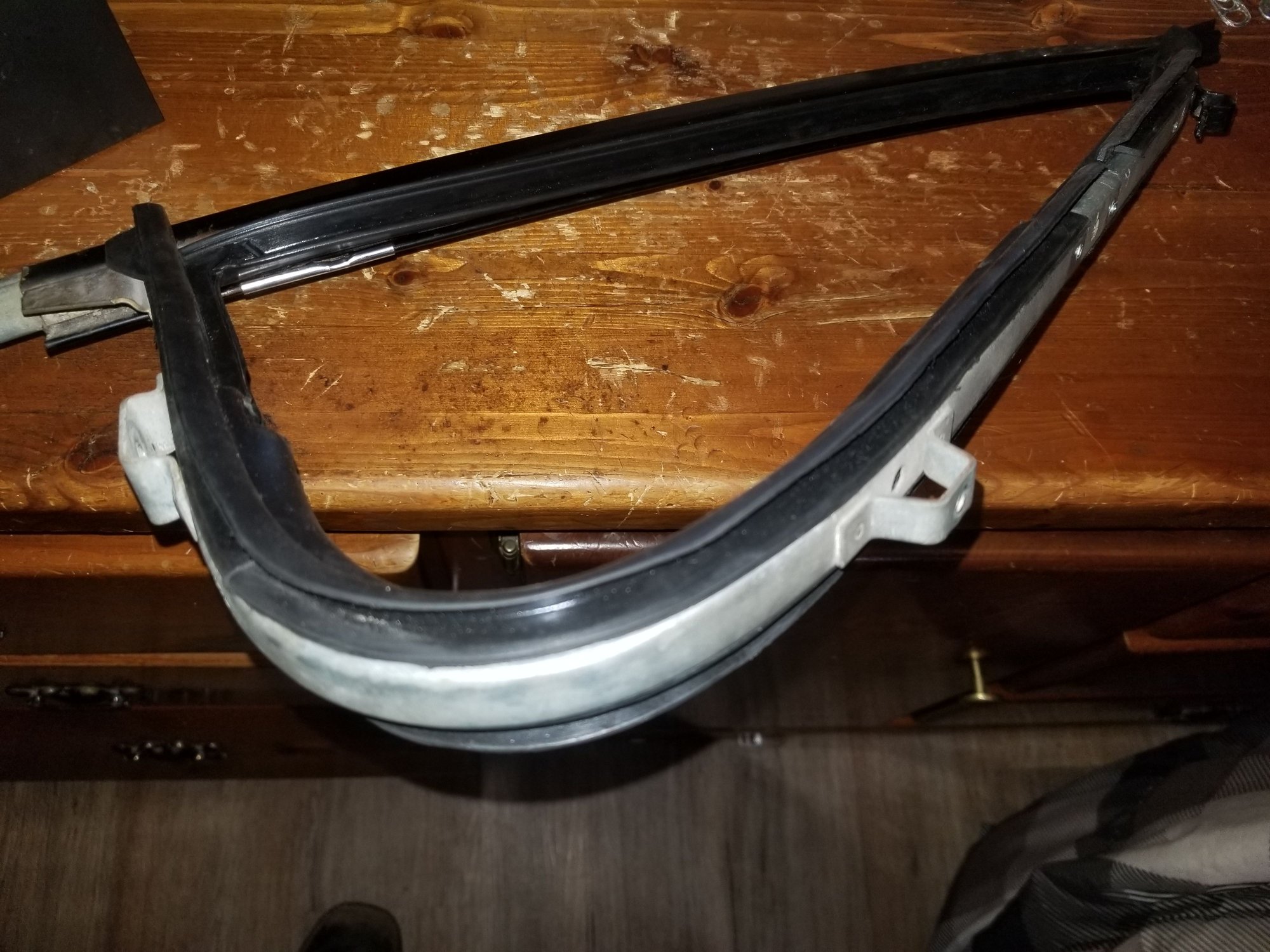

I forget where I bought mine, but they laid in a box here a few years.
Don't know that it helps, but took a couple pics for you.
Ones in '89 likely came from J C Whittney, pretty sure they did fit a little better.
