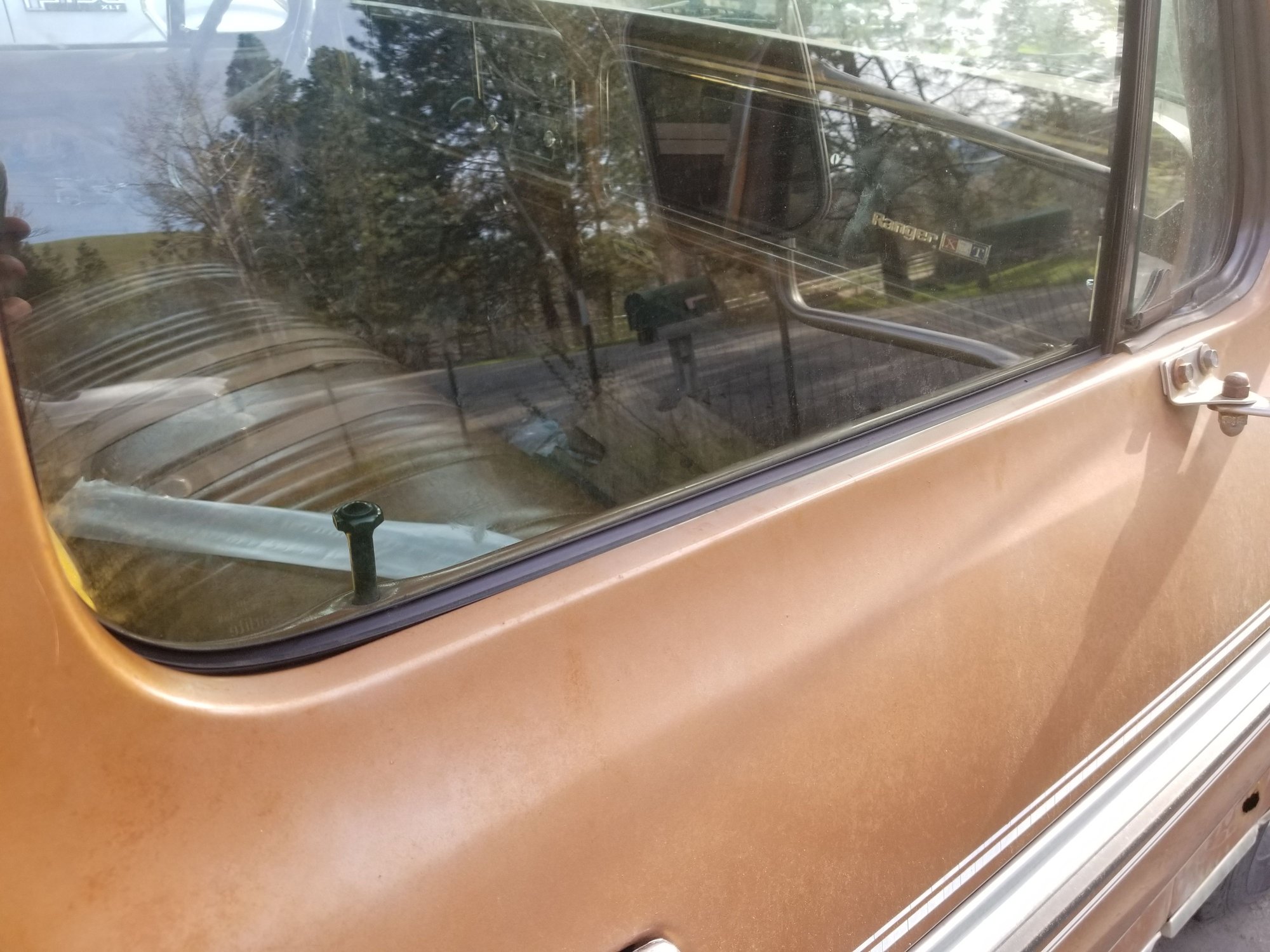

Oh wow, yours looks great. That looks like it came from the factory, not sure what went wrong with mine but yours is excellent. It rained last night and I went out to my truck to inspect my seals, wing windows are real good n tight, all the other seals seemed great, except for those 2 strips on both doors. Both of them let water drip into my door. Good thing I dont have door speakers to worry about.. I was wondering if maybe theres something I can line the buttom of the doors with to prevent rust buildup from it doing that. I may also look into those seals from elsewhere, pretty upsetting because those were not cheap
Edit: hey Tbear, went looking for information for doing the felt in the original sliding window, and I found a forum you were a part of where you linked a better metal window latch and the felt from summit racing, both of which I will be buying. But I did not find an answer to one of my questions; what holds the metal to the glass? The 4 metal sticks that are on both sides of the glass panes (two of which hold the latch) are they just stuck to the glass with clear silicone..? Theres black stuff mushed into them and I can't tell if it was silicone 50 years ago or what it is. They do not stick to the glass anymore if I take a turn they just fall off and fly around the cab its quite terrifying actually.

Oh yeah I'd definitely keep the drains open but those strips shouldn't let a ton of water in, those gaps are bigger than they should be. The old ones kept water out pretty well but the felt was all crumbling so they had to go. Would you happen to know what held the original sliding window together? As in the 4 metal posts that connect to the 2 glass panes, what kept them on the panes?

So i bought new lower strips from Bronco Graveyard because i was extremely displeased with the ones from Steele Rubber. These ones are almost perfect. There is a weird gap on the end closest to the door handle but otherwise these sit at the correct height and (besides that one gap) look factory. Rubber feels good too. Much better than the overpriced junk from Steele

Yeah I noticed the clip on the end wasn't curved with the hole in the door whereas the Steele one did have a curved clip with that hole, but the whole thing didnt hold worth a damn. What was your fix? Did you just pull the clip out and stab it back in at an angle? Haven't done my driver side yet as my hinge pin is bad and the door digs into the fender when I open it

I used a pair of small needle nose pliars to grab and point the clips giving me fits, into the holes. I had more room with the glass all the way down. It finally stayed.

And by glass all the way down do you mean simply rolled down or removed from the assembly and set in the bottom of the door? I would assume it'd be harder getting at the other side of the clip with the glass in on the bearing

I didn't remove the glass to work at pressing the clips in. I just rolled the glass all the way down.
I had had the glass, etc all out swapping doors, put my new stuff and stuff to be reused in the new doors, but some of those clips gave me a fight after I had it all together. Maybe I didn't have them all the way in? With the glass in place just rolled down, it gets tight if the clips aren't pressed all the way in, likely leading to minor scratching of the paint at the holes, but it's doable. Those clips just pop in the holes, no need or use to get on the other side of them.

Hm. All of the clips are pushed in just fine the entire seal is perfect its just that one edge where theres a gap..guess I'll just have to live with it, still way better than the junk from steele
