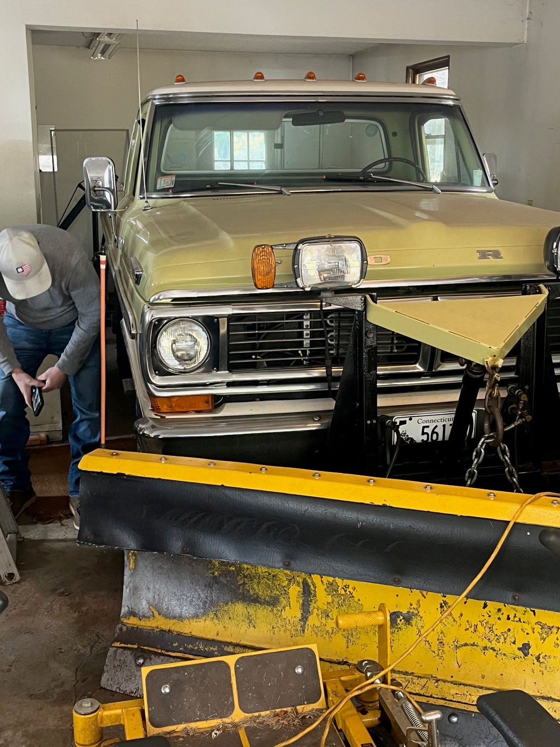

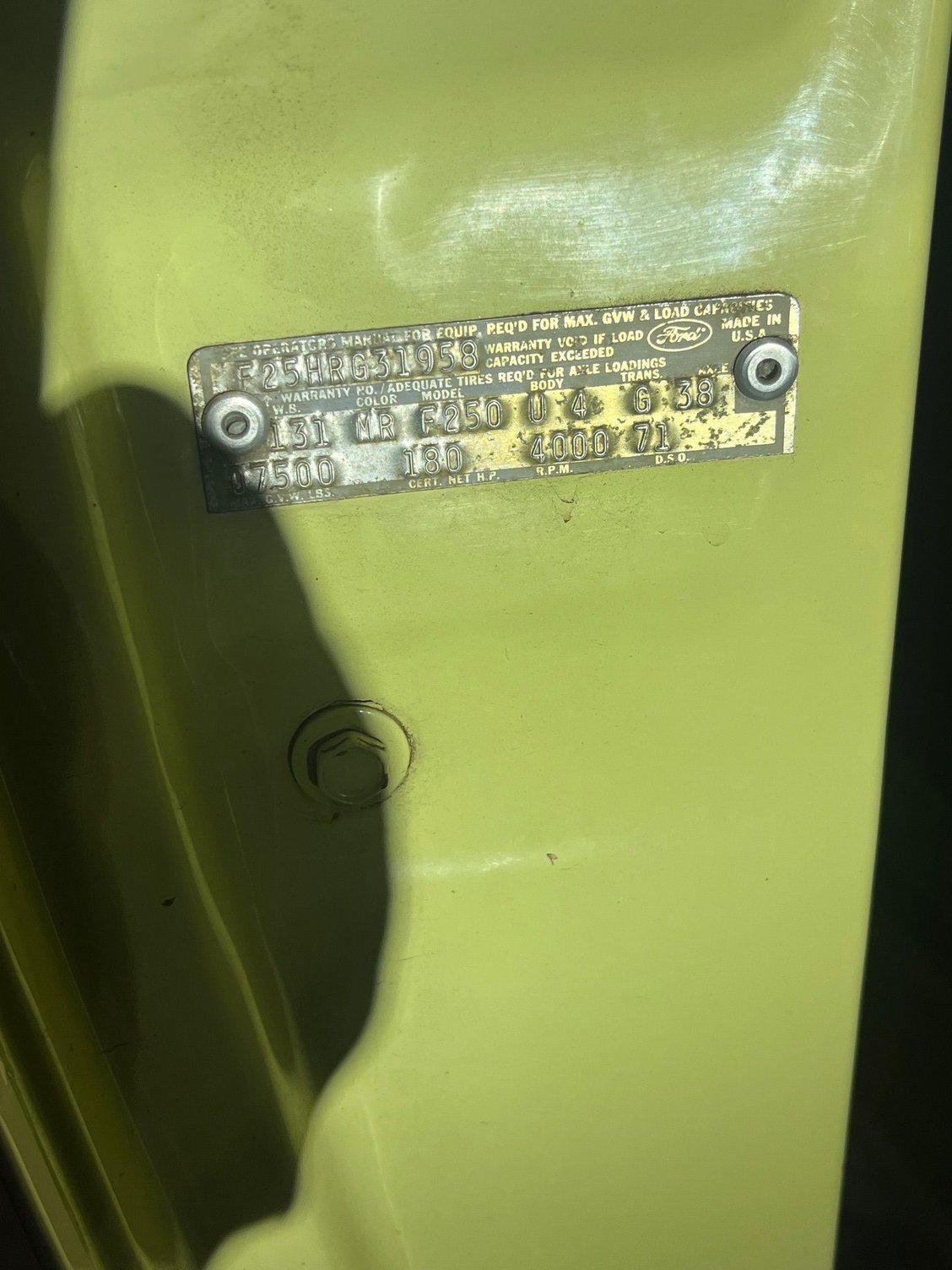

Hi guys. New guy here looking for info on a 1970 F-250. It is a 4x4, but the vin says 4x2?
Looks like it was born this way but, I know it can't be. It`s been sitting in a garage for many years and the girl selling it says it was her fathers.
He has MS and dementia, and she doesn't know much about it.
Not sure if it could have been swapped at a dealer or what? Any info would be greatly appreciated.
They are looking to sell this week but, I don't want to get stuck with a legal problem.
Is it worth $20K?

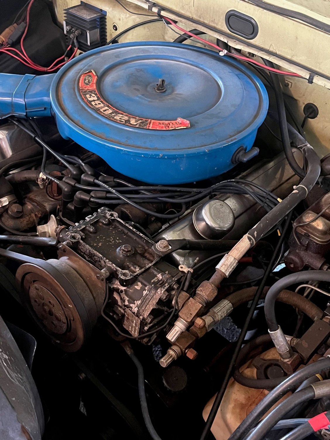

More pics.

The simple answer is that body was put on a 4x4 chassis. Very common occurrence on the East Coast (I know I have done a couple). There is a VIN on the frame passenger side near the core support.
Take a look at it and see if it matches the cab (most likely not).
Truck looks great, if it runs and drives then it's worth what you are will to pay for it.

It is a Frankenstein truck. It is an August 1969 2wd F-250 body set on a 67-72 F-250 chassis, or converted to 4wd. 4wd's were never Camper Specials or got factory 390's. Check the frame vin under the right door for proof.
https://www.fordification.com/tech/vin_find.htm

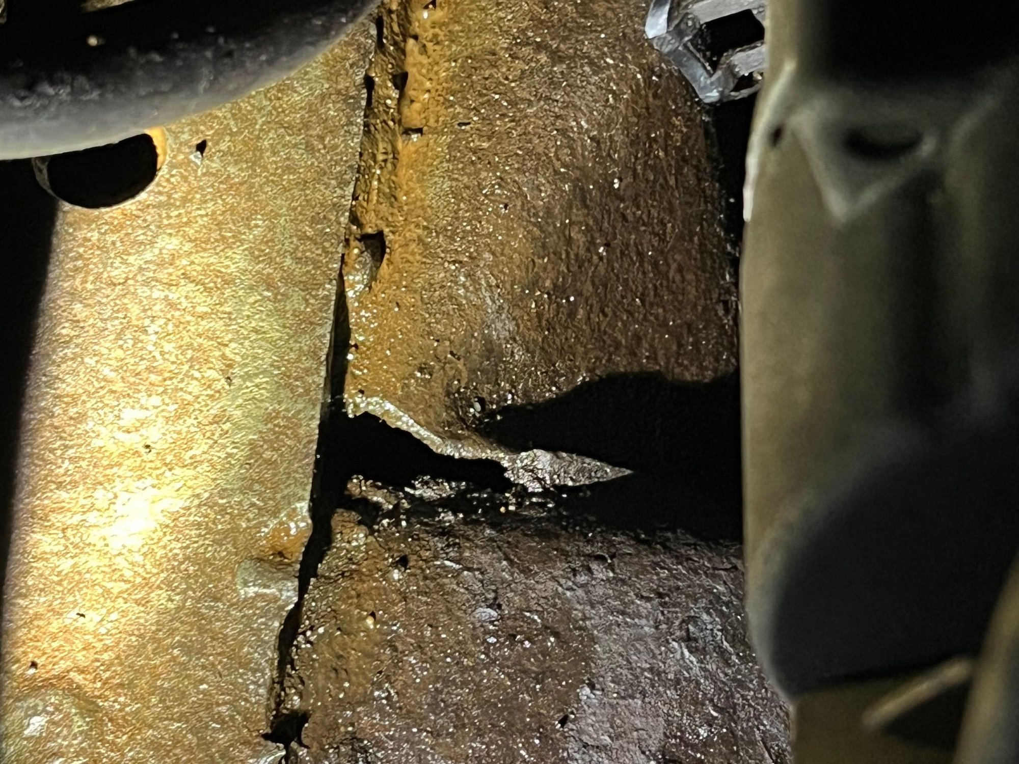

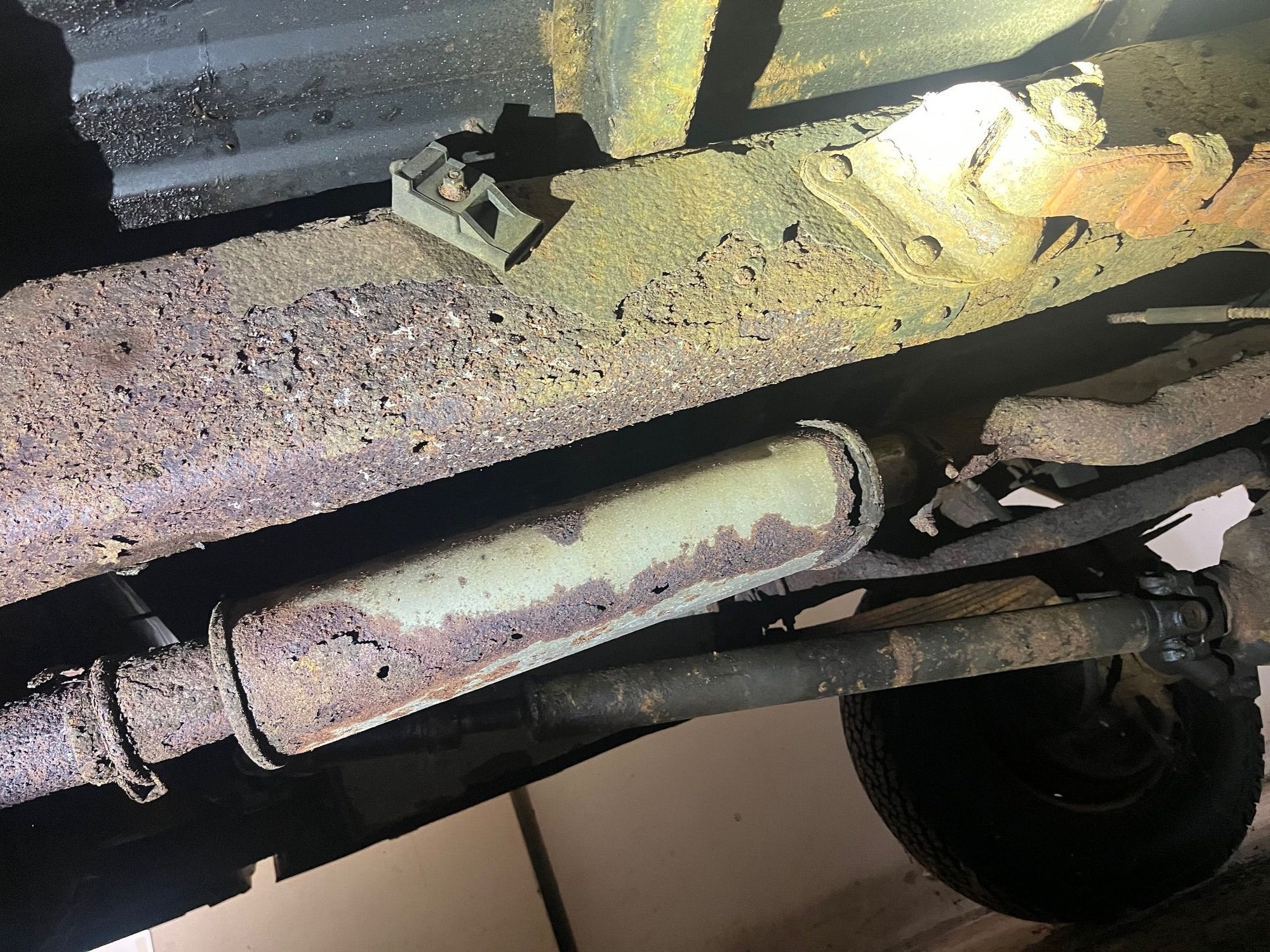

Here`s the frame.

Based on those pictures, NOT A $20K truck at all! Not horrible, but I also see it is a 4x4 highboy frame with a 2 wheel drive body on it. I think you are more in the $10K range personally if it runs and drives. Based on the amount of surface rust present, I would say really look at the brake lines and to trailer it home depending how far you have to go?

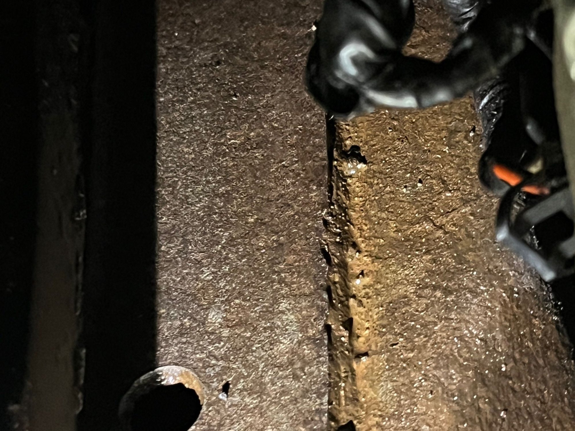

Well, I spent another 2 hours looking this truck over last night, and I could not find a vin on the frame. I`m not sure what year the frame is?
Could it be stamped somewhere else besides the passenger side top frame rail by the alt and under the drivers side door?
These pics are by the alternator.
Old Apr 15, 2025 | 08:10 AM
BobbyFord's Avatar
BobbyFord
Joined: Jun 2003
Posts: 3,919
Likes: 271
Another thing that stands out is that those are not the factory rivets holding the warranty tag to the door.
I did NOT notice that!? They do have a title and it looks good to me.
All the numbers are there. It was bought second hand in 1993 with 99K miles and the OD has 18K now.
I guess I will see if she takes my offer.
Old Apr 15, 2025 | 05:23 PM
52 Merc's Avatar
52 Merc
Joined: Oct 2009
Posts: 16,160
Likes: 4,761
From: Burbank, WA
Not running, not driving, mis-matched frame and title, lots of chassis rust, not worth 20K. Not even 10K imho. Plow trucks are worked hard and typically put away wet. This one looks like they put a decent body on a rusty 4x4 frame. Does the title they have match anything? Or is it just a piece of paper. How much risk are you willing to get into, and what are you willing to pay for that risk? How bad do you really want this? The pop rivets on the vin plate was what I came here to mention, and it's been said already. Buyer beware.

That's a pretty rusted up frame and undercarriage.
Here's a California truck for less, with no rust...> https://sacramento.craigslist.org/ct...842739469.html

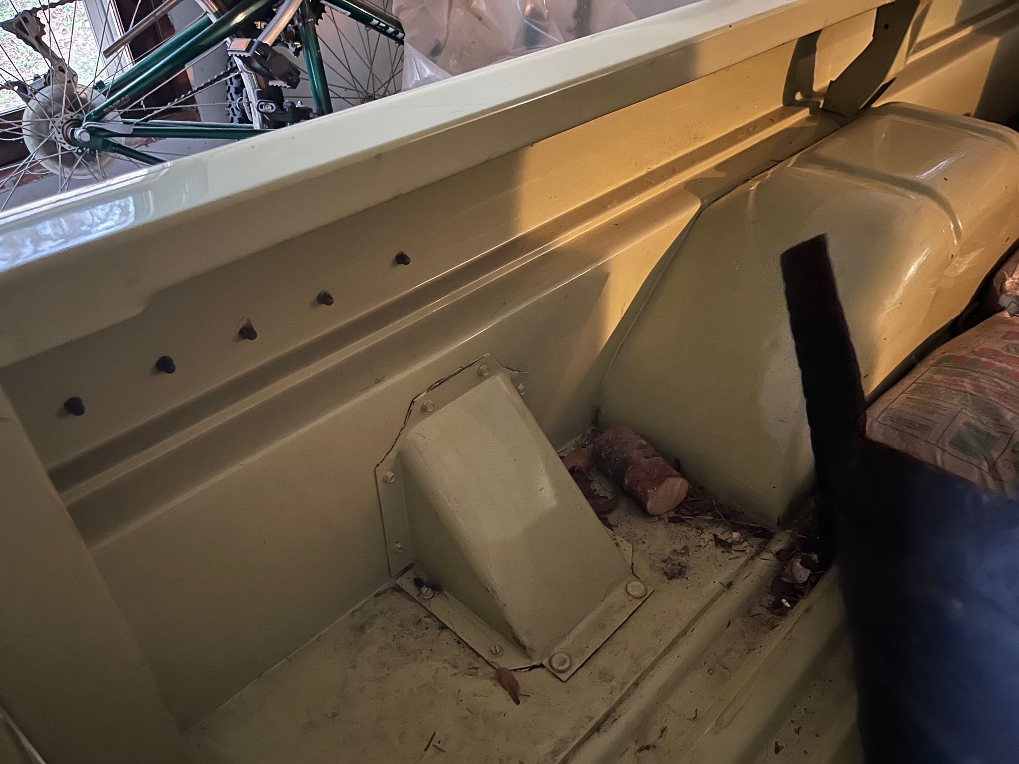

Here are some pics of the bed.
