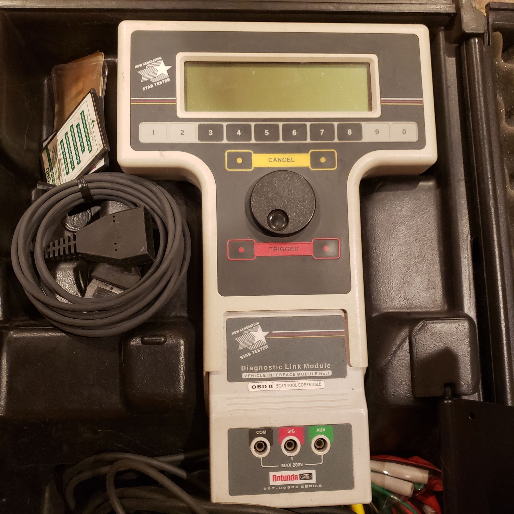

I would reprogram it with one of these Ford NGS scan tools
It'd take me about 5 minutes with mine
Not sure of how many times it's allowed myself, either 5 or 6, I think 5 times

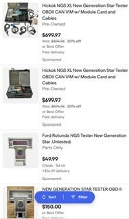

That makes a lot of sense. Suggest buying a $700 NGS to reprogram the PSOM when you can do that for free…
or do you like showing off your tool collection? It’s not just you. It only allows everyone 5 resets.
