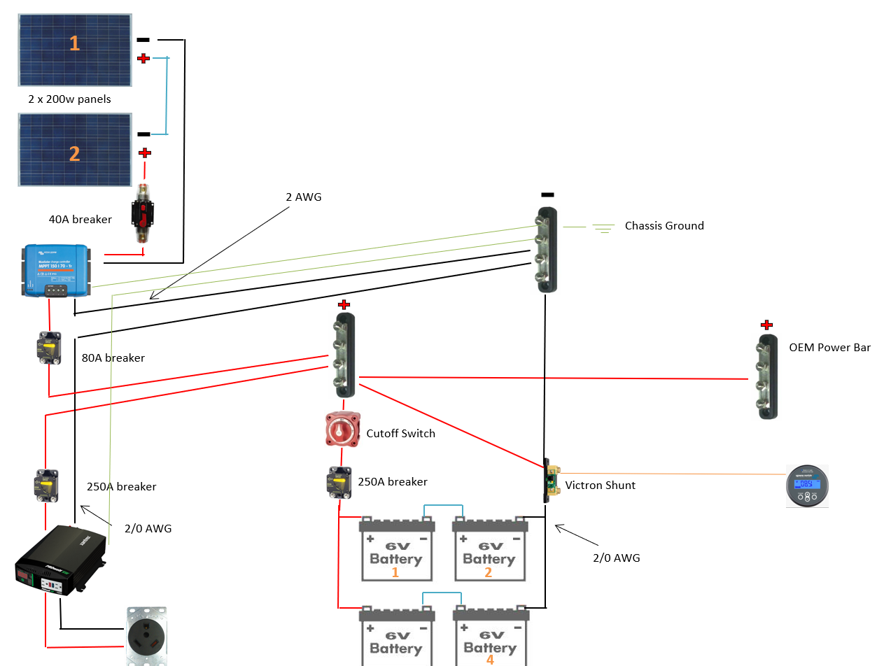

After many years of studying and researching the option of lithium batteries, we feel we are ready to make the jump from FLA to lithium for our 5th wheel RV. We have been using 4x Trojan T-105 6v FLA batteries since 2018 and they have done well, but are starting to show their age. They are used for ~9 months out of the year off and on for local and cross country trips. They are checked for water level at least twice a year and are monitored with a Victron BMV-712. We have 400w of solar panels on the top and a Victron MPPT Smart Solar 150/70 to maintain the batteries when the sun is available.
  • I am in the market for a converter charger to replace the existing converter charger and be in line with the new (lithium) charging profile. Not looking for a power house, just something around 50A or similar to the converter charger we have which I think is 50A, but I will have to verify the gauge of the 12v wires and the specifications before pushing the buy it now button.
  • I am also in the market for batteries and have decided on SOK or EPOCH as our products of choice. That is unless someone is able to steer me clear of them as things may have changed a bit since I slimmed down the options to these two over a year ago. I conversed with @HRTKD a while back about building my own lithium batteries, but I have swayed away from that as sometimes it is just more efficient to go with a manufacturer when factoring in time, resources, parts, labor and effort.
We are looking to be in the 300 - 500 Ah range and are not concerned about size as if the batteries do not fit in the front "garage" space under the front of the 5th wheel, I will move them to the space under the stairs with 4/0 cabling. We live in north GA and the risk of the batteries being utilized in near freezing conditions is not a concern. We put the 5th wheel in "storage" status during the winter couple of winter months and I plan to remove power via the panels from the MPPT controller via the breaker and then use the main battery cutoff switch to let the batteries sit idle with no loads at all. We have 30A service to the 5th wheel, so lights and what not are supplied 12v power from the converter charger.
Any suggestions or lessons learned about SOK, EPOCH or converter charger solutions are welcomed.

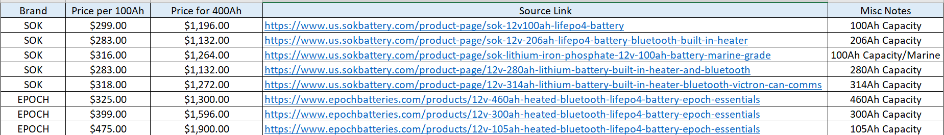

Below is a small spreadsheet I built with some comparisons between the options. Price is not the biggest concern, but it is a consideration.
Below is a rough diagram of our solar and power system that I created in Power Point. I used this as a reference in order to keep myself in line when assembling and installing the equipment and wiring.

After hemming and hawing about the SOK vs. EPOCH choice, we decided on the EPOCH 460Ah Essentials battery with heater and bluetooth. When purchased directly from EPOCH, there is a 15% off coupon code (CHAMP15) that saved us $224.85. Also, EPOCH is located in GA, just like we are and are moving their manufacturing, testing and distribution to Marietta GA which is less than 2 hours away. In the unlikely event that we had a warranty claim over the next 11 years, I would be able to deliver the battery in person instead of messing around with shipping like in the SOK warranty process.
In the end, we paid $1363.34 for 460Ah where the SOK batteries would have been ~$1225.00 for 412Ah and a 7 year warranty.
We considered each of the batteries of equal quality, history of service and online reputation. It really came down to which company would be easier to deal with if a warranty claim was required over the next decade or so.
We are confident this 460Ah EPOCH will suit our application much better than the 4x 6v Trojan T-105 batteries and at a significant weight savings. The 4x Trojan batteries weigh in at a slim 248 lbs and the 1x EPOCH weighs in at 84 lbs for a savings of 164 lbs.
We like the idea of having 2x SOK batteries for redundancy in the event of a failure, but picking up a cheap 12v deep cycle battery for emergency use can be done at thousands of places across the country.

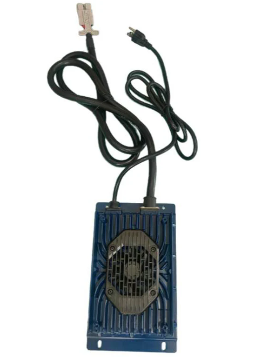

I am still deep in the weeds on which model to go with, but so far I am leaning toward the EPOCH 12v/50A since the service has been nothing but stellar from EPOCH.
Converter charger link: https://www.epochbatteries.com/produ...poch-batteries
