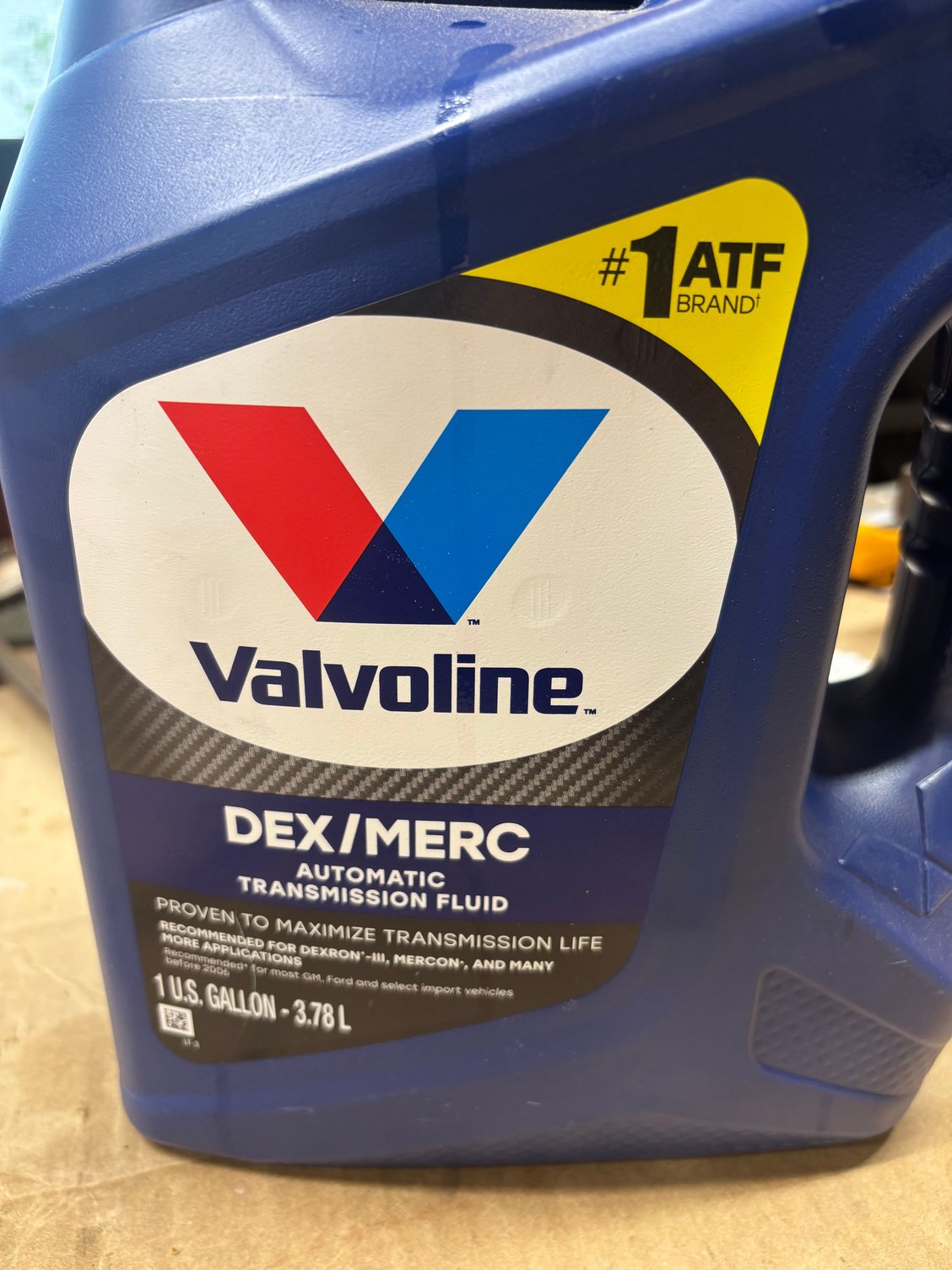

This is what I put in my 208:
The above is what I recommend and use. And there are other companies that make the Dex/Merc fluid besides Valvoline.. It's what your transfer case originally had in it, with a couple of improvements to it.
