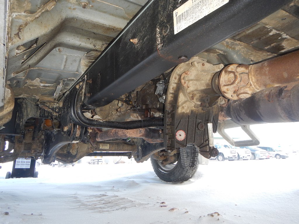

I bought the "transfer case fluid" which smells and looks exactly like the Mercon ATF, but supposedly it doesn't have the detergent additives which aren't needed in a t-case application.
I'm pretty sure the current transfer case is the exact same design and casting as the ones made by New Process Gear (Magna Powertrain), just without that badging on it, just a round metal plate where the model badging used to be on past models.
(blown up) one on a 2009 F450 showing the badging.

Trent, love the pic of the blown-out T-case.... bet that was loud and expensive.
