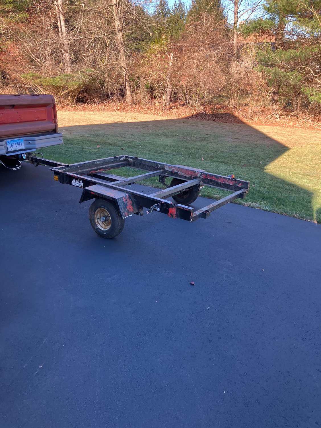

I was thinking it was going to be something like this,

That is pretty much what I will be pulling
