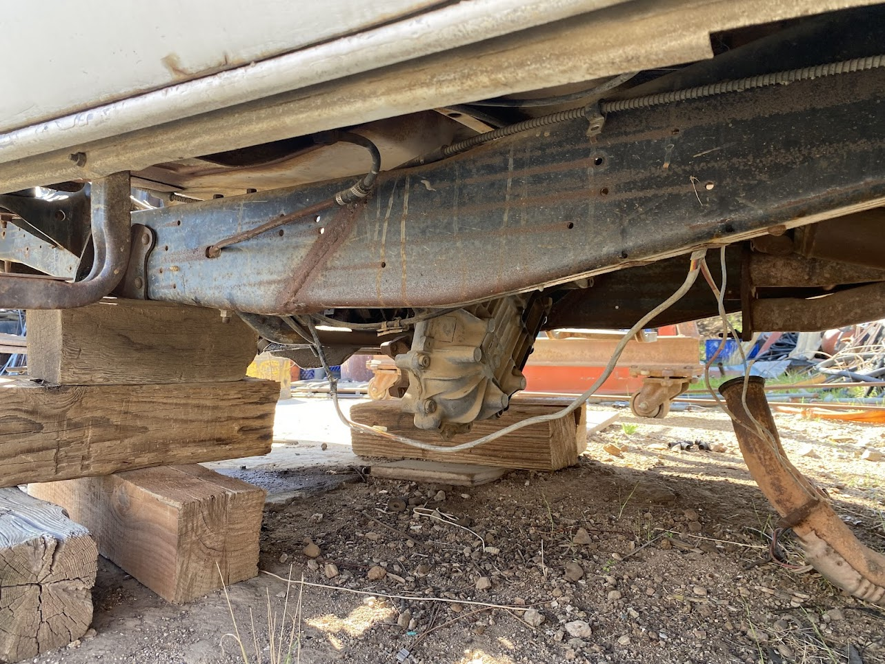

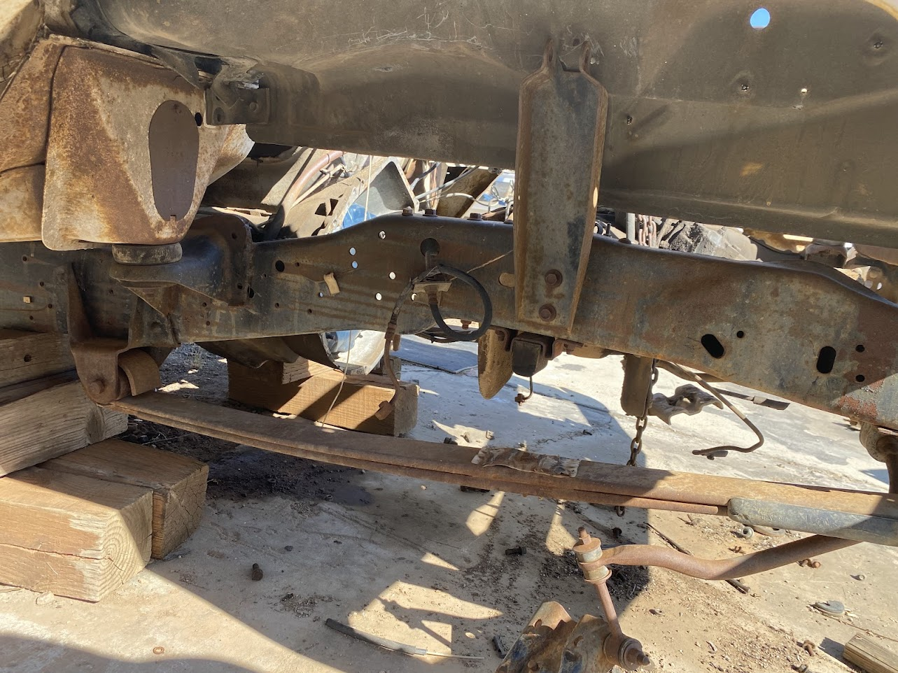

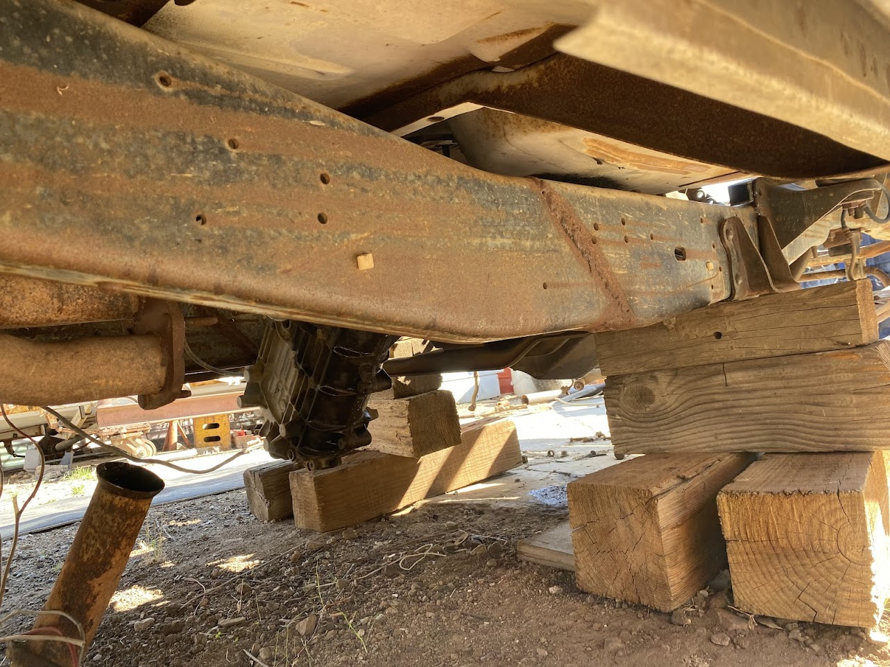

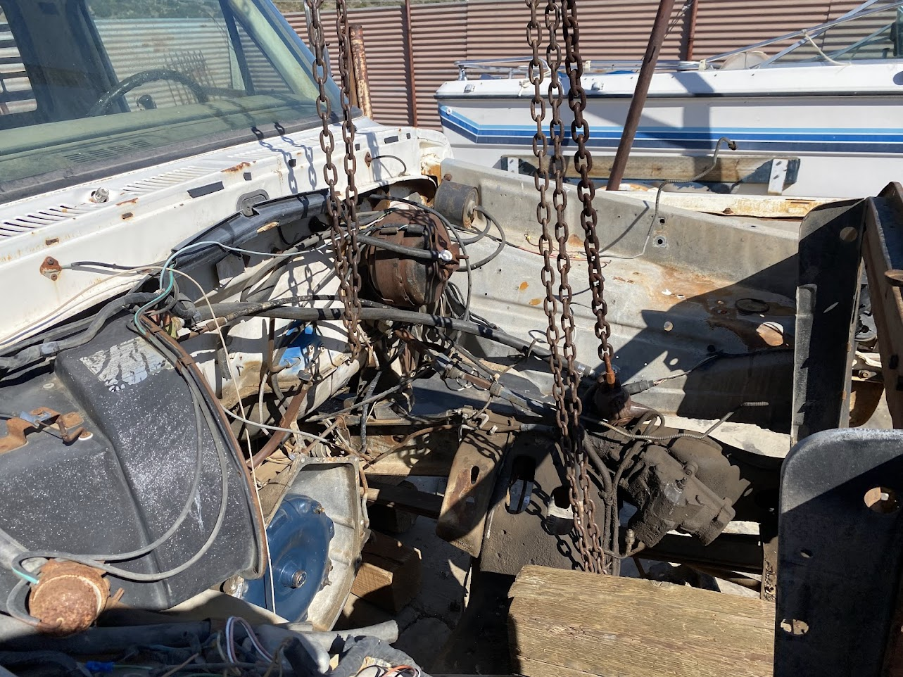

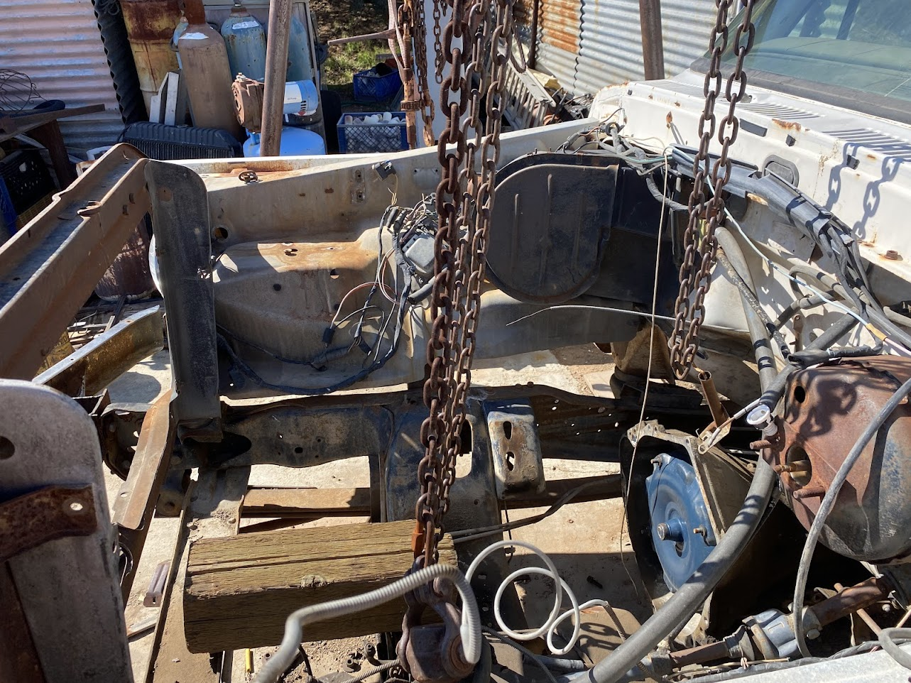

Doesnt suprise me, my uncle has a 96 F250 with a service bed and it doesnt ride all that bad in my opinion. Im not really worried with ride quality personally my current 4wd is leaf sprung all the way around its a "highboy" so there is no comfort in offroading with it. However it will take you wherever you want to go. I just need to know if I can do what im talking about doing. I know on dentsides I can 4wd convert a 2wd pretty easy as my white truck has been but theres no way I could convert a 4wd to 2wd because of the different crossmembers for the I beams. Im hoping its not the same case with TTB swapping this chassis otherwise I cant do it. Trying to get it running cheaply and not dump 3k into a D60. Heres some pictures of the engine bay and where they shortened the frame for the single cab. I dont have any pictures of the front underside though.

I would not be surprised if it just bolted directly in.
Looking at Torqueking’s website, they do not differentiate - the parts are all listed for 1980 through 1997, for the D44 and D50 TTB.
Take a good look at the engine cross members and make sure they are the same and that it is drilled for the pivot brackets. If not, locating them would probably be the biggest job.
Pitman arm will be different.
Steering components. They are different. Make sure you get those from the donor.
Front drive shaft. If you still have the one from the D60, it may work fine. Going the other way, most times it is recommended to replace the F250 d/s with a donor from the F350 / D60.
Transfer case yoke if replacing the front driveshaft. They are different.
Front sway bar, different mounts. To the front bolt in cross members, I can see it there in the picture.
Leaf springs. Although, you would gain some real lift from those F350 springs, they say they are susceptible to cracking from the twisting motion of the TTB arc of travel. You’ll also have to deal with drop brackets, not the stock pivot brackets, for alignment.
Rear axle lift blocks. F350 = 4.25”. F250 = 2”. You may have to change those out if using the TTB. The TTB will sit lower than the D60.
If using the bullnose truck, bring the whole truck home if you can. If not Rob everything related out if. Transfercase, leaf springs, pivot brackets, steering gear box, sway bar and mounts and cross member bracket, rear lift blocks and axle.
Cost - Much cheaper to find a D50 TTB than a D60. $3k you mention would be on the cheap today for a D60. A beat up rusty bare axle today is selling for $800. Good ones are listed now for $1,450 - $1,850 usd, as removed, still requiring a complete disassembly and rebuild. (If by chance you do- Have a good look at the RH u bolt plate pad, it is welded to the axle. Twice now I’ve seen them packed with dirt and rusting out, requiring replacement.) Assuming you can get the whole TTB setup on the cheap, it’ll be cheaper than buying and rebuilding a 60. If the 44/50 TTB needs rebuilding, keep in mind it can get expensive as well. All depends on the donor you have lined up, and what you want to end up with when you’re done.
EDIT: Just re read your post, I didn’t realize the frame was shortened. I’d also want to be doing something with those frame welds. Plating them, and probably grinding down the welds and re welding, I see holes in the welds.
I would probably be pretty limited in what I’d be willing to spend on this as well. If I think of anything to add, I’ll come back and edit the above list.
Don’t forget brakes as well.. No matter what you go with, unless it is right there locally, complete, usable and cheap, it will be expensive today to replace the entire front end from scratch.
