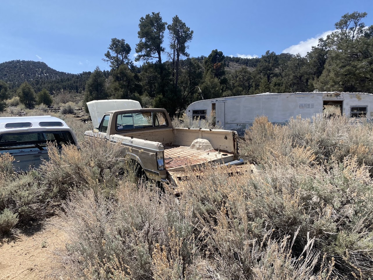

Here is the Bullnose I speak of.

I had the feeling you were able to get all that for cheap. If you can combine the two, for $500, what the heck. Might make a good off road hunting trail rig.
Off topic, Id be real cautious about that frame…
That box on the bullnose has seen some better days!

The bullnose frame may be weight relieved. No mention of the year. It does have the letters on the hood, it’s very possible.

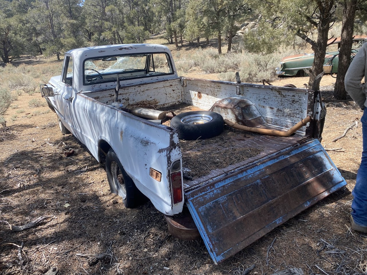

Yeah, I dont own either of them at the moment but I definitely could for probably under a grand. Thats why I havnt put up to many pictures because theyre not my vehicles.
Dude I have no idea how they beat that bed up that badly. They also have a 70 C20 that has a bed thats bashed just like that one. Funny enough the Bullnose and the C20 are only about 20' from each other.
