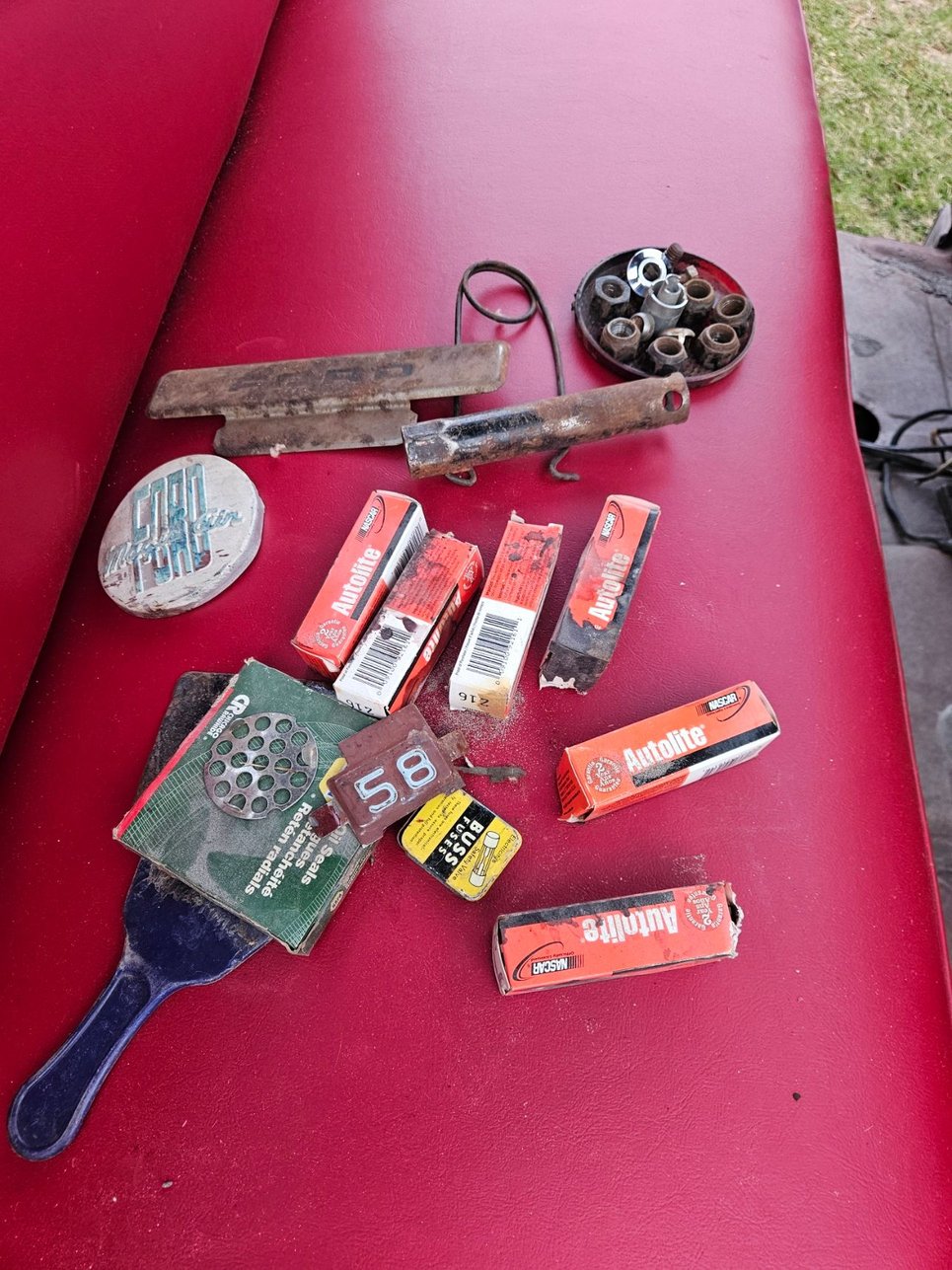

I have been finding "artifacts" in the glove box and tub of parts as well. Can anyone identify the 4 pieces in the one pic attached?

Welcome! Lucky dog, you have one of the two spare tire hangers. Believe one of your tire irons is correct. It doubled as a lever for the rear wheel bearing nut socket. A vote to keep the spur gear 4 speed!

As for the unidentified parts, I think you will find many of them are part of the factory tool kit offering. Be glad you have them!

Another version of the bearing nut socket. I had 2, but traded Stu one for something he had. Any evidence of a flat generic looking wrench? It was for the nuts on the spare tire hangers. I have one, haven’t seen another.

OHHHH!!! That's what those are...I had no idea it had a toolkit! I have the jack parts as well...I just didn't connect them together.
And the threaded piece is a spare tire hanger, but one of 2? That jogged my memory...went out and looked under the back of the bed.
Look what I found!
