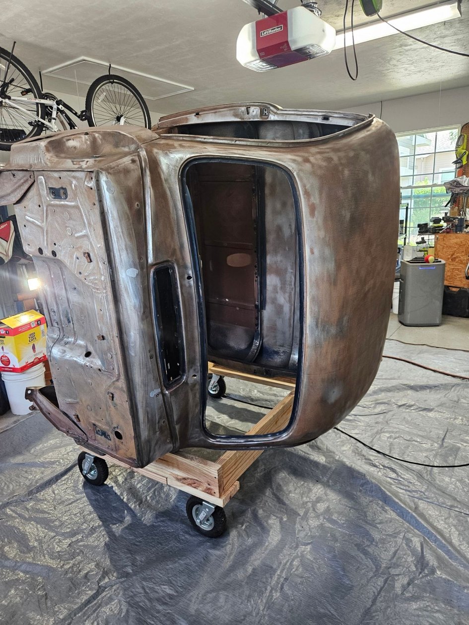

Haven't posted in a while...Florida heat and humidity do not make working in the garage much fun this time of year.
Body work, stripping and priming has begun. It appears I have one of those odd trucks with a black gas tank. The PO hired a guy to glass bead blast the truck, which worked sort of. I'm not super impressed but it did most of the work for me, so I'm not complaining.
However, there is zero evidence of blue paint on the gas tank. But there is/way blue overspray on the back of the cab. My best guess is...the fuel tank got replaced at some point. Regardless, it's going back painted blue.
I'm still just amazed at how little damage this truck sustained over 73 years...absolutely crazy time capsule. A few holes in the fenders that patched in minutes and a couple of small dimples here and there that a body hammer took care of.
The one rectangle that the PO cut out of the side of the bed has been welded back in place now and I just have to find some rivets to replace the 3 that are missing.
Good progress, but a lot more to go.
Why was this rectangular piece cut out do you suppose? Was it rusted out?
Very nice truck. Keep us posted with your progress.
Old Jul 18, 2025 | 11:00 AM
  #66
silverstar71's Avatar
silverstar71
Joined: Feb 2025
Posts: 123
Likes: 111
I was told it was a rust area. Local guys welded a new piece in its place and I've ground it down and leveled it. Once I get some rivets back in the holes and prime it, I don't think you'll ever be able to tell.

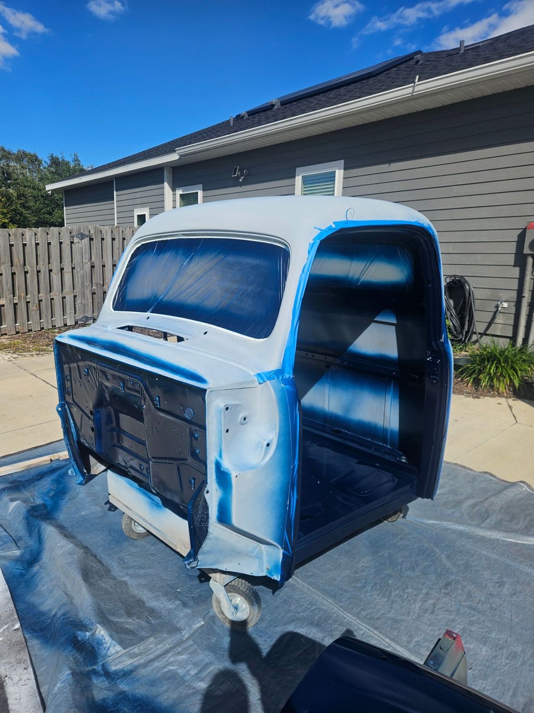

Starting to get blue parts painted finally! Weather has cooled enough here. Still mastering the finish, but where I've messed up has been pretty easy to wet sand and buff. Sheridan Blue is a beautiful color...

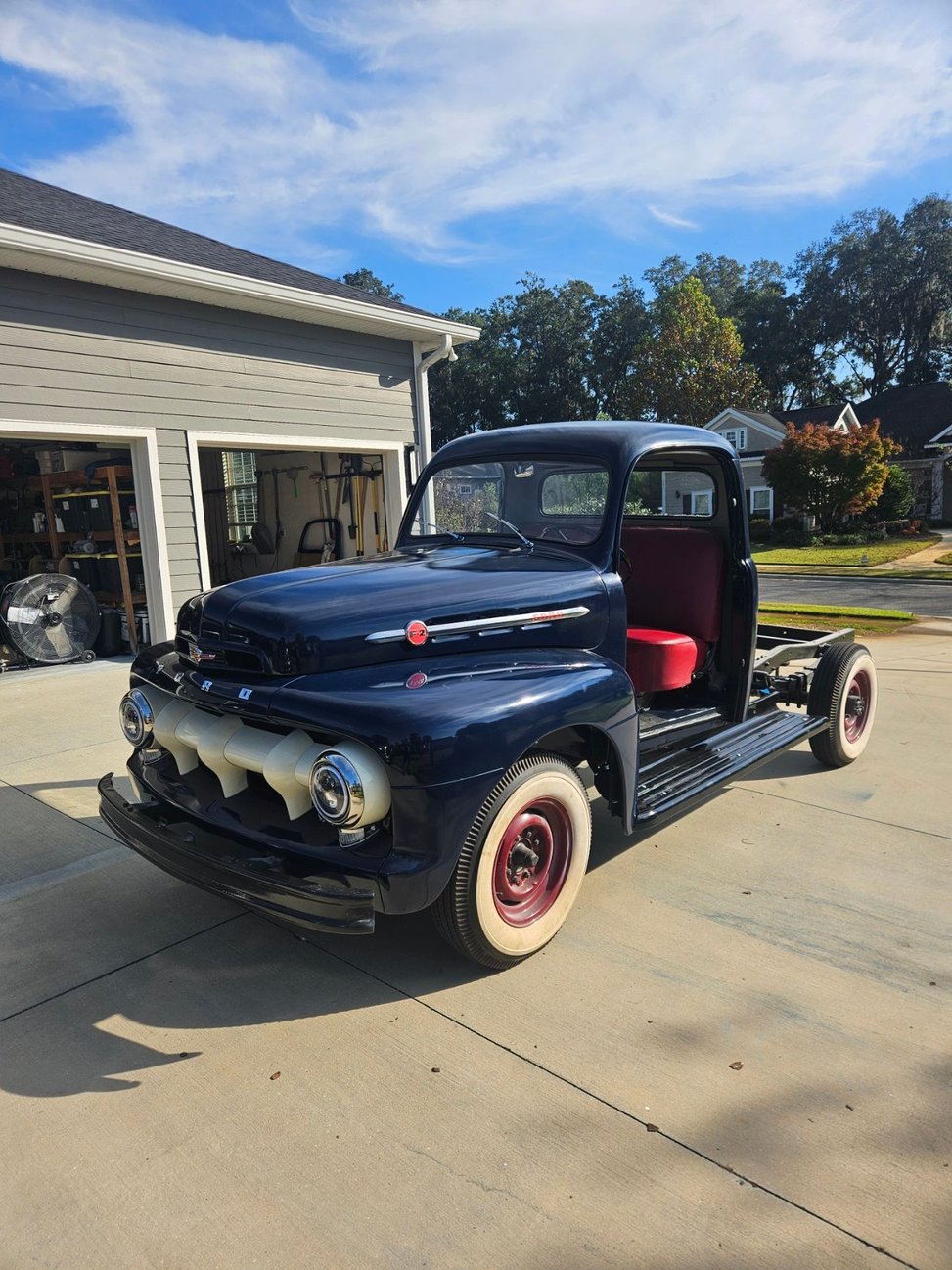

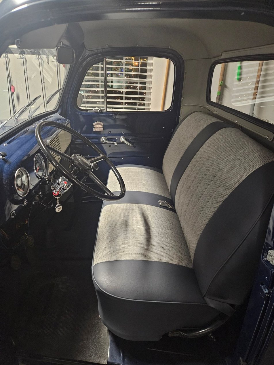

Some progress pictures...
Took her for her first spin...just needed a small idle adjustment. Otherwise, ran great!
Bed and tailgate are next...wood has arrived, so I'll be trimming the boards to fit and starting the finish process over the break.
Plenty of little odds and ends to work on, but coming along nicely.

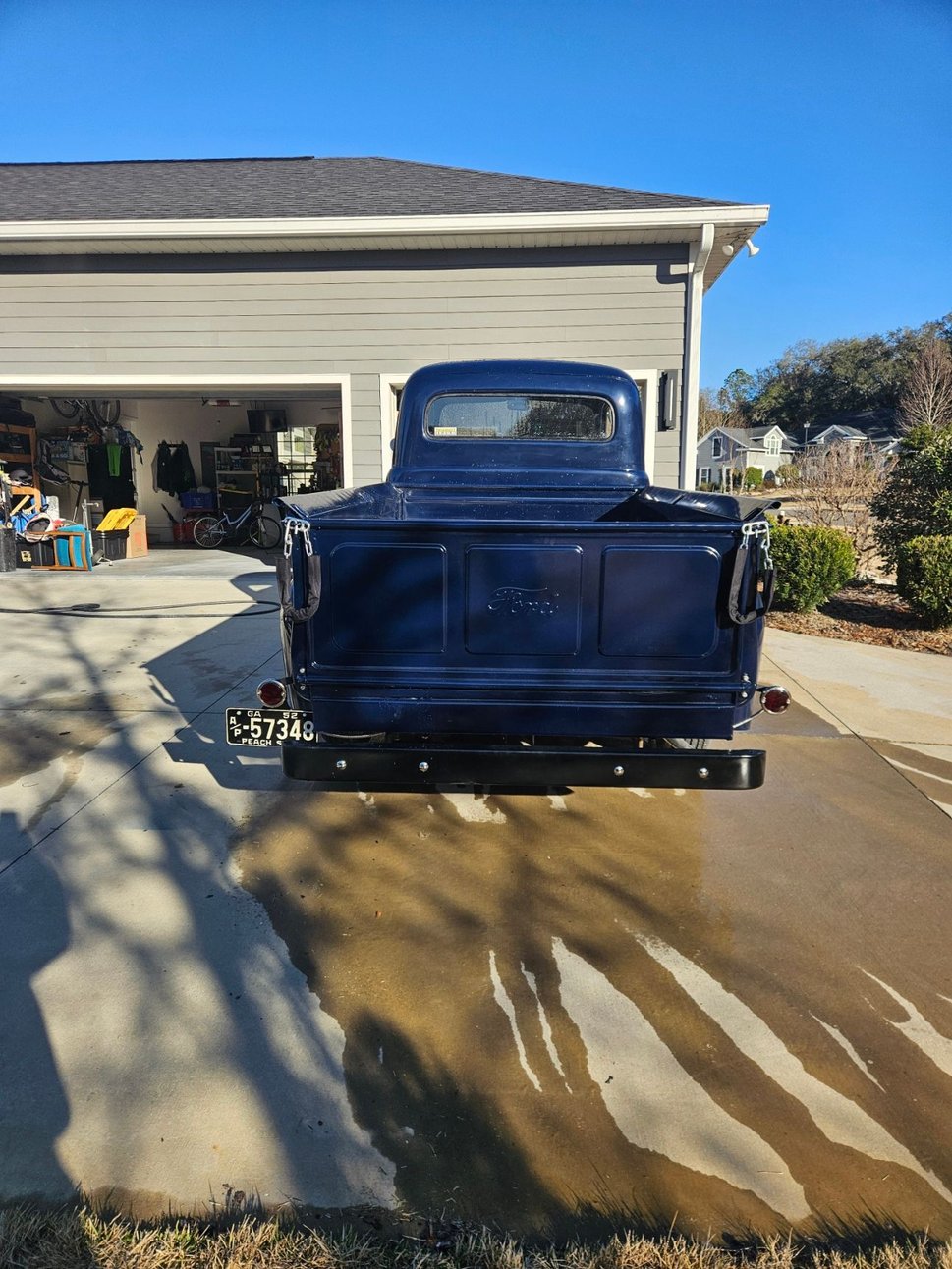

She's mostly wrapped up and I took her out to her first show this weekend. I heard a new saying that I totally agree with..."90% complete and halfway there". Yup...sounds about right.
The number of people who stopped to talk and tell me they were so glad to see that I had NOT LS swapped the engine and how much they appreciate seeing it "the way it should be" was HUGE.
Lots of folks using it a camera backdrop and telling stories...this happened to be a BBQ fest/car show so it was a blast!
