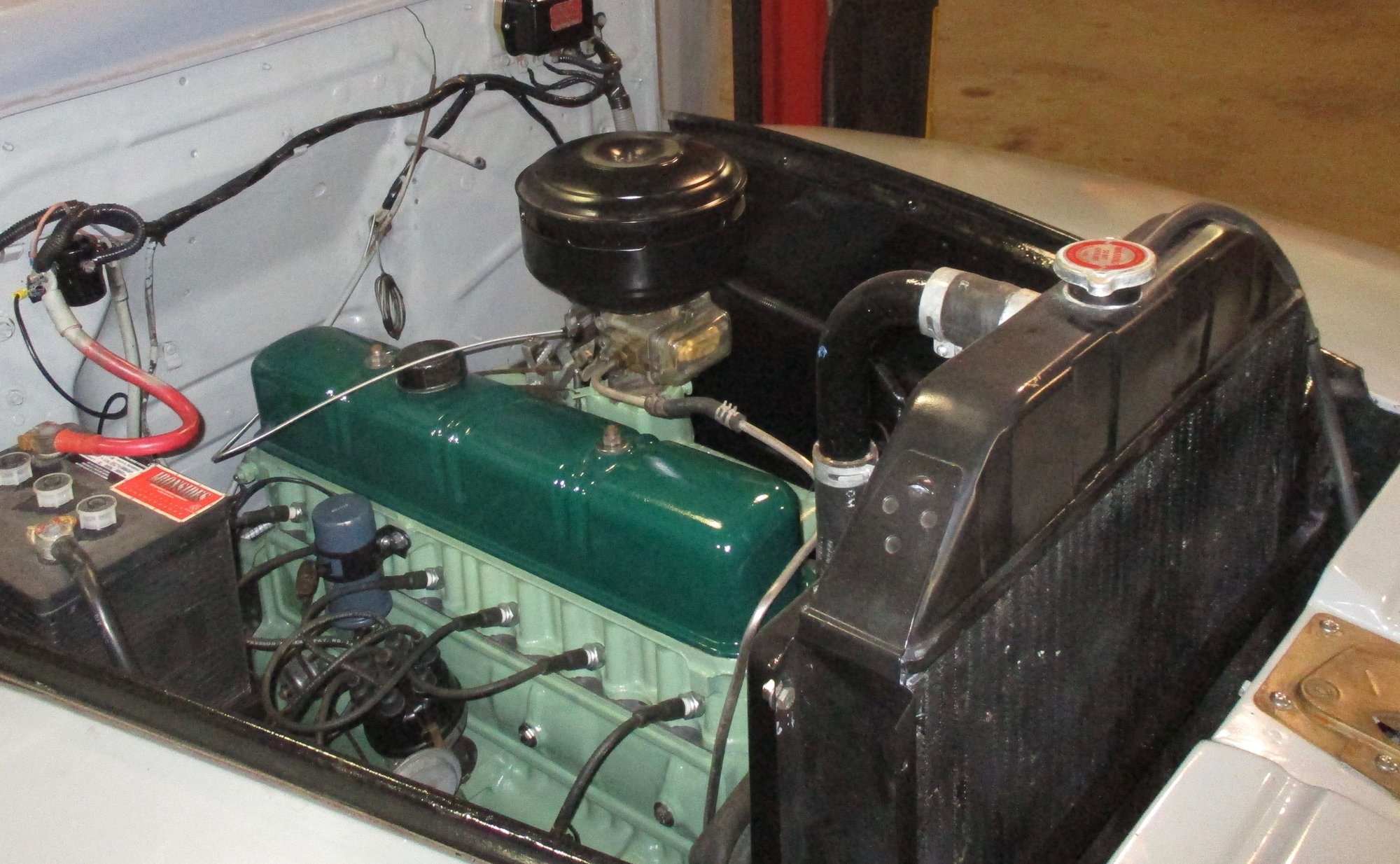

This is what your engine looks like under all the oil and grime:

As I clean this engine up, I have found the lower green. Looks like the Bill Hirsch Lincoln Mercury Light Green is the best match out there. However, the valve cover green does noes seem to be well defined. Best match by eye that I have seen is the Rust Oleum 2x Hunter Green.
Does anyone know if there are official color codes that a paint shop can match?
And was the 4 speed just painted semi gloss black?
Thx!

Dupli-Color DE1617 and DE6144 are good readily available choices for the engine block and valve cover respectively.
Your transmission was likely bare cast with large yellow 4TA stenciled on it similar to this:

I cleaned up my valve cover and took it to a shop that sells automotive paint and had them do a color match to the existing paint. The light green engine color is Bill Hirsch Lincoln Mercury Light Green. Bmoran4 is likely correct about the transmission being bare cast metal. The bell housing, however, is painted engine green. During the restoration process, I replaced my transmission with one acquired from a member here, and it was painted gray. My original though does not appear to be painted.
