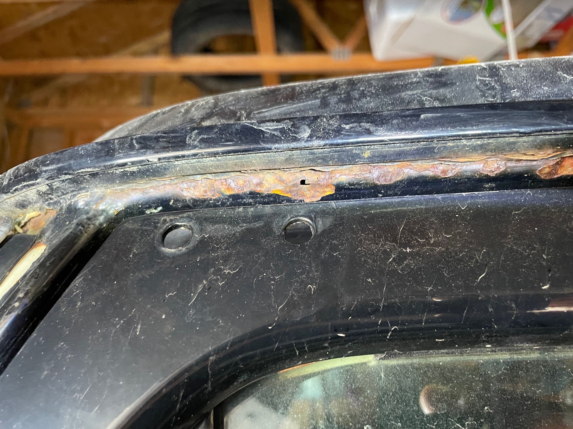

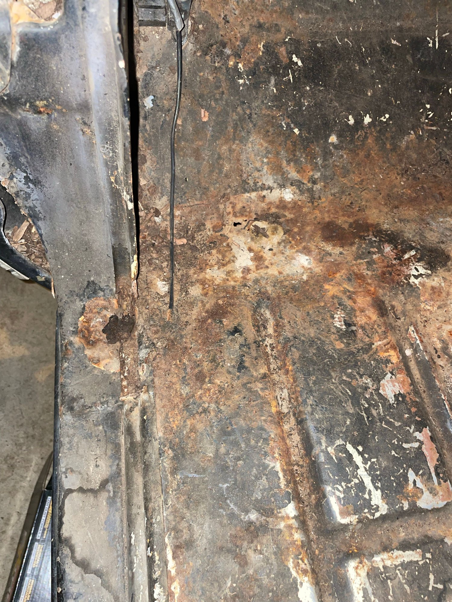

Made the mistake of leaving my 70 F250 CS stored outside for too long. Got some rust perforations on both sides under the drip rails and the cab mounts and parts of floor are bad. Looking for some opinions on what to do. I’m not opposed to diving in and welding but I’m thinking getting a cab from the SW would be better if I can find one. Otherwise it’s a good running 390 .030 over recently refreshed with newer C6 new exhaust & brakes.

Replace the cab mounts, patch the rest and go! :-)
...then again, I am always for fixing, rather than replacing, but being over here in Sweden, I don't really have the option :-p

Thanks for your opinion Obscure. I see some really good looking old rides in Europe and I wonder how people make a go of it finding parts there. I’ m going to take a “crash” course in autobody/welding at tech. College in a couple months. Hopefully I can get good enough to make some progress. But,the parts swapper in me feels like changing out the cab would be best to get back on the road faster-if I could find one….

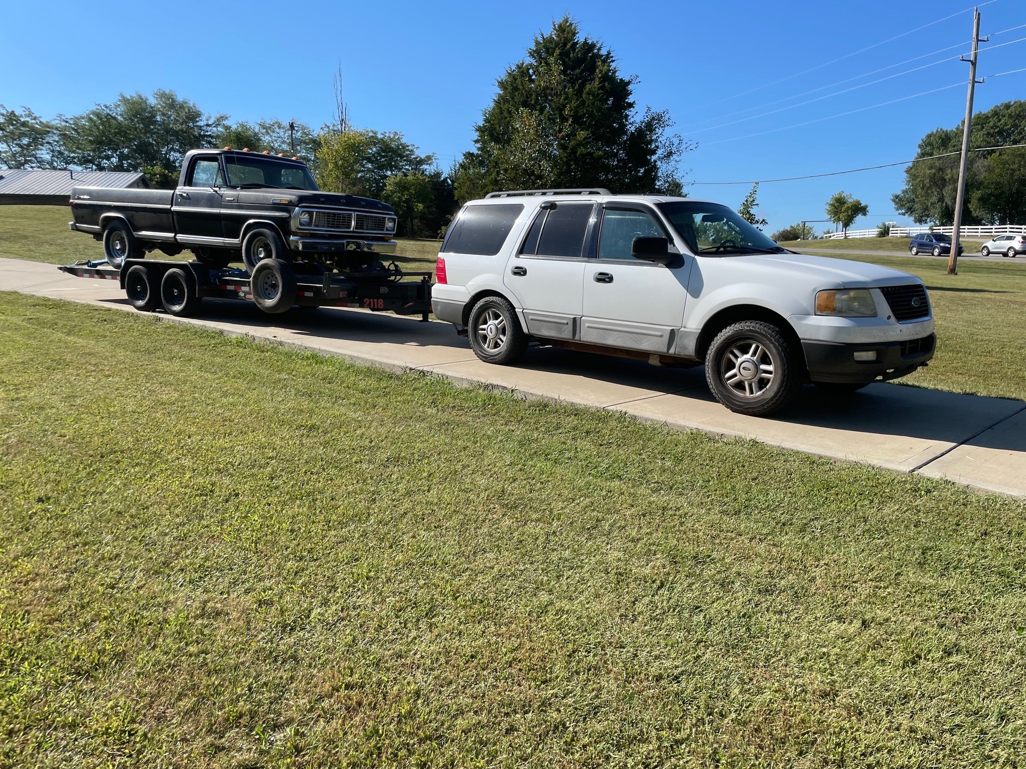

Thanks for the suggestions Green72! I can travel to get stuff. I will join the club as well. I have a decent running expedition with the HD tow pkg. I can pull a trailer with.
