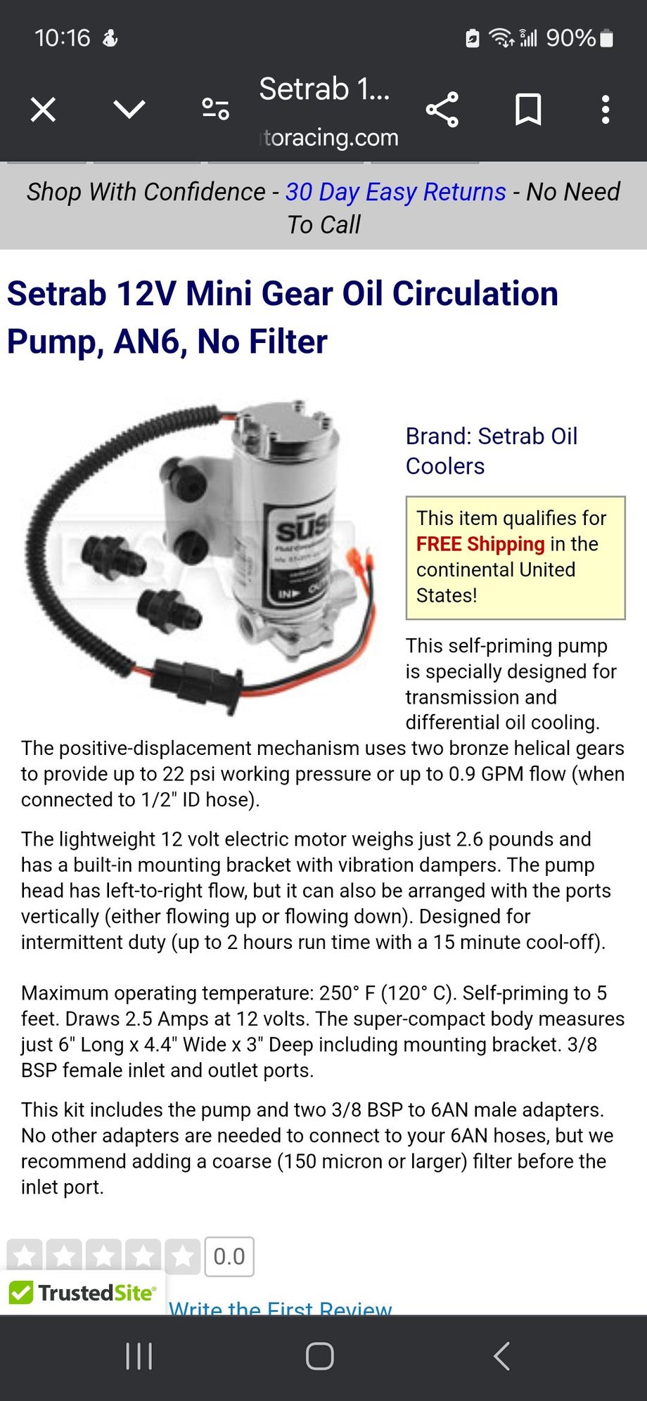

option 3. For the win
Ease of operation
10 psi switch, have it part of prestart stuff
Amp load of pump?
I had a surplus army tank, metal gear fuel pump
That boosted fuel pressure during start
Then shut down after 30 seconds
it had a duty cycle of 30 seconds on, 2 minutes off, 30 on, 2 off until 3rd run. 30 on 4 off
It drew 16 amps of 12 volt power
And would hold 60 psi
About as big as big as a can of coke
it had #4 fittings
might look at drmo sales or heck Google
it was perfect for what it was tasked to do in my world. This was long before we had the internet as our friend🤣
I imagine it would be an easy find now days
boom

The one in your photo draws less than 3 amps ….thats probally not startup amps
the on in your photo is 250f max temp…I would go with a higher temp rating
yup they have them in various temps etc
250 is pretty..high
It might not be an issue using pump at pre start
then once its shut down.
no hot oil is running through????
Definitely not mount pump near exhaust
https://cdn.shopify.com/s/files/1/02...f?v=1632944930
looks like apm load is correct, they recommend a 5 amp fuse
