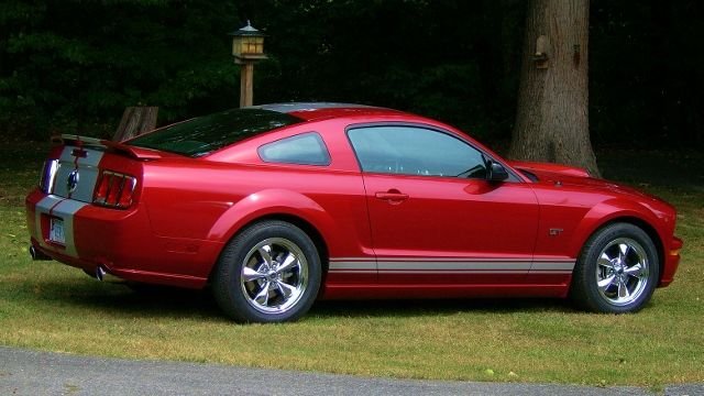

Not on a truck, but these are on our Mustang, 17"x8" American Racing Touque Thrust M with 235/55-17 tires. As best as I recall, these are 30 mm offset, but they have them in deeper looking 00 mm offset too I think.
