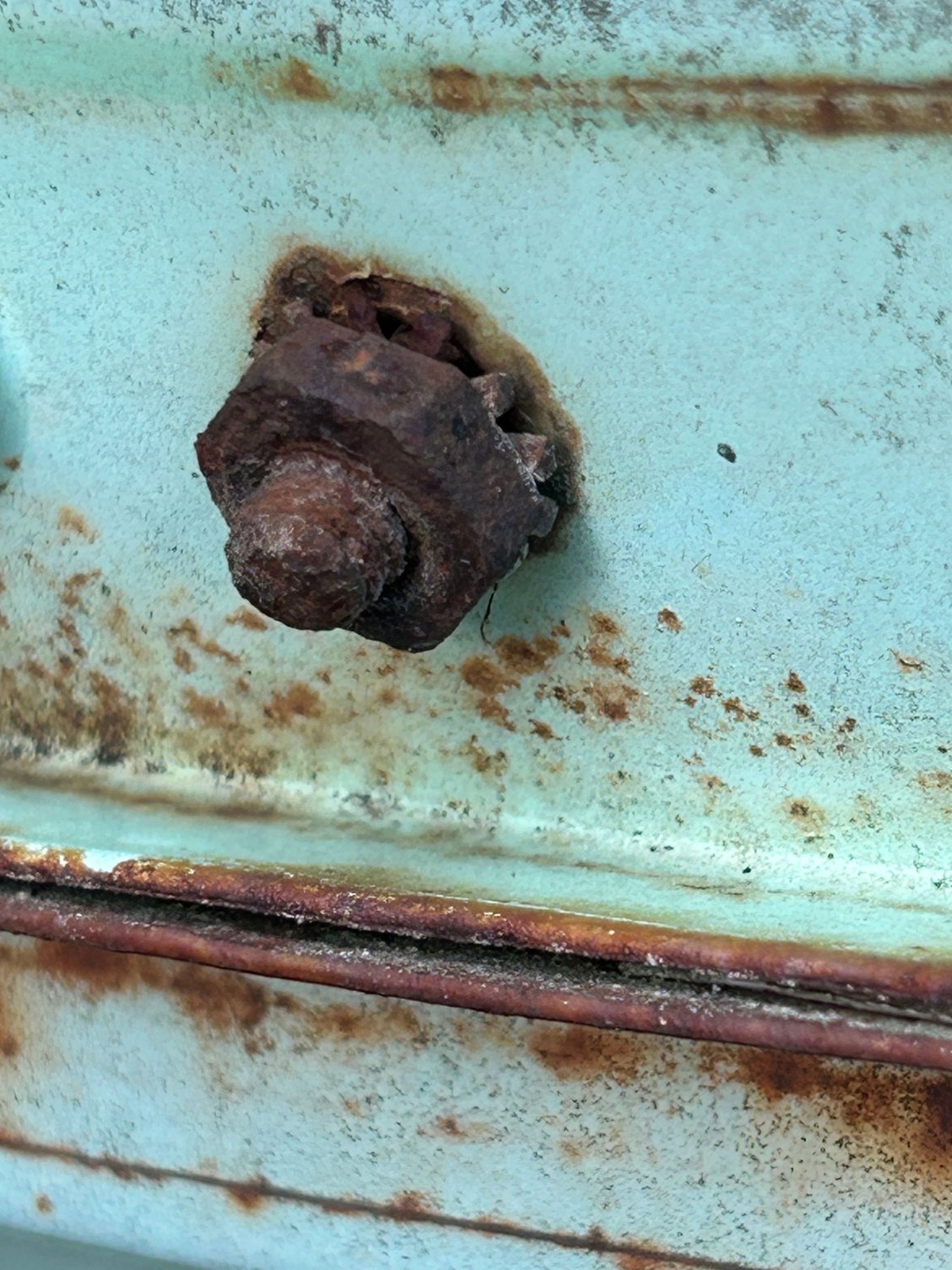

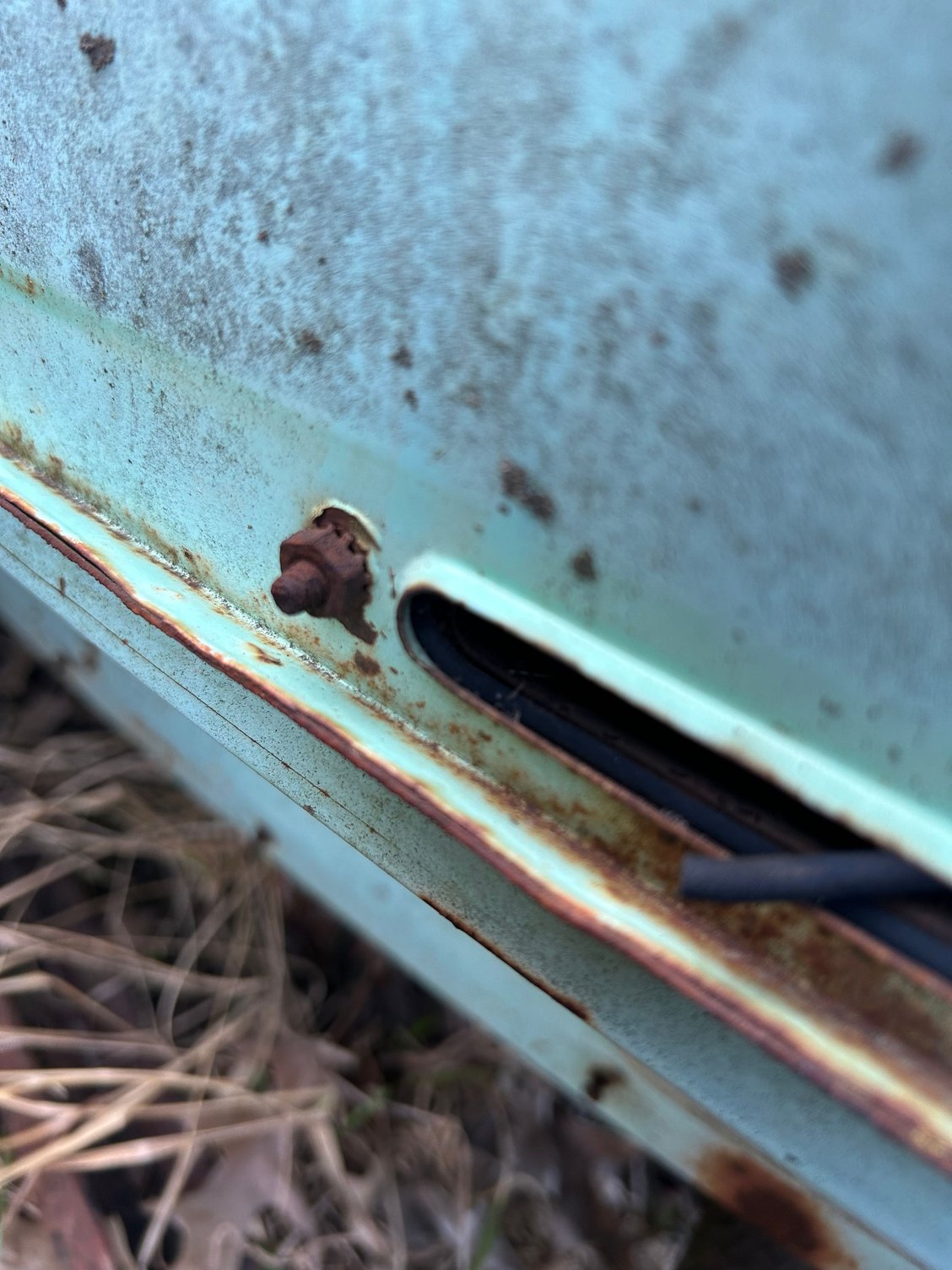

Never seen a lock washer on any I've had and they aren't a usual piece that gets removed for any reason..
always have the star washer integrated to the nut

Not on any I have Kevin..or the ones I have on the ones off this Mercury. Could have those on the pickup and panel but not curious enough to go check...lol
