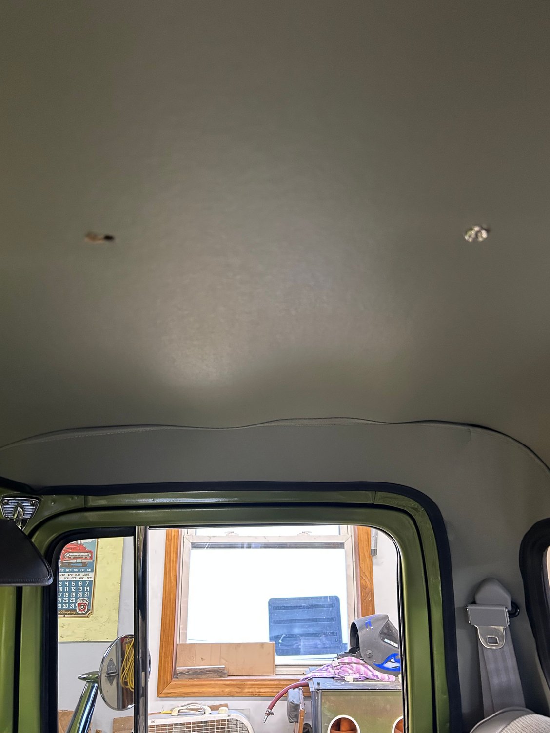

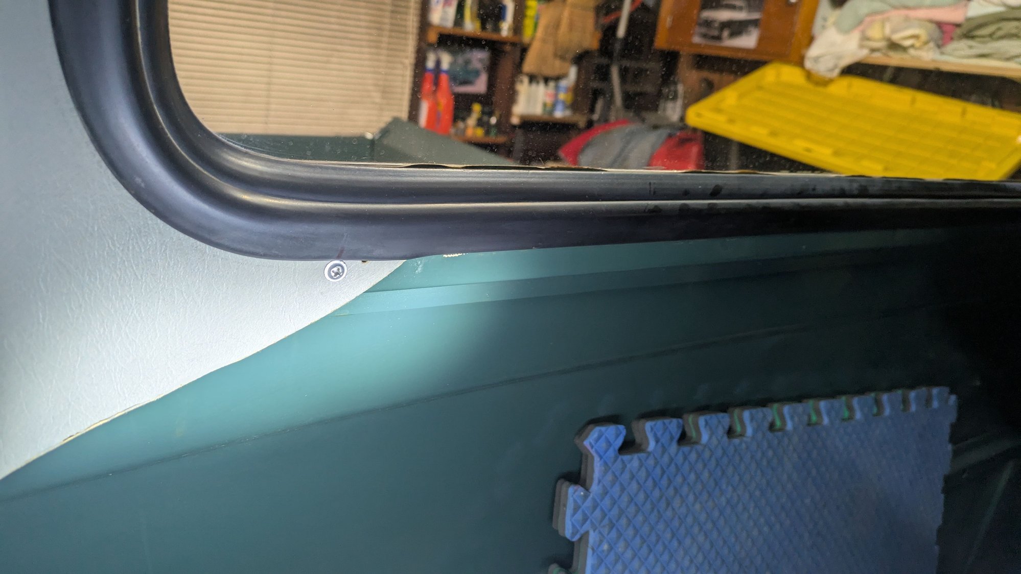

Here is a picture of the problem areas. There is also a1/16 gap on the sides of the rear window. I put a small slice of rubber over. I am still confused why one shows two holes and the other three holes. Dean

You could drill a hole in the support piece where the holes are in the cardboard and put those large headed screws in.
It doesn't look that bad really but I know it will bug you since you know where the flaws are. When I put my headliner in I had to trim cardboard around the driver's side of the back window. And I have a crease or two.

Because I tore the front hole I have a fender washer under the upholstery washer painted the same as the roof panel to cover the hole. The ripples you can see in the pic are on both sides but not the middle. If I had trimmed the front of the panel to make the screw holes fit, the gap at the rear window would have been a lot more.I think the side panels should have been back about 1\4 in. I have a couple creases too.

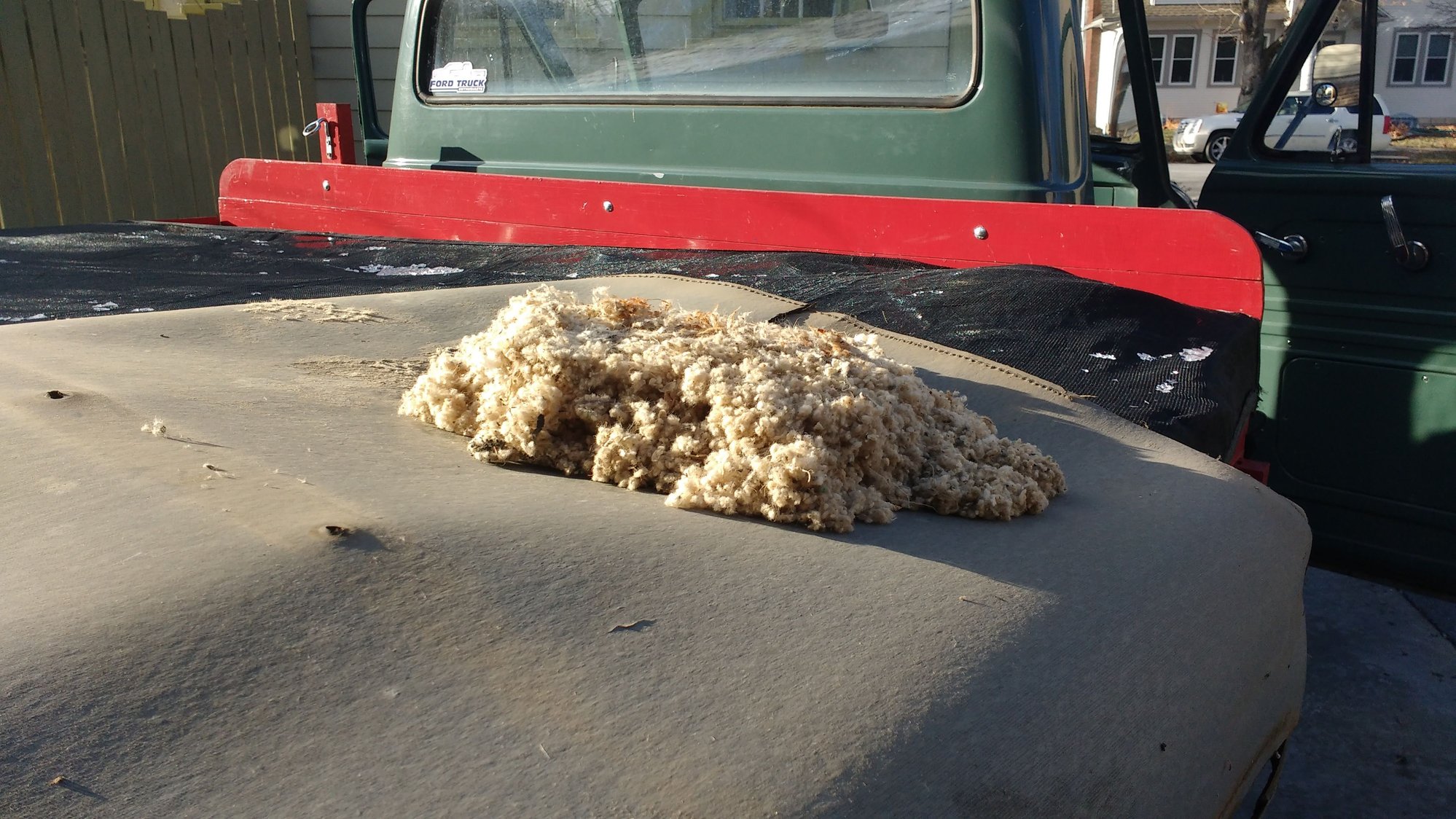

Here are pictures of the headliner brace on my very original 55 F350 and the original headliner. 3 holes in the headliner and 3 holes in the brace!
The 1955 headliner with 3 screw holes in place before removal.
brace with 3 holes for headliner
another pic of brace. The stuff hangin from roof is not insulation. This truck was a Standard Cab with no roof insulation. It is a mouse nest.
healdiner in the bed of my 54 F100
huge mouse nest on the top of the headliner. This is why I removed the headliner and why the headliner was cracked
Close up of the original headliner. Original factory kick panels, headliners and I suppose door panels on Custom Cabs had a grain to them. They were not just a piece of gray painted carboard.
comparison of the original kick panel and a repopo. After painting of the 55 I put the original kick panels and headliner back in because of the grain.
repaired headliner back in with new rubber gasket holding it in:
see the crack from the heavy mouse nest? I glued ceral boxes on the back side to hold it together.

I went out to the garage to look at the repopped headliner in my 54. I bought it at Carlisle back in 1999 to save on the shipping costs. I don't remember what dealer I bought it from.
One (1) hole!!!!
Here is a spot where I trimmed the cardboard, not so well.
It doesn't look as bad as it did initially because I added screws to both sides to hold the cardboard in place . There is a hole in that part of the cab. I got a small paper hole punch to make the hole in the cardboard.
