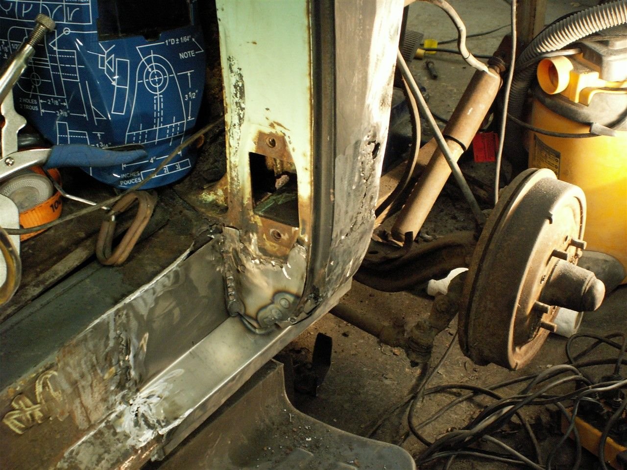

Old Mar 18, 2025 | 03:33 PM
Old F1's Avatar
Old F1
Joined: Feb 2008
Posts: 2,795
Likes: 129
From: Windermere Valley,B.C. Ca
By back supports are you talking about the rocker panels? They are what closes up the back of the cowl panels..
What rocker panels,I don't see any ? (drivers side)
Yes, it's rather pointless to install new cowl panels without repairing what's behind them.
I looked at the repo cowl panels but a little pricy just to use the bottom part, plus exchange, plus tariff. This is just going to be a summer daily driver / go for ice cream truck so I tackled the repair. Had to guess a bit on the bottom curvature but with some bondo it will be just fine. Not sure what to do where the inspection hole was yet. (pass side)
