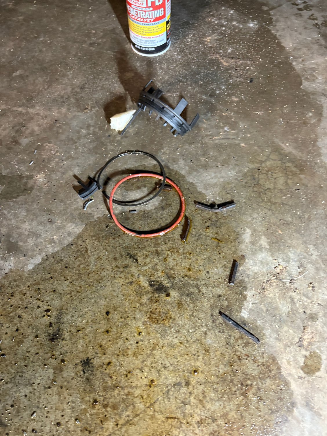

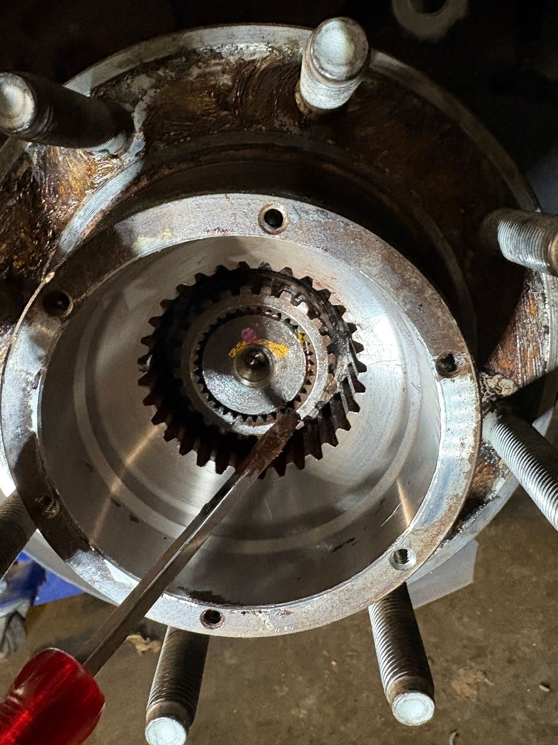

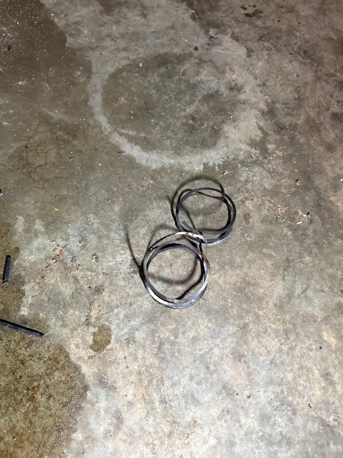

What a mess, but I think I found my issue. Now just need advice on how to fix it. Looking hub was severely damaged/ broken and now part of it is stuck on the axel and I’ve tried everything but dynamite! Any ideas on how to remove this?
This is the piece I’ve got to somehow remove..??

Another reason to NOT go back to stock hubs.

Put some heat on it.
