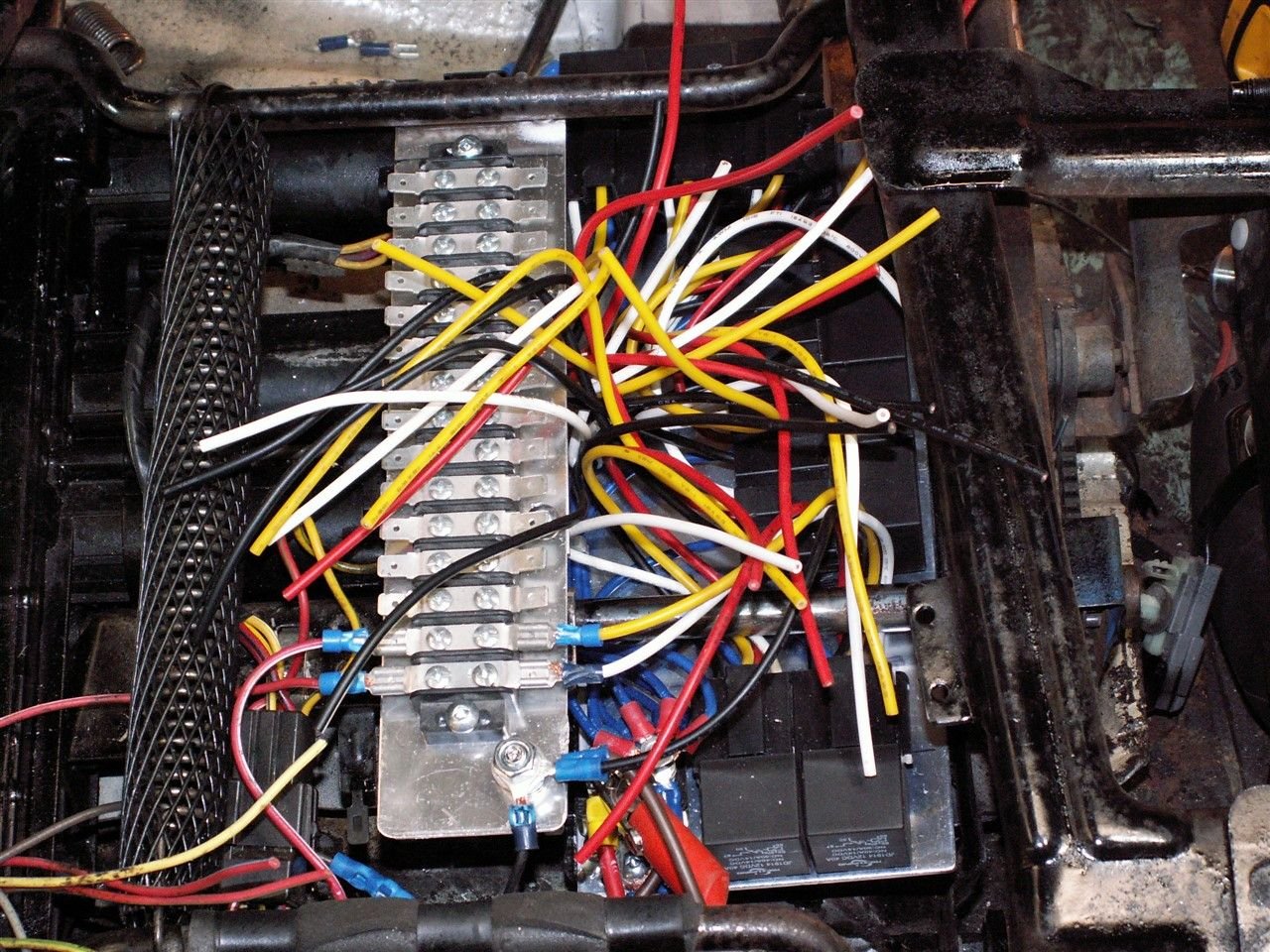

Now, should the seats be operational all the time (OEM style) or just when the key or ignition is on ? I like the seconded choice for safety reasons but have mine hot all the time (with a master shut off switch). During the build there are times when the seats have to be moved for many reasons and it is more convenient to only have to use the seat switch. Pictures for no reason, my '51 f1 and a other make.

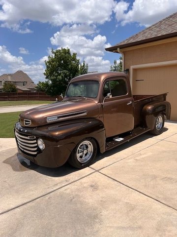

Thank you all for the information. I now have what I feel is a good and safe way forward. Will use fuse and relay as suggested with the relay running off the ACC from the ignition. Your suggestions and willingness to share your experience and knowledge is greatly appreciated. Here is a picture of the truck that you are helping me finish.

That's a nice looking rig right there!

That's a Cars and "Coffee" truck! Cappuccino to be exact. White interior would add a little a extra foam on top!
Truck looks great. Well done.
