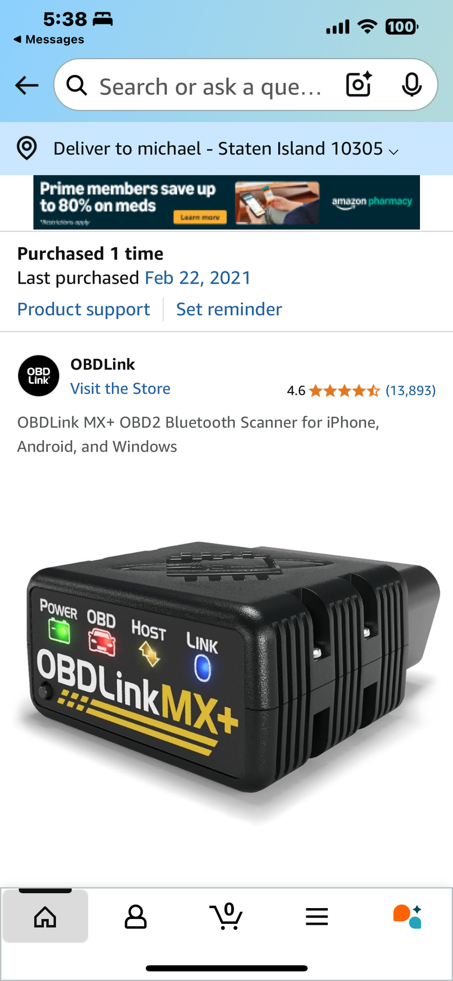

I currently do not have a way to monitor my EBP, but I have read about that being the culprit with other people with similar issues.
