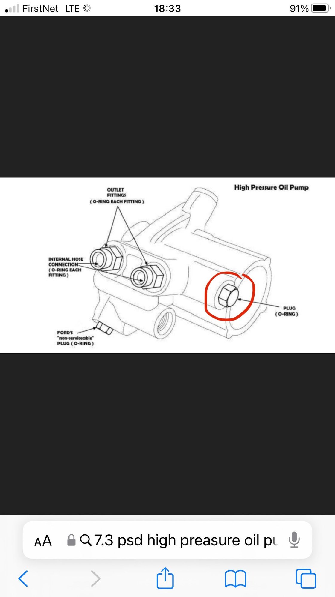

HPOP Leak
‘00 7.3 PSD.
Found the plug on the rear of the HPOP is leaking. Anyone know what size o-ring it takes or is it a flat copper washer. Not going to remove it until I can properly fix it.

Reading about this plug on another site. Now I have some concerns. Can the plug be removed / reassembled , while on the engine, without losing parts? (a check ball was mentioned) It was even mentioned to put some heat on it first. Anything I need to know before I try to remove it?
no issue doing it with pump on the truck, the other non-serviceable plug is the one that cannot be.
a little heat can ease removal and save threads of the aluminum housing. Then just clean it up, new oring, some sealer, and seat it in. I think the torque spec is 21-23 ft lbs, biggest thing is seat oring so fitting shoulder is flush to pump and do not go wild on tightness

Thanks for the info. I just watched a video that showed the “non-serviceable” plug. Glad to know it’s not the same one I have leaking. As soon as I get an o-ring in hand, I’ll remove it and reinstall. Thanks again!
