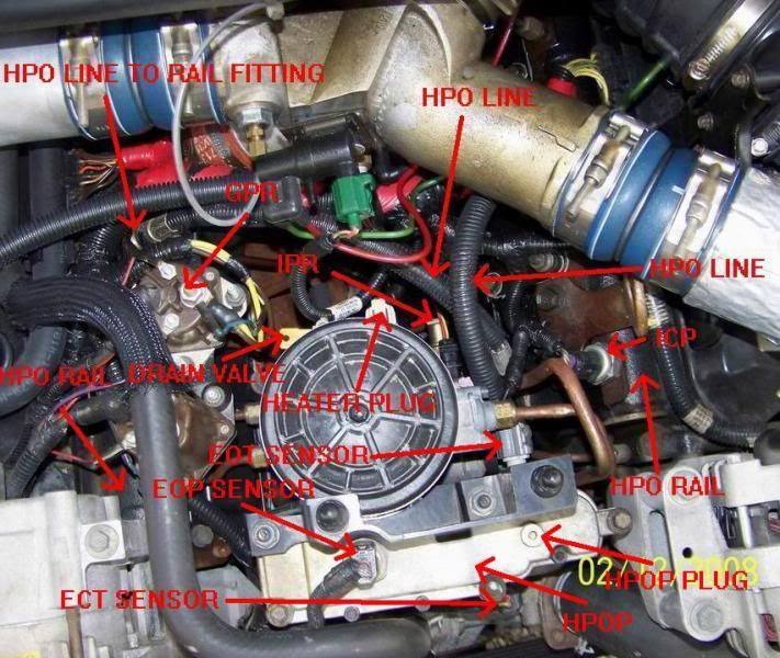

Originally Posted by Duckwalker
and was directed to take the icp sensor out and slightly crank over. If it has oil then it's good.. if not it's bad.
Yeah I'll stop you there before the oil geyser
You don't ever remove the ICP sensor and crank the engine unless you are 99.999% sure your hpop is dead.
However, you can unplug the ICP sensor's electrical pigtail and crank it. If the engine starts when it previously did not then you know the ICP sensor was bad.
If you did remove the ICP sensor and cranked the motor over and you do not have an oil geyser then your hpop is dead, but there's much better ways to find that out that won't require a full day of underhood cleaning
Just in case there is confusion on ICP/ IPR sensor locations
