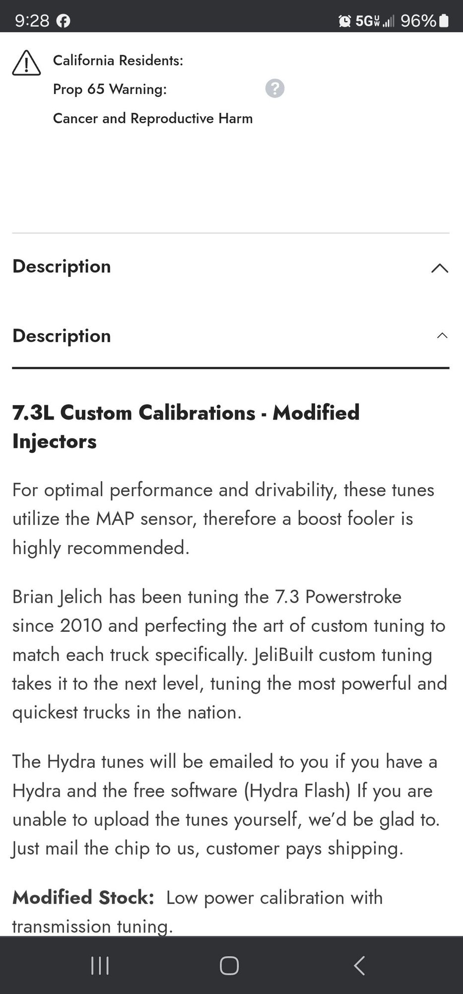

a boost fooler is exactly that..it only lets the computer see a max boost of 23ish psi IIRC so the truck won't trip a code/ light for overboost. I have the riffraff boost fooler but it's not needed. all that can be taken care of within the tuning.

if you have a Hydra, no Boost fooler needed,
it will never get past 21 psi of boost, the max I ever saw was 23 and that dropped to 18 real fast.

Here is why I asked about the boost fooler. This is from Jelibuilt's website. I do not get any codes when building boost thankfully.
