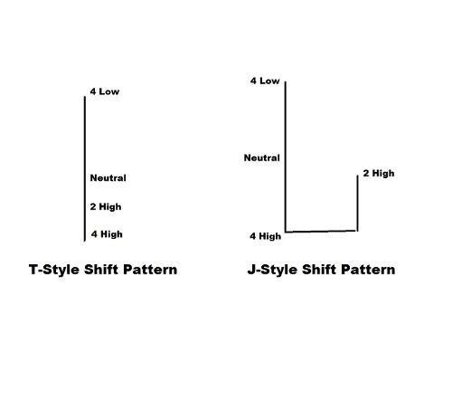

Also is the Dana 20 transfer case a T or J shift pattern? Looks like a T shift with the 2 tabs (one per shift rod). So that equals easy to twin stick, just so you know.
