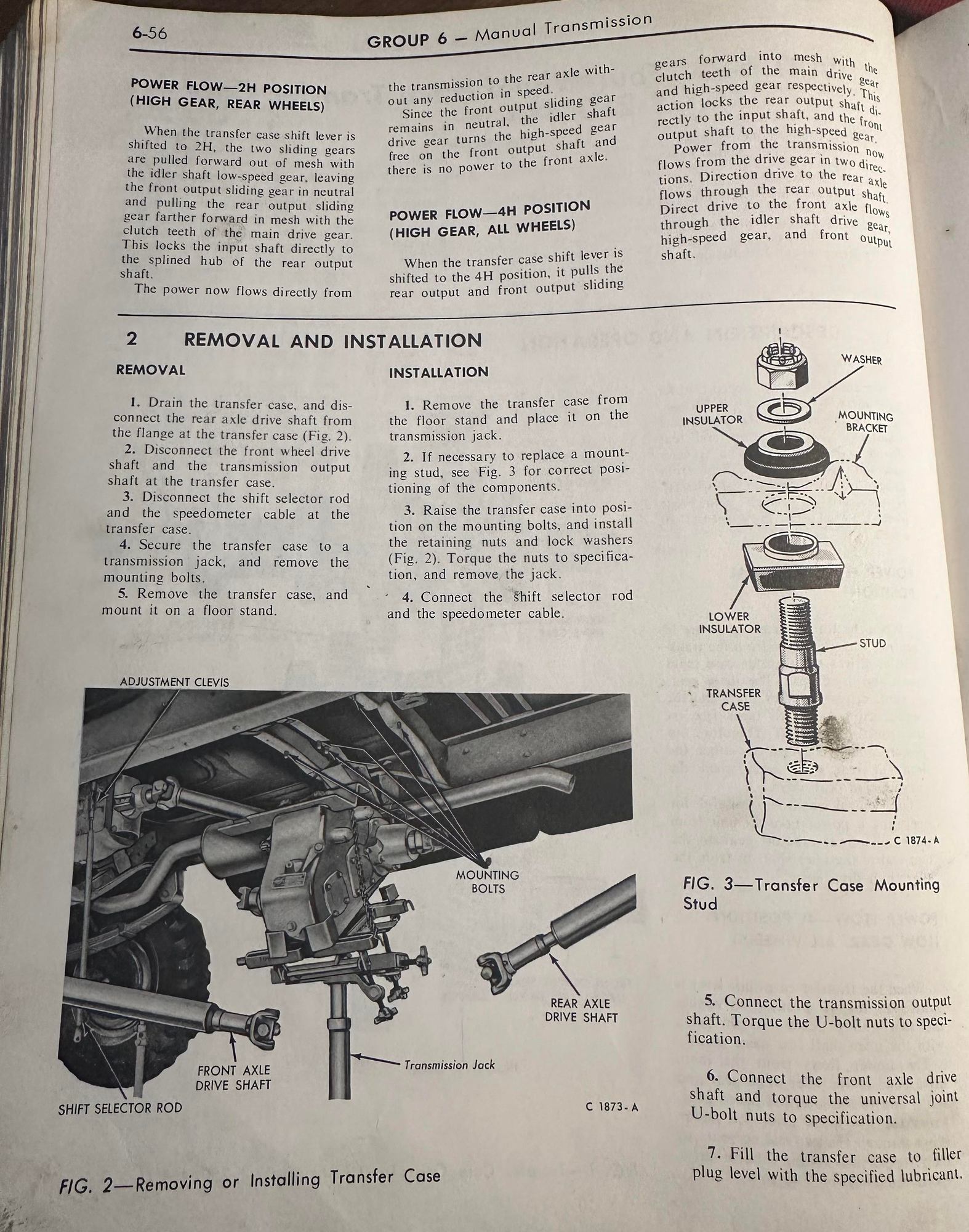

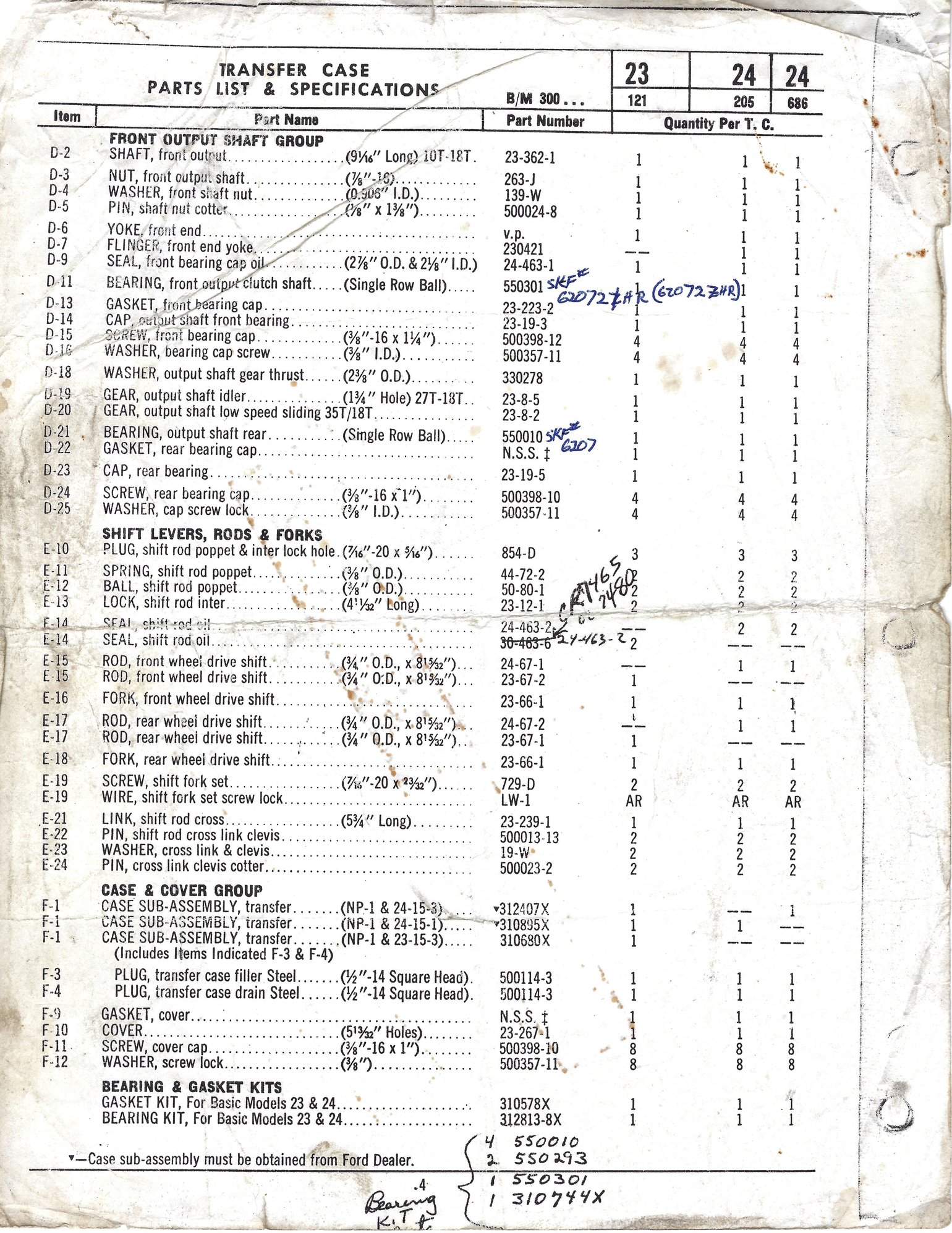

Ive been going through my old documentation collected over the years and figured Id make available for other folks. Sorry for the dirty pages...these have been through a couple rebuilds since the late 1970's when my dad collected them. Some of these parts lists and bearing numbers I really have not seen online any place yet as they are Spicer documentation and not Fords shop manual info.

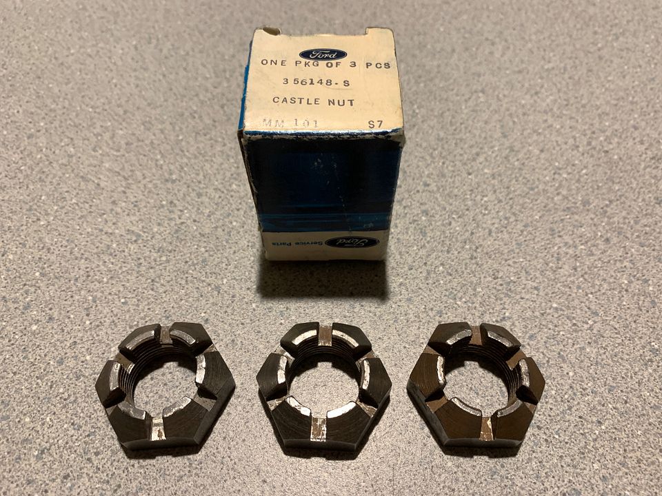

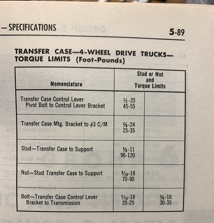

1961 (Dana 24 only transfer case used) Ford Truck Shop Manual has a section just for transfer case torque specs but of course nothing about the flange. I think I used 125 ft lbs.
356148-S (MM101) - Nut (flange to shaft retaining) - 7/8" - 16 hex. slotted

Same issue I ran into with the 64/68 shop manuals. The NP205 is well documented online and has a very similar design, ball bearings, bearing retainers. I went with that models torque spec which is 90-130ftlbs. I start at 90 and increase until the cotter pin aligns correctly.
