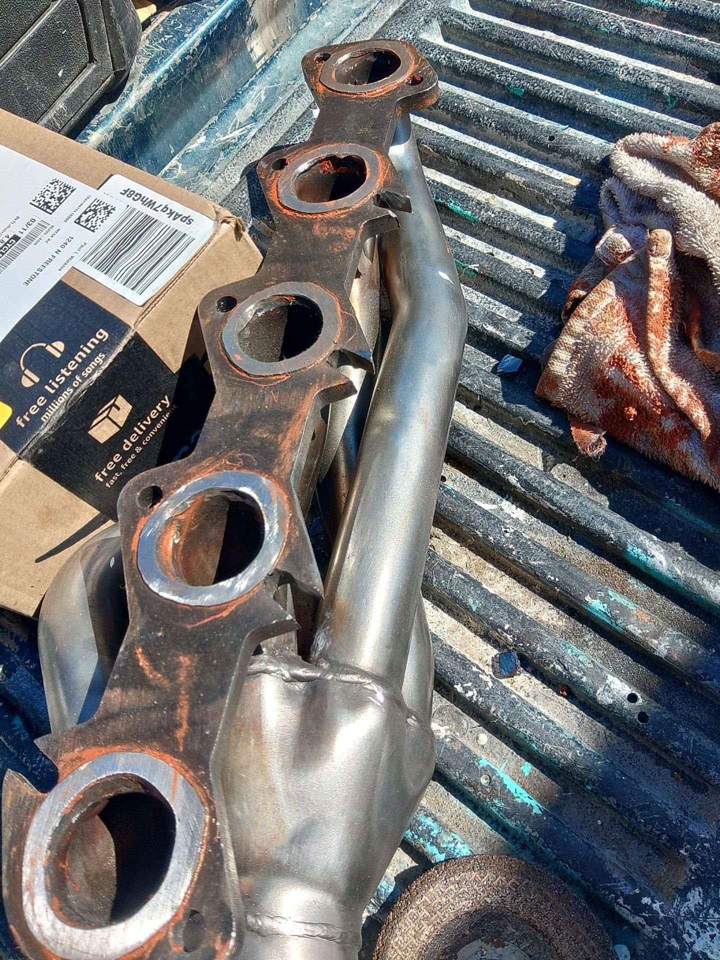

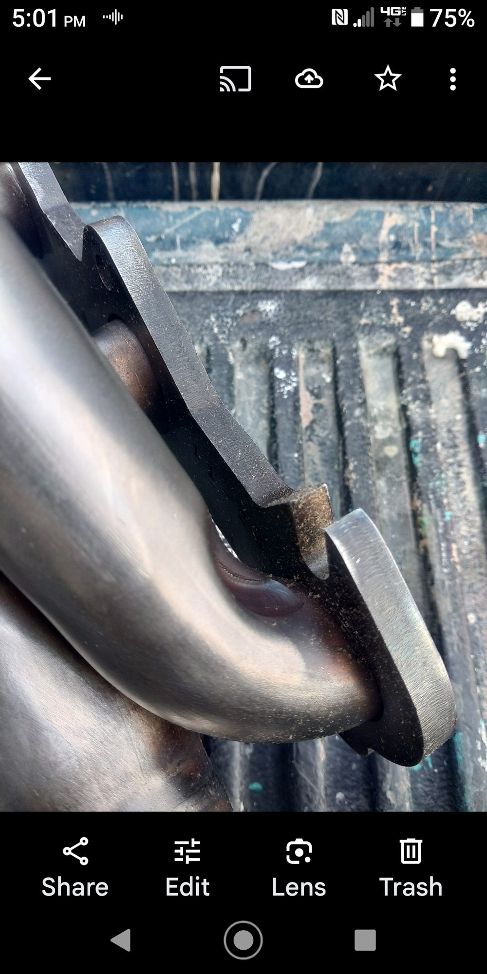

I finally got it done. I was unable to use the weld a nut method successfully. I believe I had the heat setting too high on my welder and ended up making a ball at the end which wouldn't let the stud turn. I ended up using this kit from Amazon to drill the stud and remove it. The passenger side header went on ok. There are a couple bolts that are a bear to reach. I used a 1/4" ratchet and a 3/8" stubby ratchet wrench. The driver's side was being a pain. The middle 3 bottom bolts were really hard to install. Not much room for my fat fingers. So, I decided to cut the header flange holes on the bottom so I could install the bolts then set the header in place. (I have seen other brands have these holes "slotted" as well so why not lol) This header also has a slotted hole and a dimple in the last tube for access. I was unable to get a bolt started there so I lifted the header off and installed that bolt. I then had to position the header on that top bolt then rotate the header down onto the bottom bolt. Success! There was one bolt that I could only use the open end of the wrench for a 1/8th a turn then flip the wrench over, another 1/8th turn and repeat, A LOT.
When I had the Y pipe off, I lined up the SPD Y and cut the oem Y being generous incase I needed to trim it. I bolted the pieces back on the collectors and cat flange. The SPD Y pipe fit very well. I tacked it in a few easy spots then removed the assembly. Welded it up on the work bench. It fit perfectly. Y still need to swap the muffler and tailpipe to complete the system,
Sound wise it is about the same for now. Seat of the pants dyno it seems more responsive. Can't wait for the muffler and 5 Star tune.
