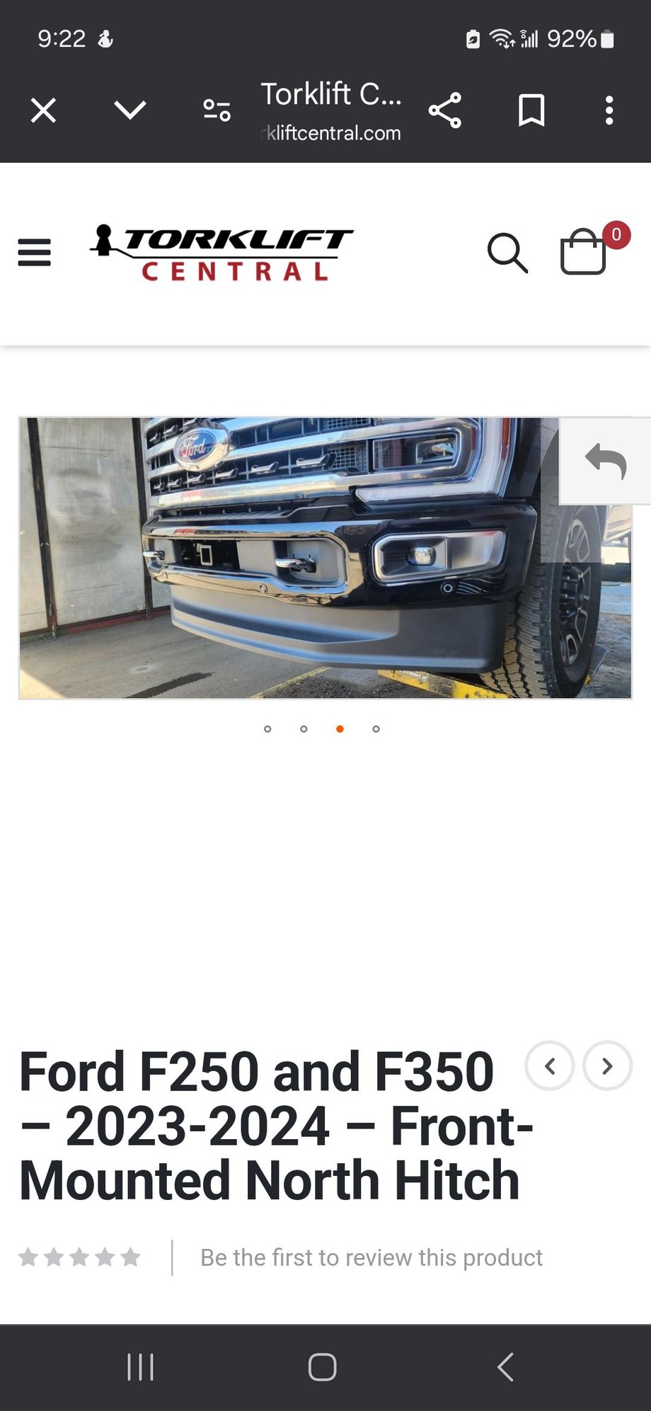

Torque lift makes a hidden hitch for super duty
1k tongue and 10k trailer.
I had one on my 21 250.
It s. Tube comes up and pokes out of the hole behind license plate..it comes with plate holder thst plugs into reciever when not in use
plus no loss of front end ground clearance
Under 500 bucks
I have one being built now for my 24
I used it to park my trailer, we have skinny road and a hard 90..so backing in is horribly time consuming
And you can do the badlands winch
Store in the bed tool box..until needed
https://torkliftcentral.com
