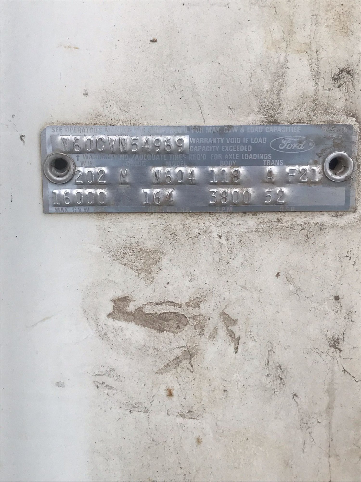

VIN DECODE
Hello everyone, can someone decode this vin for me please?
Thank you

N60 = LN600 gas
C = 330 2V MD FT gas V8
V = Kentucky Truck Plant
N54969 = 1972 numerical series, January 1972 production
202 = 202 inch wheelbase
M = White
N604 = LN600 gas, 16,000 lbs GVWR
118
11 = Medium OR Light Gray Vinyl
8 = Standard cab without butterfly hood, cab and chassis vehicle
A = New Process model 435 four speed transmission
F21
F2 = Eaton model 15201 two speed rear axle, 15,000 lbs capacity, 5.83 / 8.12 ratios
1 = Ford 5,000 lb capacity front axle, without power steering
16000 = 16,000 lbs GVWR
164 3800 = 164 Certified Net HP @ 3800 RPM
52 = Dallas District Sales Office (Des Moines from '64 to '71)
No special order.
