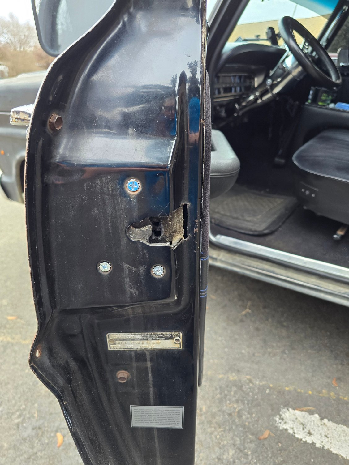

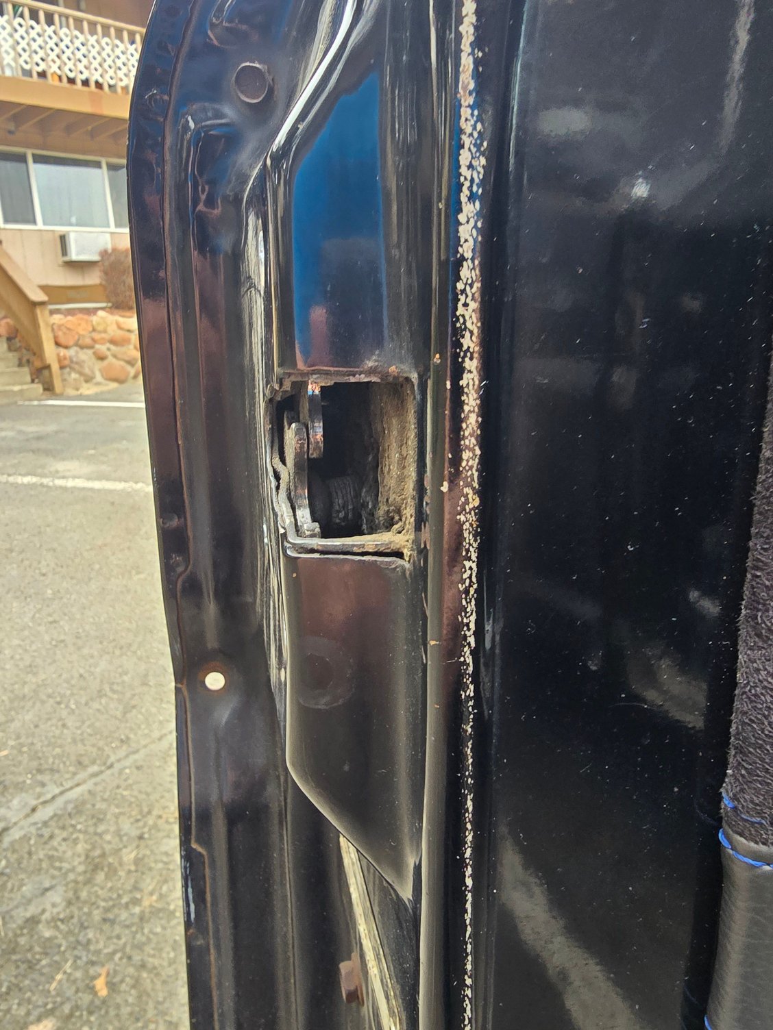

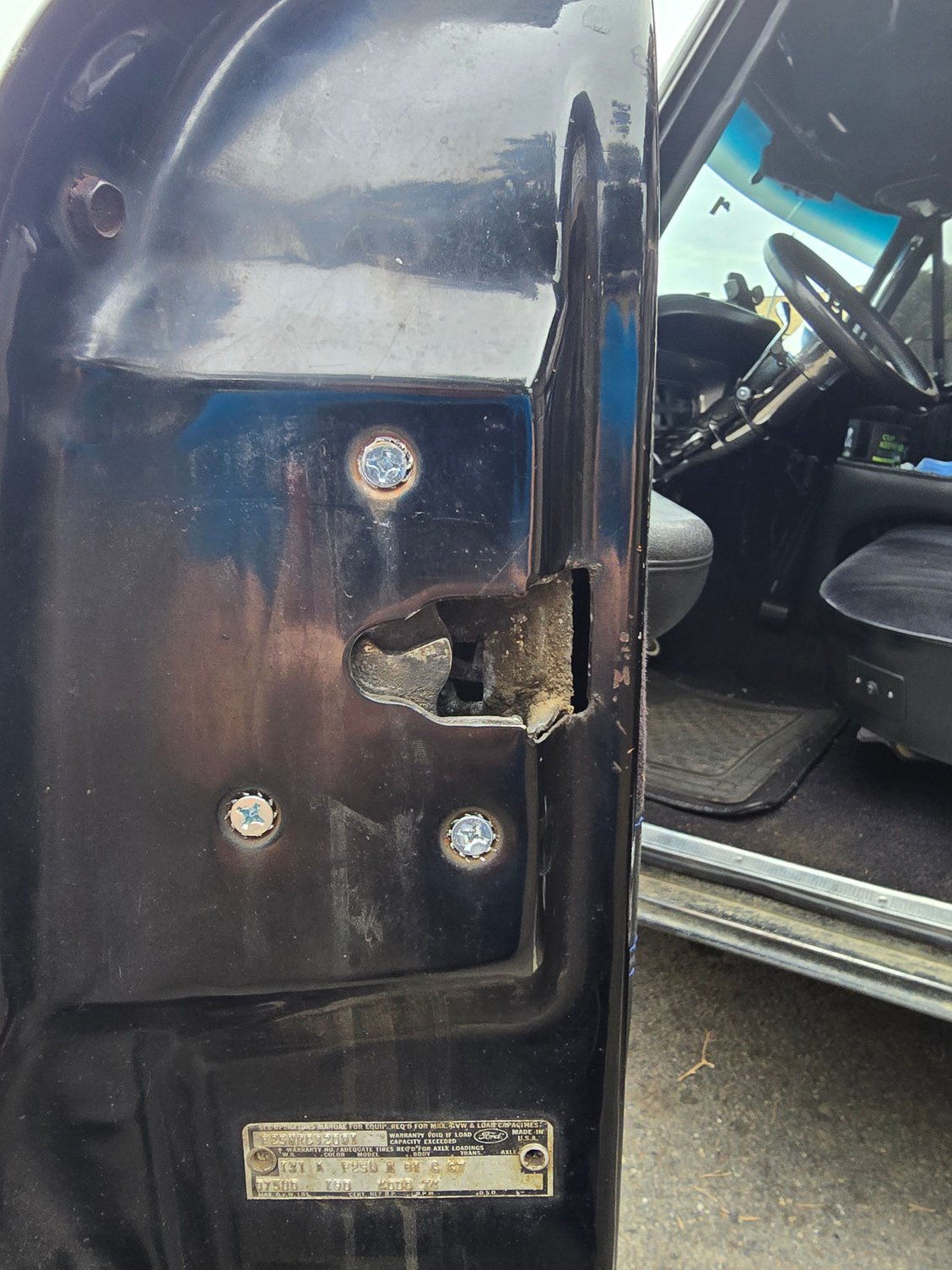

Hello all, I am looking for some advice on a
Door Latch Assembly on door itself for driver and pass side not the small one but the door catch on door
Keep seeing Bronco and Mustang assembly but I want to be certain I get the right ones. Not going the LMC route unless that is my last option.
Can anyone provide any insight as to a good part that will stand up from use???
I already have the striker pins to replace all at once

Is there something wrong with your current door latch assemblies? I took mine out and cleaned all the 50 year old dried up grease and re lubricated them with white lithium grease that you spray on. They work great now. I used a Purple degreaser in a spray can. Here is where someone used oven cleaner to get rid of the old grease, but you need to be careful when using oven cleaner. Lubricant for inner door mechanisms? - Ford Truck Enthusiasts Forums
