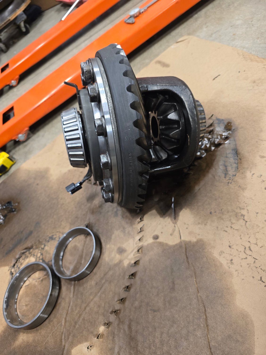

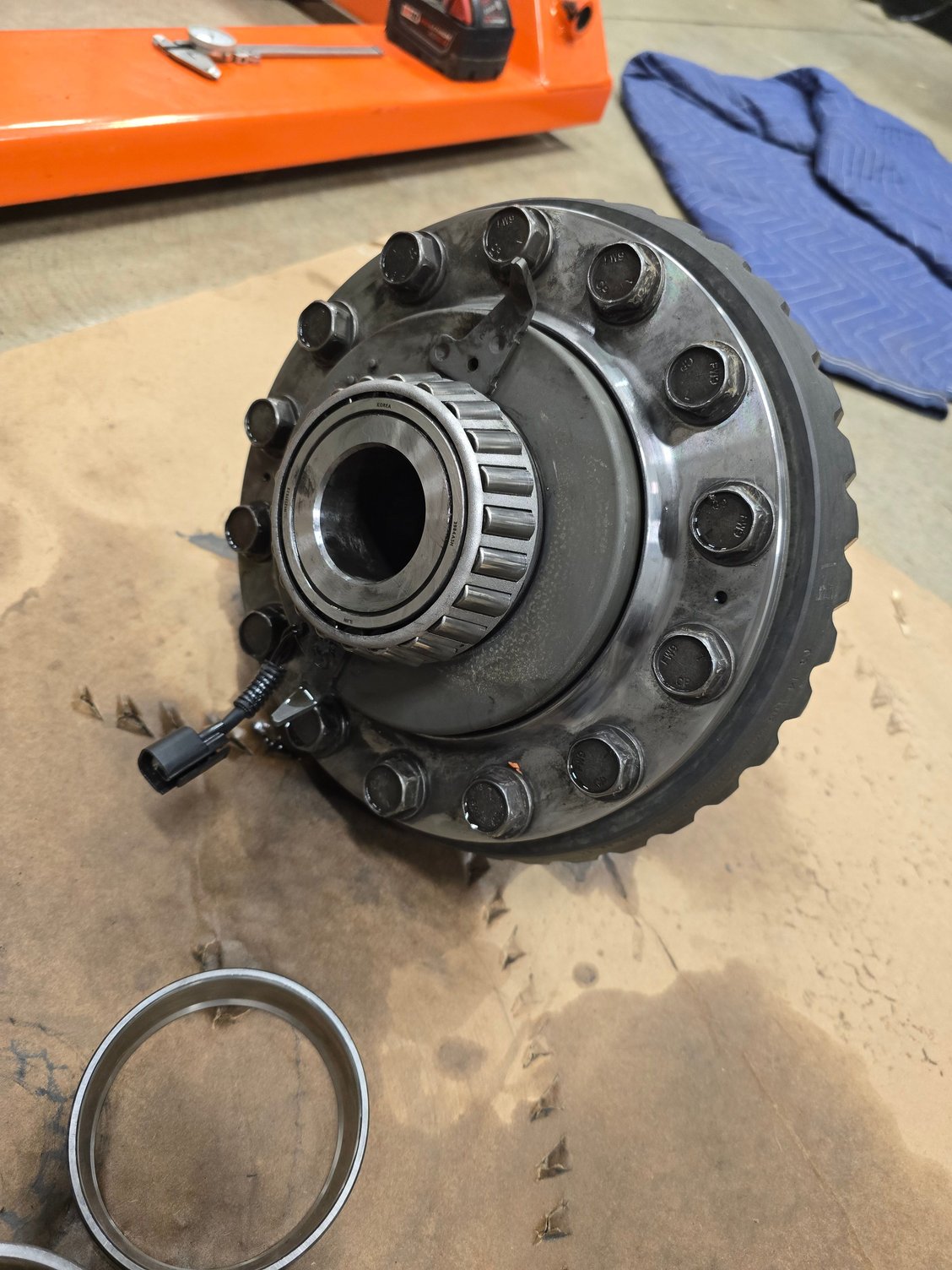

Hey all recently tried to get a factory ford e locker for my 06 sterling 10.5. Bought this locker supposedly out of an 2019 f250-350 thinking it would work. Obviously not understanding that year chnage wouldn't work. After research I now know what one i need but in order to sell this one I need to know if it is indeed a 2019 locker or close to in year range. Can't seem to find many much info on this one for anything sterling 10.5. Did ford change axle in later years?

Appears to be for a Dana M275 axle
