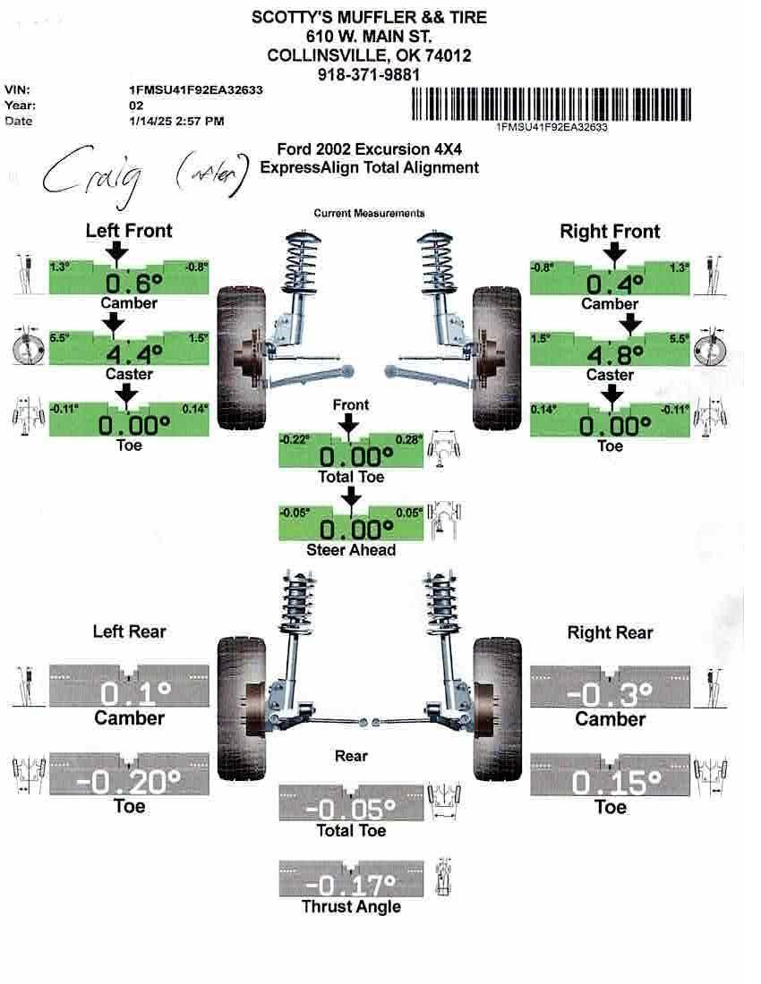

I had the truck alignment done a while back, ball joints replaced, new Steering Damper ( irked me, I just put a new one on it )
The caster is now near the FTE SUV advice at 4.8*
Driving home, I noticed immediately that I had to "manhandle" the steering wheel, to make it turn.
Today, 1st warm day since it was done, I drove around every little city block we have. Made a point of going slow, and doing Full Lock turns at each intersection. It will almost return to center, but lacks about 1/3rd of the steering wheel to get it back into the lane.

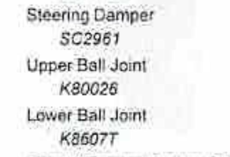

had to look at the invoice, here are the part numbers.
looked that up, it seems to be Moog.
O'Reilly is $73 each ( charged me $75 each )
Amazon is $28 each
https://www.oreillyauto.com/detail/c...nt/moo0/k80026

Moog isn't the quality it used to be. On ball joints I reccomend Spicer only. But little late for that now. I would see if they remember if they torqued them in the correct sequence. I don't remmeber exact number off the top of my head but you torque the nottom to x amount. Then torque the top to x amount. Then go back and torque the bottom to the final x amount.
