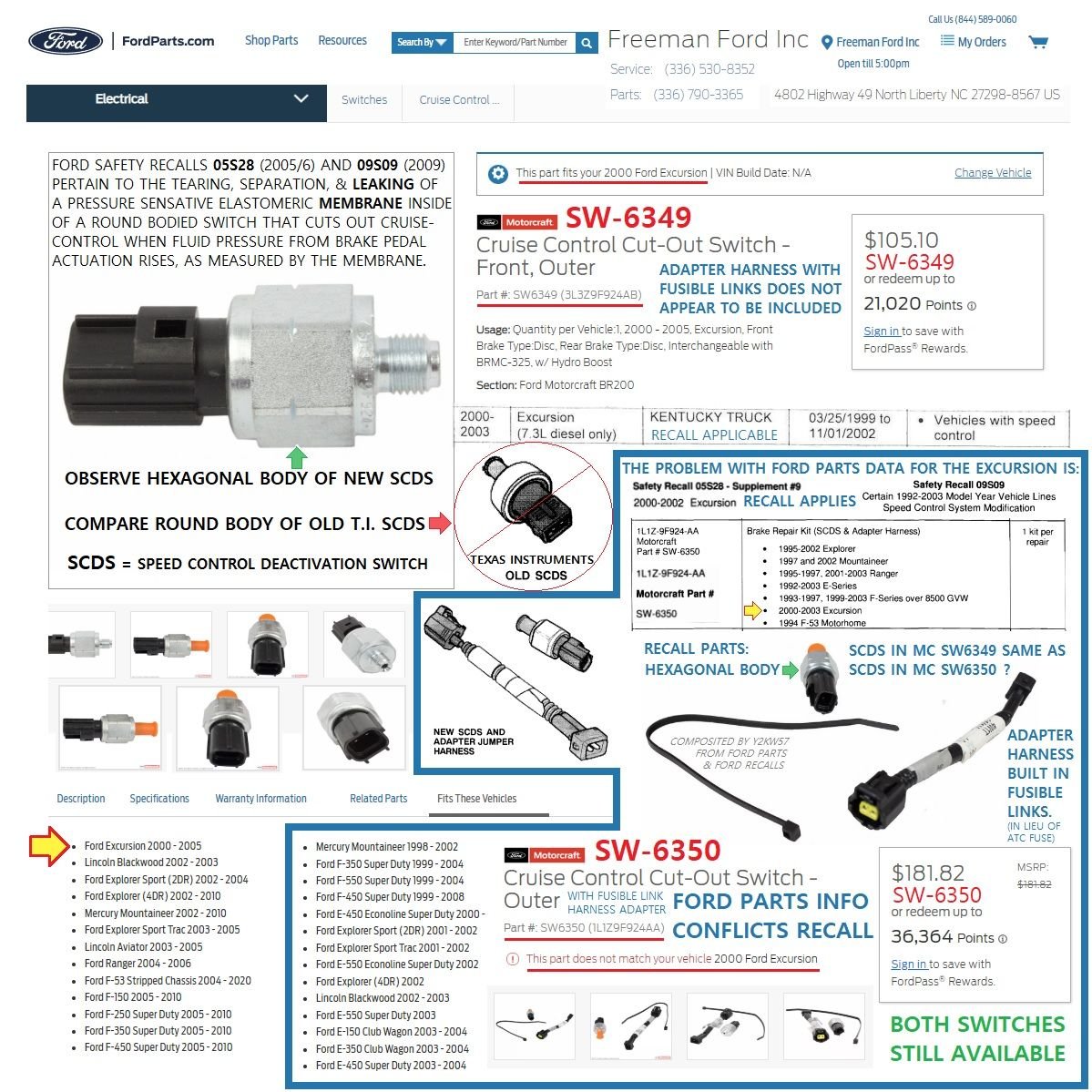

My 2000 Excursion has a brake fluid/cruise switch recall on it from 2005. I talked to my dealer, parts are no longer available for the recall.

According to the video, they could buy your Excursion for what the industry thinks it's worth. It's just a pressure switch, a type that has been in use for decades. It's easy to find in the aftermarket, but if you go that route, put an in-line fuse on it.

Dealer said to check to see if cruise works, it does and to see if brake fluid is leaking, it is not. He said if it was he could dig deeper.

The issue with the pressure switches is leaking brake fluid, which causes a short (electrical positive to switch body) and fire. The correction is a new switch and a harness with an in-line fuse. A fuse can be added to the wiring if the TSB was never done. A simple safety upgrade.

@Excurvelle
In reply to:
Old Jan 16, 2025 | 05:14 PM
Excurvelle's Avatar
Excurvelle
Joined: Mar 2010
Posts: 3,491
Likes: 451
From: NC
Originally Posted by Y2KW57
@Excurvelle
In reply to:
Cool! That is my dealer, I will contact him again. Thank You!!
