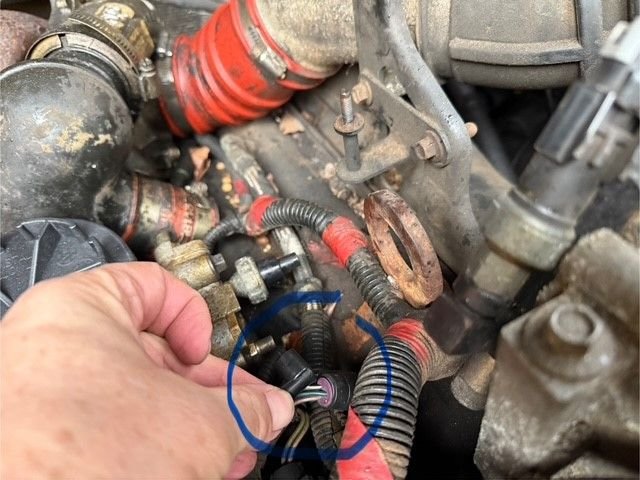

Trying to get my Dad's old 1996 F350 running again. He had not started it in about a year but it was running before.
The engine will turn over (once or twice ran for a 1-2 seconds) but never started running. It's located on the coast in Mobile and it was in the 40-50s when I tried cranking. Didn't see any connector for an engine block heater.
It looks like a squirrel had nested but I don't see any chewed wires.
There is one wire not sure where it goes (see picture). Any idea where it should go. In the first picture it is circled in red which isn't the right location since that is a schreader valve.
Can the engine crank without Fuel restriction sensor hooked up?

Any thoughts on these items?
  1. There is one wire not sure where it goes (see picture). Any idea where it should go? In the first picture it is circled in red which isn't the right location since that is a schreader valve.
  2. Can the engine crank without Fuel restriction sensor hooked up?

I'm not sure what those wires go to, but if you aren't seeing white smoke out the exhaust the engines not getting fuel. Easiest thing to do is add fuel to the front tank and see if it's the selector valve thats bad.
Most of those small random wires won't prevent a truck from starting. They'll cause an idle issue or turn a light on at most.

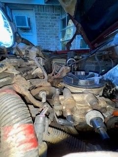

Anyone know what the sensor is that is circled in yellow (see images). No wires are connected to it presently.

Found a thread that talks about that. It appears that sensor is not required for the truck to run, just activates a light.

Thanks Edgethis. You are right, that thread is exactly what I was asking about the sensor and wire!! Haven't found out yet where the wire is supposed to go but sound like the sensor is for fuel filter restriction and isn't required to start/run.
