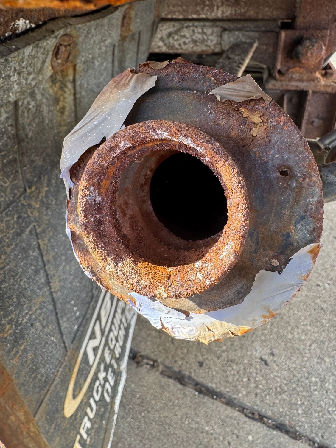

Well, this morning, I went out to put some diesel clean in the fuel and I noticed that I don’t have a gas cap!!!!
I wonder if some of these problems are because of that?
It’s pretty rusty, but I’m going to try to find something to fit.

Something that rusty would be in my trash can pretty quickly!

So I bought this truck on Friday from a local municipality. It definitely needs a new fuel filler neck.

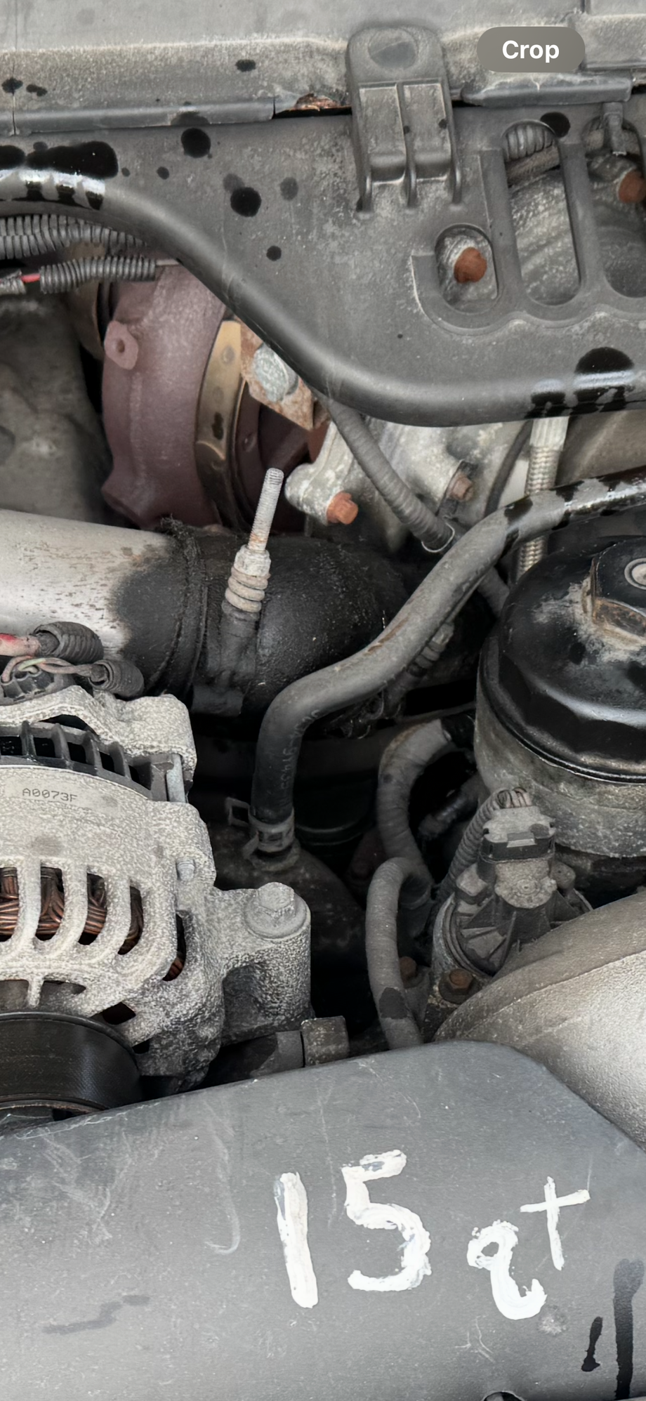

That picture of your CAC boot definitely shows that it has been leaking. That needs to be addressed (at least tighten clamps, maybe even new clamps and new boot).

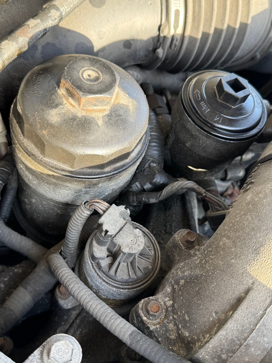

Also, is your EGR valve still installed in the truck? Is it plugged in?

yes, it has the EGR and it is plugged in.

Check out the EGR valve connector and wiring. The EGR code indicates a possible electrical issue with it (self test fault).

Then I would pull the EGR valve and makes sure it is clean and can be moved fairly freely. Then make sure it is in the closed position and then re-install it. Then I would leave it disconnected and take a drive to see if the boot and a closed EGR valve helped you noticeably. Clear the codes before the test drive. See what comes back.
