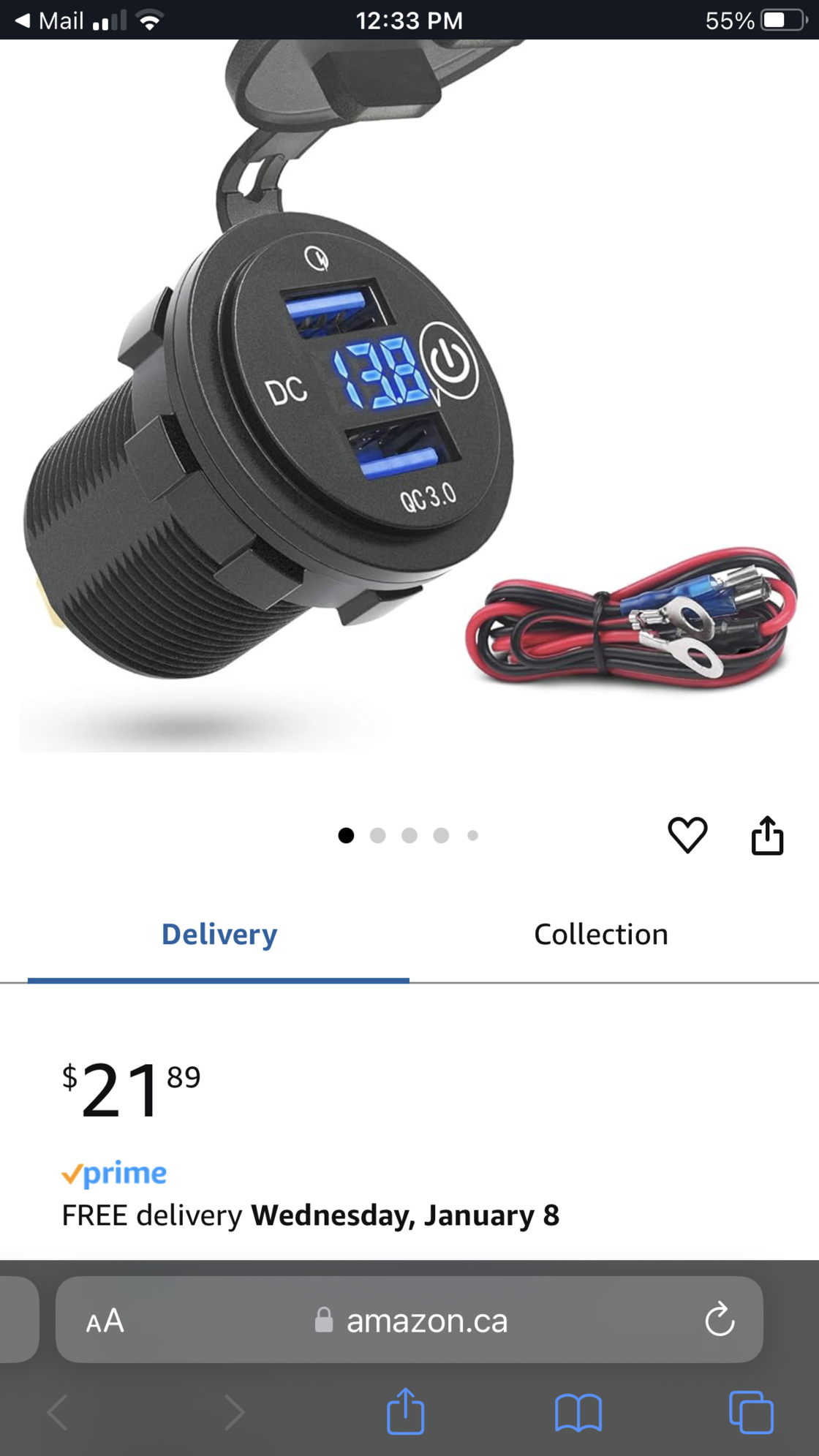

​​@F350towing I saw in another thread you shoed a voltmeter in your accessory port. Do you leave that in all of the time? My accessory port is live all of the time. Where did you get that voltmeter?

The voltmeter is also a dual USB charging port and is hard wired in.
I chose one with a power switch so I could turn it off when not in use to eliminate a power draw when the truck sits idle between trips.
Amazon Amazon
That is not the one installed in my truck, but it is the one installed in my Samurai.

Pretty interesting every brand and design of these are not available at this time from Amazon.
try Amazon Canada.

What about this?
Amazon Amazon
